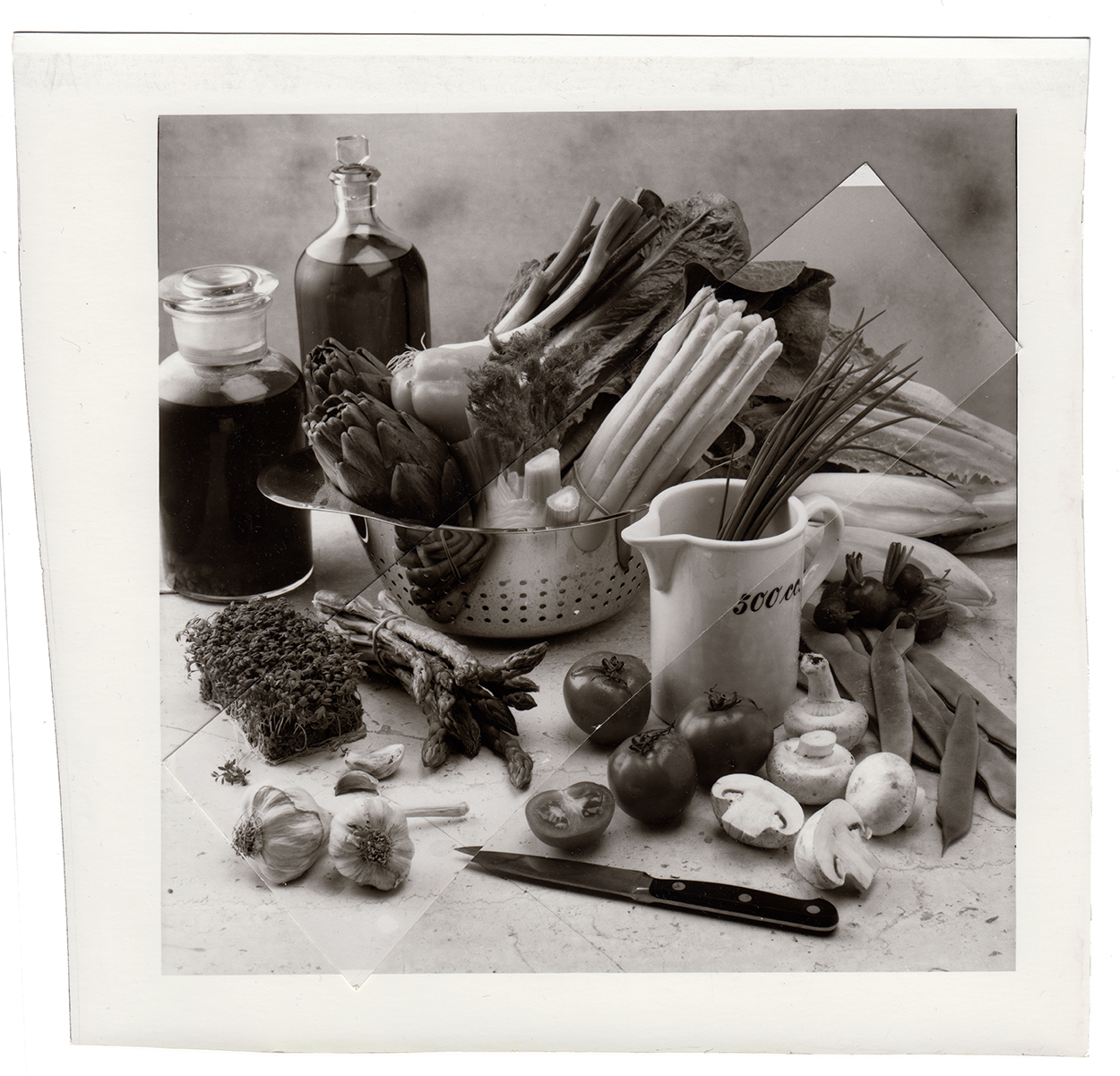

It won´t take this long. The photography (curves, tonality) is OK. We still have some minor coating issues but I am pretty certain that, unless the coater in Marly breaks down on us and causes a delay, we are rather talking months than years.
Check out the blog from now on or sign up for our newsletter.
Here´s our "famous" test image printed on the recent coating (which means ready to produce) paper.
The stripe in the middle is genuine PW from Forte. It is a tiny bit less sensitive than our PW II but all the rest is right on target. Exposed and developed identically. Grade 2, Neutol WA.
Don´t look at the dust- we don´t care for this in test images.
The white stripe on the top is the coating border as seen in the Youtube video about the first layer build up.
