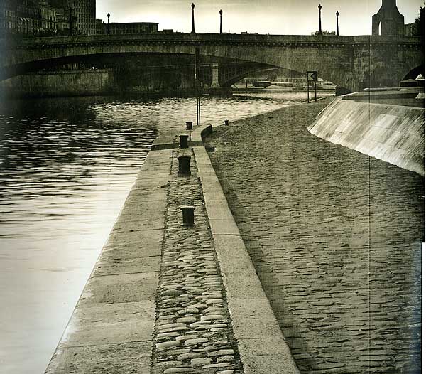

Black line about 1" in from the rhs. (ignore the developing fault).
John.

Hi John
If that is fotospeed, the new emulsion, I had the exact same problem on my last printing session. My client gave me negatives that were about 3stops over exposed to print . *actually a nice effect with lith, just pound through the negative and really nice effects*
I attributed the black lines to my clients bad neg , I had three that did not go all the length of the paper. Very sharp black lines just like yours.
I will see if I can get a jpeg to post of this image, *right now its up in a show*
Only about 6 sheets had this black line, I will also double check the neg to make sure it is only a wierd coincidence.
Bob

Hi Bob, that's interesting - yes you must be correct, it would have been fotospeed (sorry). I'd temporarily gone to fotospeed as Fortezo was out of stock here.
I remember the line was def in the paper, the sheet neg wasn't scratched and it was reversable in the print.
Those must have been some pretty long lith printing sessions for you. Actually I like the effect of under exposing and overdeveloping the paper - in some cases. But I haven't gone as far as to overexpose negs in anticipation!
Would be interesting to see the results you had.
Cheers John.
