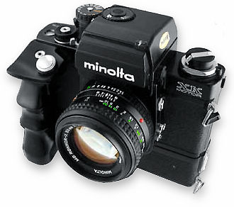

Yes, but it won't be compatible with Maxxum lenses. Minolta changed the mount when the introduced AF and anything "all manual" will be pre-AF.
The move to AF made made severed lens compatibility with all the previous models, including the coolest Minolta of all: the XK motor
