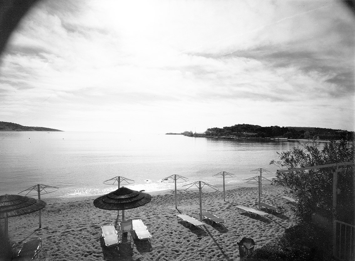

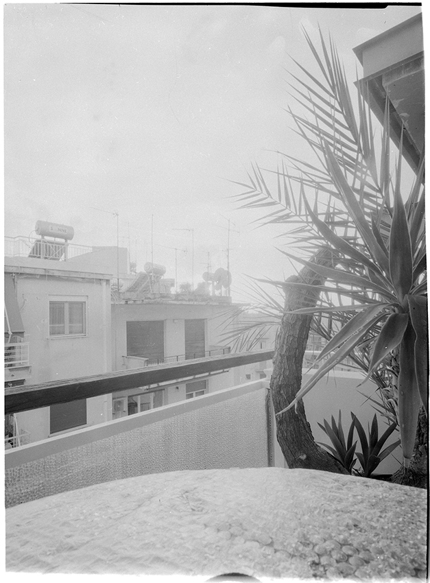

Just dev. my 1st. test sheet film of Retro 320.
R09 at 27c / 1-25 / 5min
the test was for Hyper-focus f/64 30cm to infinity.
well it came out very grainy !! the contrast is flat !!??
so If anyone has worked with this film !??????????????????
Hi joho,
I made a video recently: https://www.photrio.com/forum/threads/foma-retropan-320-soft.216564/
It's pretty flat in conventional developers. I've got a box of 4x5 that I'll be running through the ringer when I get back from my trip in the next couple of weeks. I'll be using a couple of developers to compare... D19 and Retropan Special Developer ( the recommended developer).

Hi, @Andrew O'Neill just had a look at your clip about 320. thanks.
it would seem as an orange-red filter a bit odd - any way, here is my 1st test & q-d scan look---
light is straight in to the setting sun with clouds - two different scans
