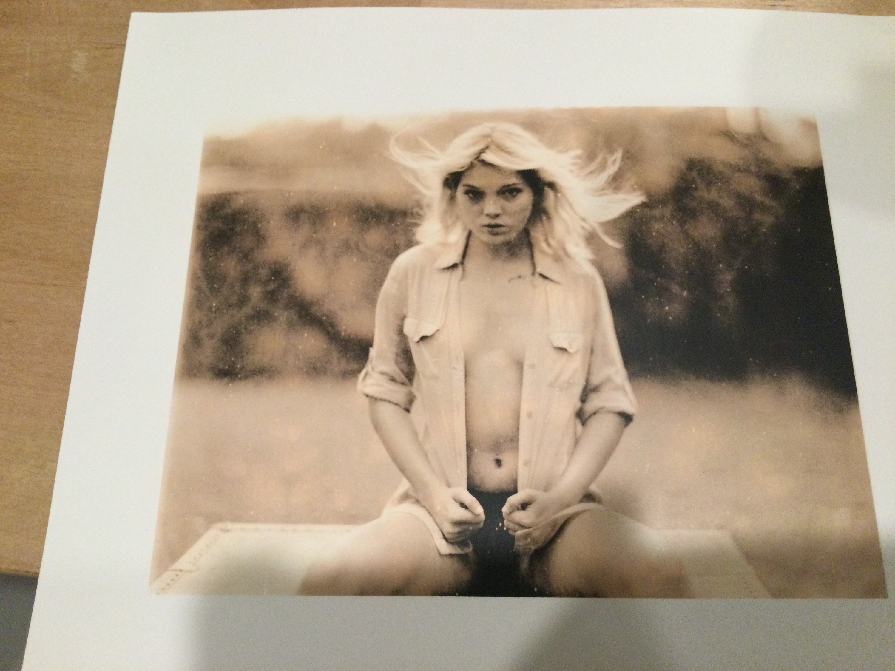

Can snowballs on a lith print present as white dots rather than cloudy looking white areas? I’m struggling with this white dot problem on all my fomatone tone papers. I thought it might be contamination from fixer so I cleaned everything really well to make sure it could not happen, and I still get the dots. I had a session last evening with some old Russian paper and I got zero dots causing me to think something is going on with my fomatone paper. The dots are in random locations not just in clear sky’s for example. Is anyone else having issues with current batches of fomatone?
I’m considering a quick soak in 3% hydrogen peroxide to see if that may help.
Thanks

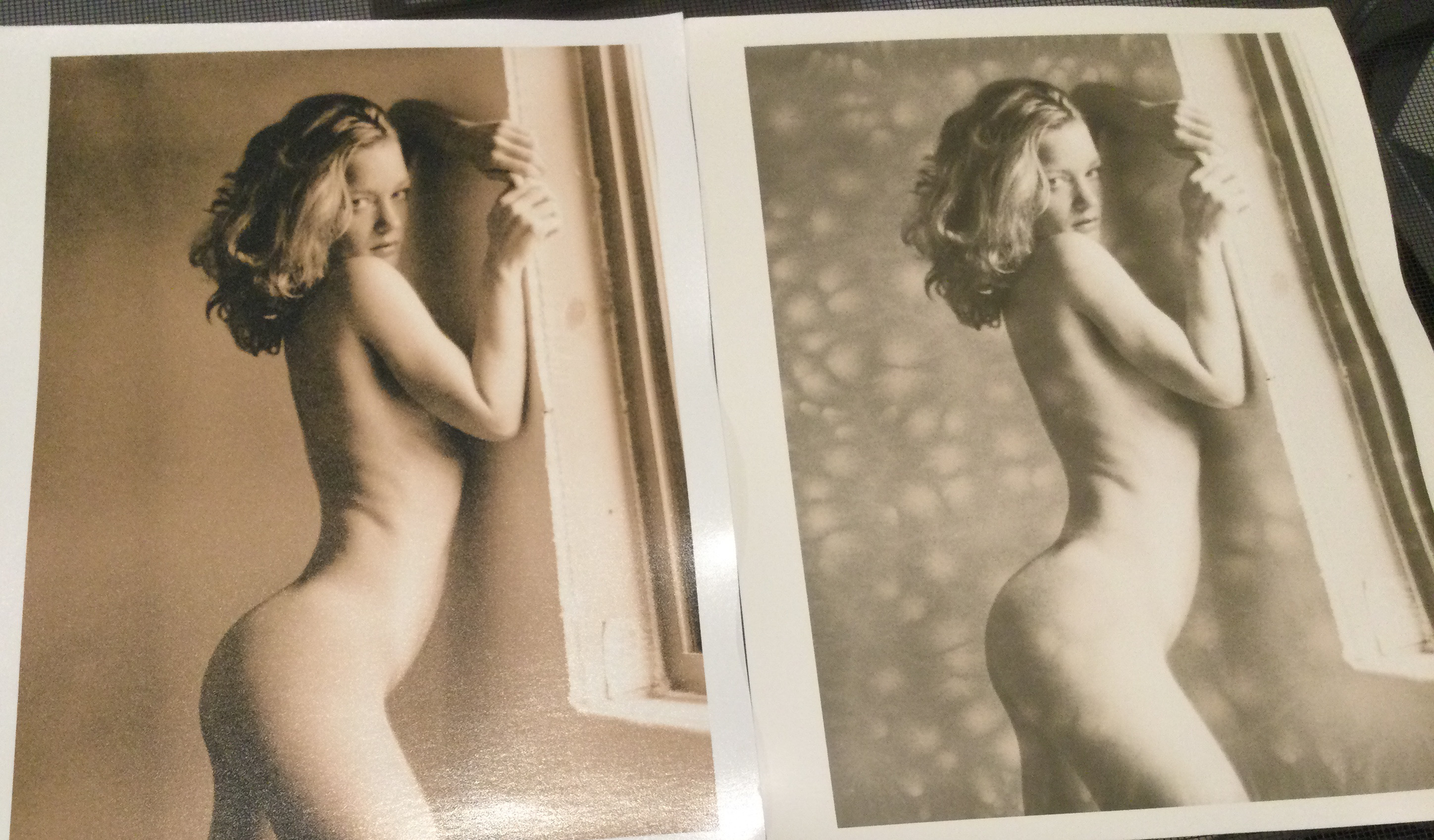

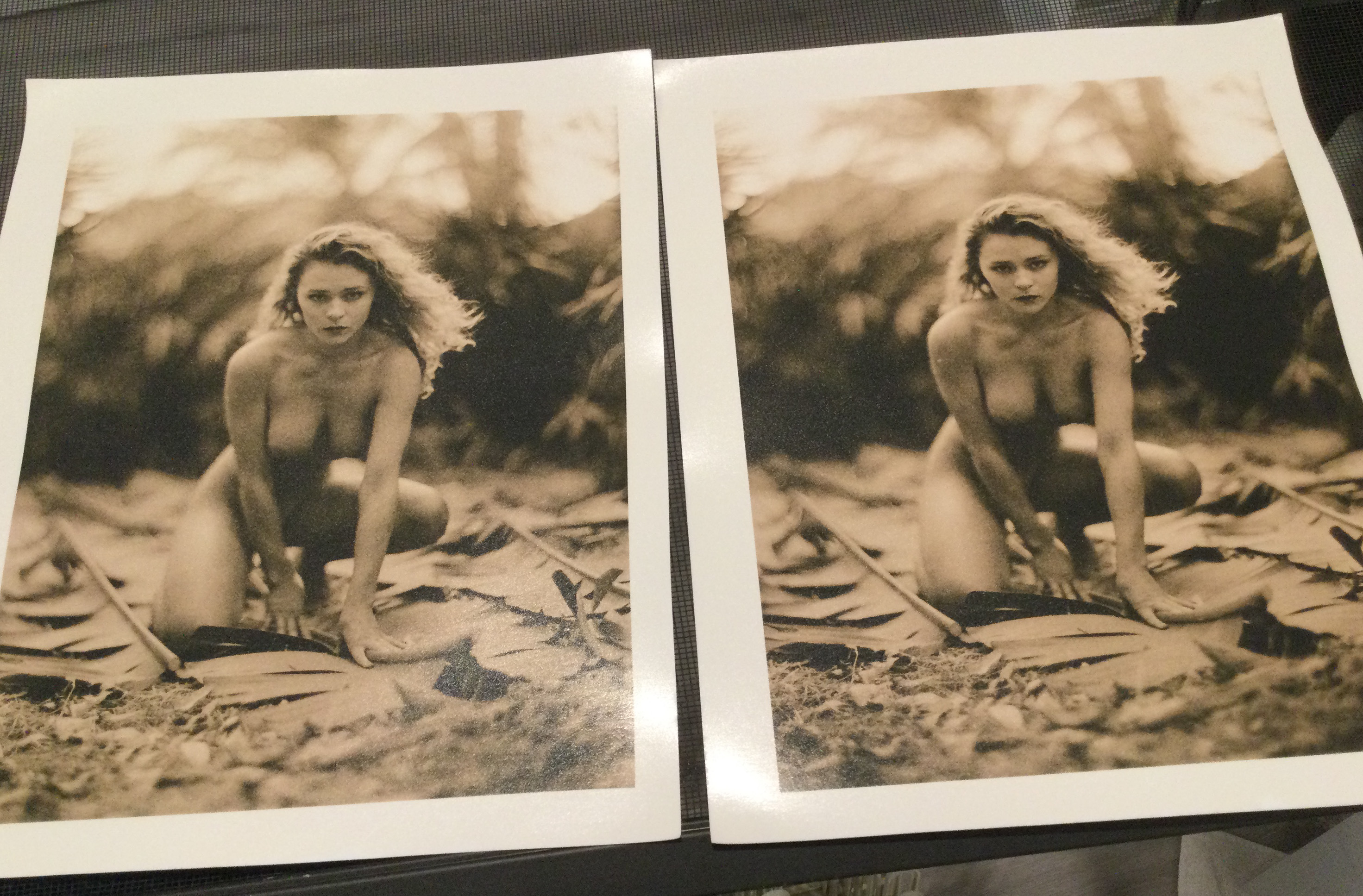

I finally got a new developer, Kodalith super rt, and it almost completely cured the white dot problem. First of all this developer is fantastic, I made about ten prints last night and pretty much all of them are good. I did replenish the dev once in the session but it didn’t exhaust anywhere near as quickly as any other dev I’ve used before. I’m getting a nice brown tone with it that I like. Interestingly the matt version of fomatone, 131 I think, was giving me snowballs and 133 not at all. You would think the emulsion would perform the same but it doesn’t. I would get snowballs with 131 then the very next print 133 and same exposure would not have them and would have much more color to boot. In addition the the white dots I have been getting straight lines that show up in some prints as of late with the arista I have been using. I still got faint evidence of that last night in one of the prints making me think that there is something wrong with my current boxes of fomatone, only the Kodalith developer copes with it way better. I probably got about 4-5 faint white dots last night which I can fix. With arista every print had 40-50 spots…
I did now where to begin with the dilution since the stock is a whopping 2 gallons, I was expecting 1:2 or 1:3 but I decided to try 1+1+12 first and it worked. Really fast actually. The developer was heated so that speeds things up also but the average dev time was 6 min. Next time I will try a more dilute mix and see what it does to the colors.42B44604-EC71-4597-B74E-C18FCE87BB74.jpegB726C1F9-F6BF-4074-8A2A-117467CA5F5F.jpeg

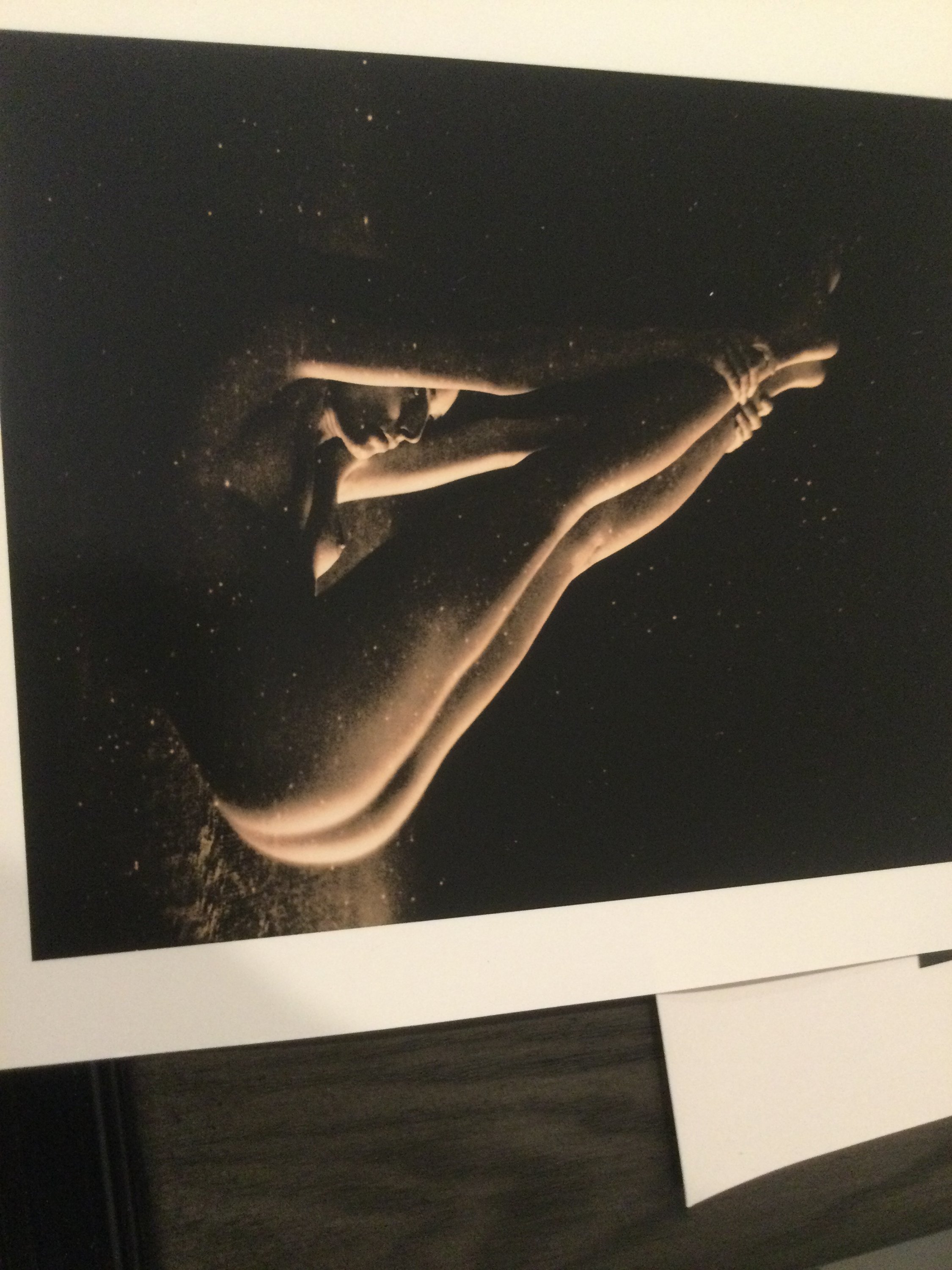

This photo shows what I’ve been getting with arista on fomatone…..
