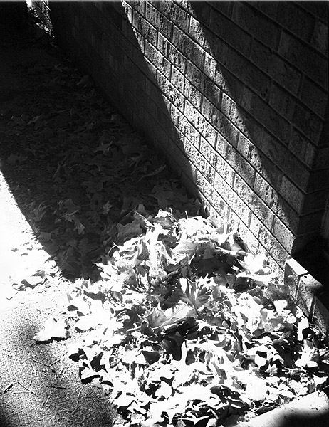

Daiichi Zenobia, .EDU Ultra 400, D-23 replenished stock (most likely 9:30 at 20C). I don't have a record of the exposure on this (I seldom record that information), but I'm pretty sure I did meter it due to the high brightness range.
So in that image, what was the shadow you likely metered on and then dialed back 2 stops? And is this a scan of a print or of the negative?
We may have different expectations of the degree of detail a shadow retains; hence the questions.
Apologies, not sure if it's my monitor, but are the completely burnt highlights in this example a consequence of strong overdevelopment or of artistic choices in post processing?
@albireo I take the burnt highlights as a digital artifact. Knowing how Fomapan 400 tends to handle highlights, there's no doubt in my mind it's easy to extract lots of information from them. It's really hard (probably impossible) to blow out highlights on this film. Trust me, I tried...
@koraks is correct -- plus, at the time I scanned that negative, I had a 1998 vintage scanner that could only record 8 bits per pixel in monochrome; I'm sure my current Epson V850 would do a better job both on dynamic range (16 bits per pixel) and resolution/sharpness.

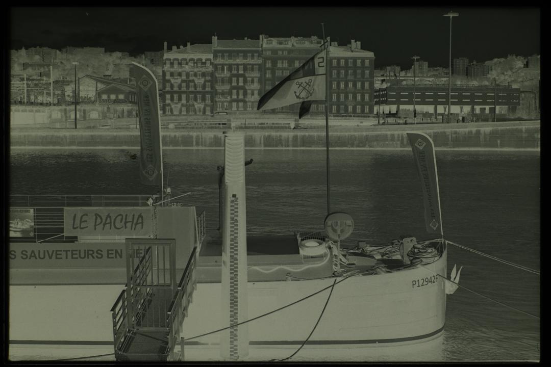

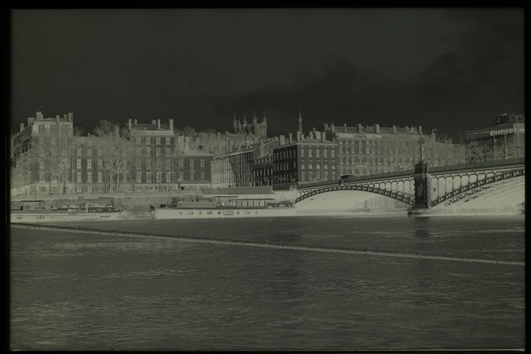

Thanks you all for the feedback and advice. For this first roll I went with EI 125 and a 12min development at 19°c (room temperature), standard agitation.
First day, overcast light, no real shadows :
The day after was better for this test with the sun out :
A few close-up shots (mirrorless digital camera on a tripod, extension tube, default jpeg) - first day :
Second day, more sun :
The last one was a fairly constrasty scene, and it's good to see details in both highlights and shadows on the negative. But overall they seem to be on the denser side .. overexposure, overdevelopement, both ? 11min (20°c equiv.) might be a bit too long, somewhere between that and @Animalcito 8:30 might be better.

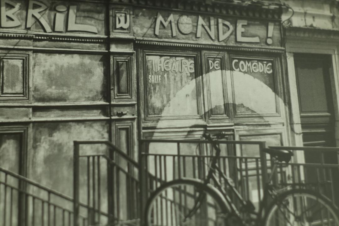

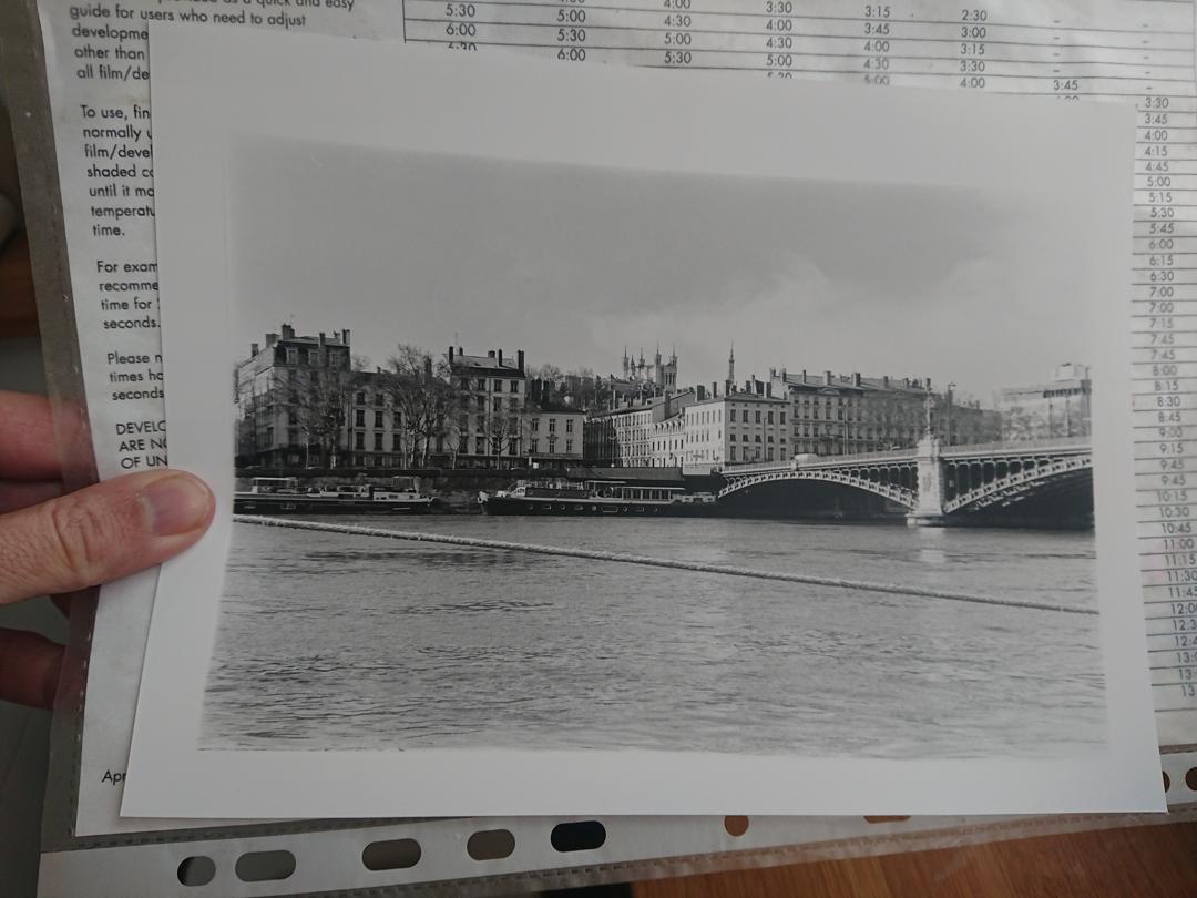

I did a print last night on fomapseed variant 312 18x24cm, using 60 Magenta which should be a grade 3 equivalent with this paper and my enlarger (Jobo c6600). I don't own a scanner so I did my best with a digital camera to take the following pictures.
Image on paper is sharp with visible grain (if you get very close ..) as you would expect from Rodinal. I like it, It reminds me of Ilford fp4+.
Negative looks like this :
I burned the sky a bit, rendering the grain in this high-density part more visible
Then, to compare, an other print from a fomapan 400 negative that was shot at EI 250 and developed in fomadon Excel stock. 90 magenta for this one :
Take all theses pictures with a grain of salt as digital noise is there alongside the grain, but it looks a bit smoother (as you would expect from a XTOL clone).
