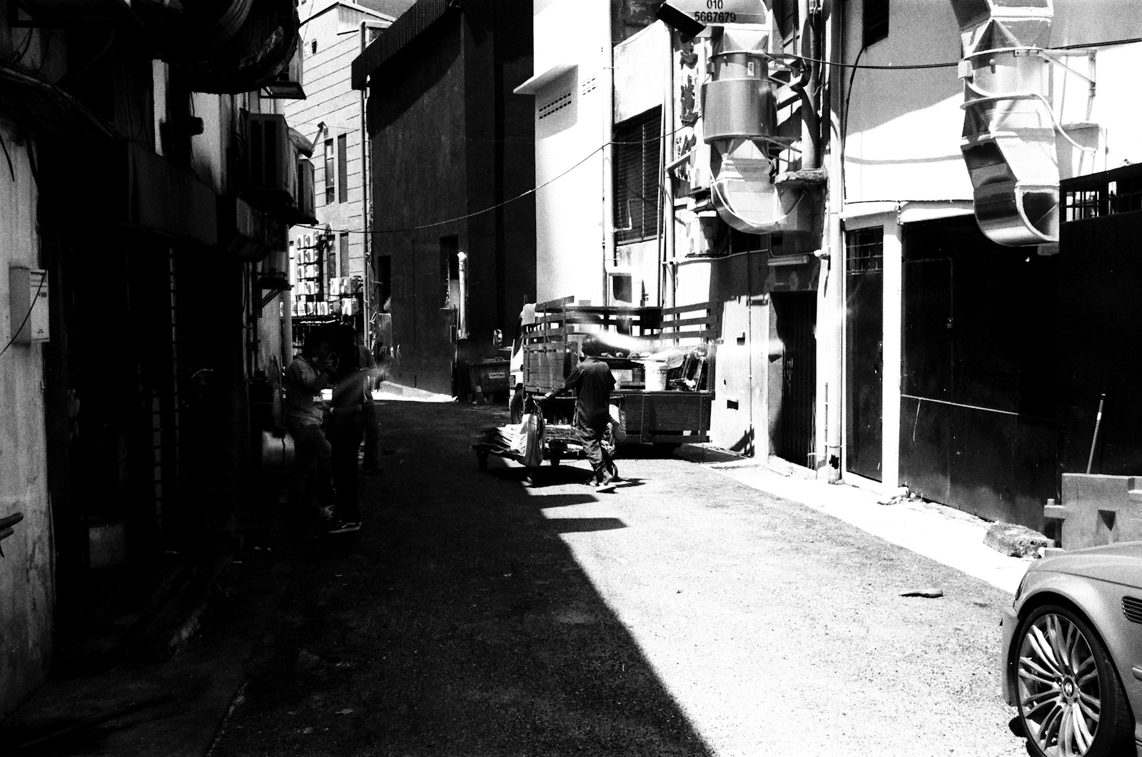

Hello
Im newbie here. I hope this is a correct thread to be discuss and getting comment
I developed my film fomapan 200 , using ilford id11 and fixer . The developed timing was 6 minute, than drop out the chemical ID11 and rinse with plain water , drop out the water , and drop in fixer for 3 minute 30 second .
Im not sure this is good or not , some one said the grey area looks bad . Im not sure wether my process is wrong or what ?
Anyone can help me or guide me for better result ..

Hi @angah316 thanks for joining us and yes, it sure is fine to post here with questions you may have!
The print or scan looks like a very high contrast scene, and those are often challenging to get right. Problems we frequently run into with this kind of image is insufficient exposure so that the shadows end up being all black. Or on the other hand, if the shadows are exposed properly, the negative can turn out to have so much contrast that it is difficult to print or scan. In extreme cases, the highlights may even 'block up' in the negative, at which point they contain very little detail.
In this particular case, the issue is most likely insufficient exposure. The dark area on the left contains little detail, at least in the image shown here. It might help to post a photograph of the actual negative, held against a diffuse light, so that it is possible to see how much detail there is in the negative itself. This can help in providing you with further assistance.
Finally, keep in mind that whether a photograph is good or not, is primarily up to you to decide! In the end, it does not really matter what others think of it. You be your own judge :smile:

It seems overly contrasty for such a short time in the developer... What was the developer temperature? I'd shoot the film at 100 instead of ISO 200, and use ID-11 diluted 1+1. You'll have to experiment with time.

Temperature of developer is room temperature . Yup i didnt heat it ..usually once it used, i will drop out the chemical into the bottle.
Hold on , do i need to heat up the developer to certain temperature?

Temperature is important. Depending on the developer, I usually keep the temperature at 20C. If you use higher temperature, then the time must be reduced. Lower temperature, then time is increased... You say you used "room temperature", but what temperature is that?

Hi @angah316 You didn't say what dilution of the developer you used or what the developer temperature was. Foma 200 can build up contrast quite rapidly if overdeveloped.
I have had success using D-76, (Kodak equivalent of ID-11), diluted 1+1 for 5.5 minutes at 24 degrees C. (Summer water temps in Sydney are well over 20 C). I suspect that your local temps are over 20 C. This time based on 9 minutes at 20 C from the Massive Development Chart and adjusted down according to the charts from the Ilford web site.

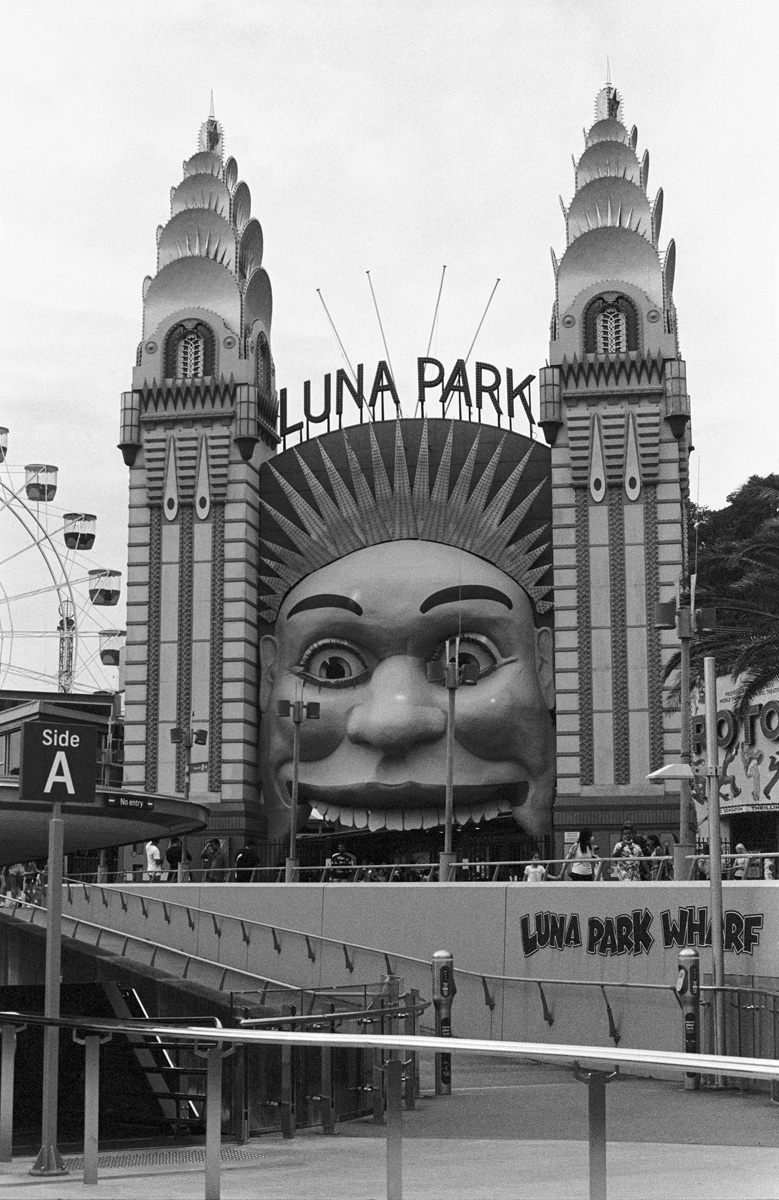

The attached picture was taken late afternoon in the Australian summer, exposed at ISO 200 on a bright day. The shadows in your picture may need a bit more exposure and I think you may have overdeveloped the film. Need to know what temps and dilution of ID-11 you used.

angah316 To a certain extent we should blame any instructions that you may have on film developing that simply say room temperature without stating what that means. As Andrew says it is 20 degrees C I can imagine that room temperature in Kiang may be something quite different to room temperature in a temperate climate such as the U.K.
So was the developer at 20 degrees C and if not what was your room temperature? Are you scanning the negative to make a positive print? If you are then the scanner's software may help to lower contrast.
As has been said it looks as if there isn't enough detail in the shadow area in the street scene so next time try increasing exposure by lowering the film speed on the film speed dial when taking outdoor scenes with deep shadows and bright highlights
The second shot of the workshop is not a high contrast scene and that looks much better but still the shadow areas don't have enough detail
I'm not sure how much Fomapan 200 you've shot, so maybe I'm telling you something you already know. But Fomapan 200, other than e.g. 100 and especially 400, develops 'crazy fast'.
I also think that the apparently high contrast is more a matter of scene selection, exposure (favoring highlights at the expense of shadows) and post processing/presentation than inherent contrast in the negative. But this is one of the reasons why I proposed to have a look at the actual film, because it will tell us a little more.

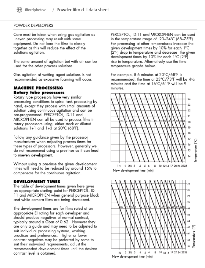

For clarity, you can deal with developing at a range of temperatures, provided that you adjust the developing time appropriately.
Between 18C and 24C you can usually get good results, although sometimes 24C results in times that are too short for consistent results.
You do need to measure the temperature reasonably accurately, so a decent thermometer is important.
Ilford has a chart to help you with this.
It is included in the datasheet that applies to all Ilford film developers, which can be found here: https://www.ilfordphoto.com/amfile/file/download/file/1829/product/708/
It is on page 4 of that datasheet, and it looks like this:
It is advisable to make sure that the other solutions in the development chain are at or near the same temperature as the developer. That includes the wash.

Yesterday i checked, it was 32degrees .. (stock developer)
No wonder its look too contrast

When I lived in Florida my tap water was never lower than 27C. I had to learn to reduce development time to compensate. If you can reduce temperatures of all of your solutions, that would be simpler. Some films have problems if they are developed at one temperature and stop bath and fixer are at significantly higher temperatures.

You need to think of a way to lower the temperature. Fomapan is a bit of a strange film - maybe a mix of old and new technology, I don't know.
There are two important facts:
- the specified speed of the box as ISO 200 for many people does not meet their expectations. Shot at EI 200, this film looks slightly pushed.
- development times are significantly lower. It is important. Fomapan claims the following:
Creative has a nominal speed rating of ISO 200/24o, but due to its wide exposure latitude the film gives good results even when being overexposed by 1 EV (exposure value) (as ISO 100/21o) or underexposed by 2 EV (as ISO 800/30o) without any change in processing, i.e. without lengthening the development time or increasing the temperature of the developer used.
The lower development times give Fomapan reason to specify high ISO values, but it might be a good idea to shoot it as EI 100-125.
Your "room" temperature is too high - 32C, and at the same time you developed with ID-11 for 6 min. Fomapan says it should develop for 5-6 min at 20C or only 2:30 min at 30C. In your case, I would even expect a worse result than what you achieved. Obviously, there is no option to compensate the temperature with time, even at 30C the situation is unpleasant. You can dilute the developer, but it still won't be a solution. You just have to find a way to control the temperature and keep in mind the quirks of this film.
A lot of people don't like this movie, but actually their bad impressions are the result of not understanding the specifics. If you learn to shoot and process it properly, you would get good results. At a very good price.

First of all, I want to say that I like your composition shots. Simple moments and scenes, but they have everything and perspective and balanced details. YES the picture has high contrast. Based on experience, I dare to assume that the temperature of the solution was really high and the negative turned out to be too "dense". There are still glare, what camera did you shoot with?
