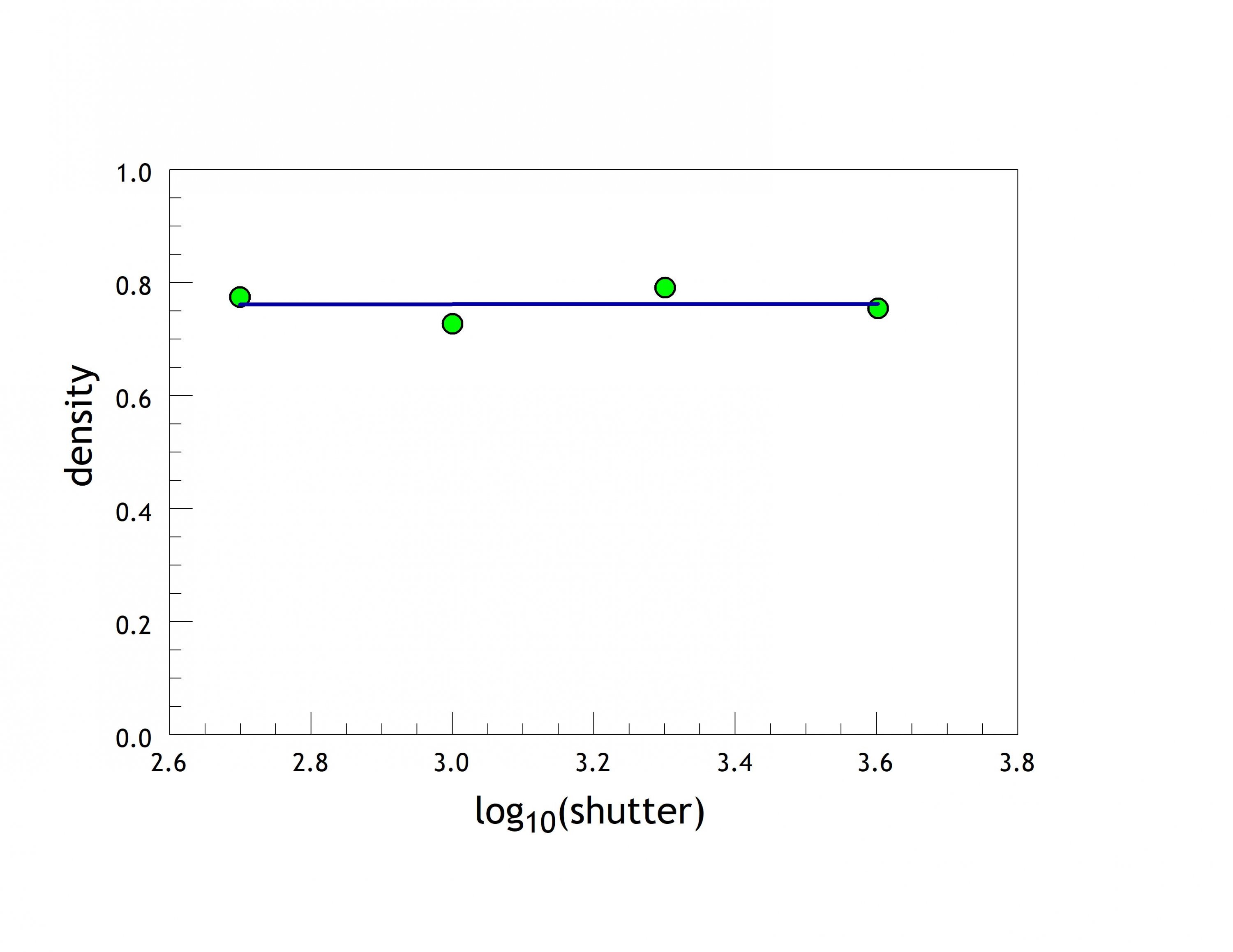

I decided to check the short-exposure end of the reciprocity scale for Fomapan 200. I found an evenly illuminated object (sky on an overcast sky) and photographed it at shutter speeds 500, 1000, 2000, and 4000. The aperture was adjusted by so each frame had the same (midrange) exposure. The idea here was to see if there was reciprocity failure in this range. It was not to try to find adjustment factors to correct for reciprocity failure. Of course, adjustment would not be necessary if it were to turn out that there was no reciprocity failure
Here are the results in the form of a plot. The x-axis is the logarithm (base 10) of the shutter speed. The y-axis is density.
The left-most point in the plot is for 1/500 seconds (plotted as log(500)). The right hand point is is for 1/4000 seconds (plotted as log(4000)). I used the logarithm to linearize the x-axis to make evenly-spaced points.
As you can see, for a midrange tone there is no hint of reciprocity failure even at shutter speeds of 1/4000 second.. From the way reciprocity works, this says nothing about the highlights under high illumination (and consequently short shutter speed), one way or the other, but it does mean that there is no reciprocity failure for the shadows and mid-tones.
This is interesting because reciprocity at low image brightness (long shutter speeds) is rather bad for Fomapan 200, but it is really good for high image brightness (short shutter speeds).
