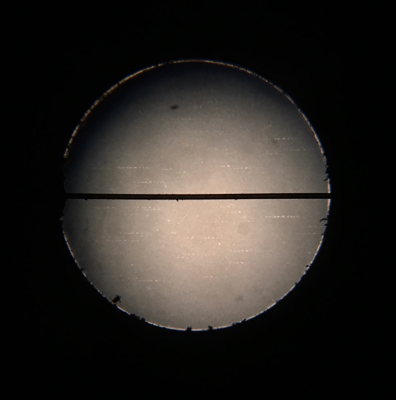

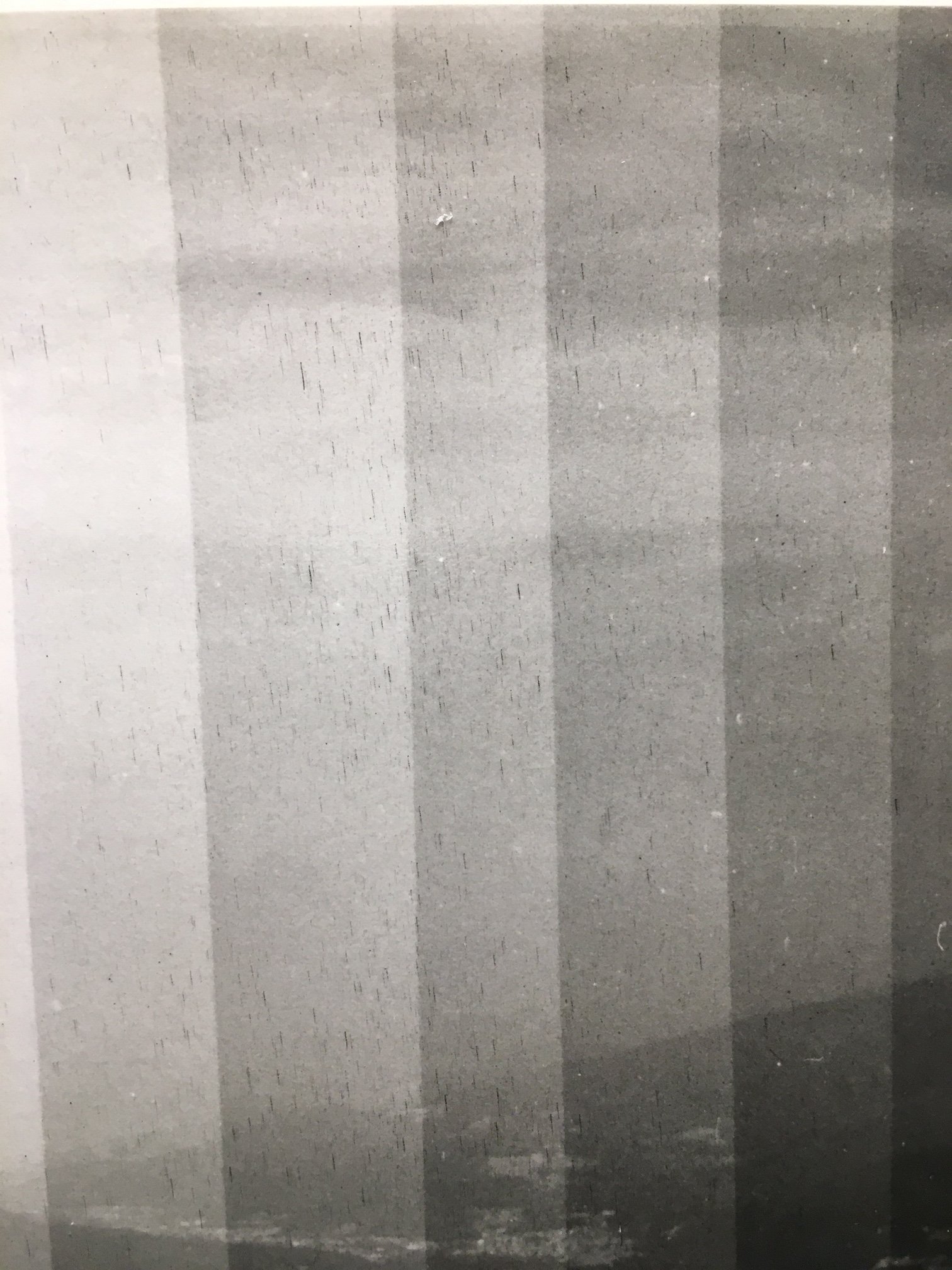

i am getting this from time to time and cannot understand, is it my problem or a foma quality issue?
please look through my my loupe, the little strokes in the monochrome background is not rain, i assure you :wink:
processed in rodinal 1+50 in paterson tank (swirl), light stopbath and water rinse, alkaline fixer, wash, final wash in demineralised water, no flow no squegee no fingers no swearing..

Several years ago a artefact at Foma rollfilm was reported that we considerd to be caused by abrasion/stress by the backing paper surface.

If this is the 120 format film: yes, it's a well known issue. I've had it as well and have since refrained from using this film in 120. It's great in 4x5 and probably 135 as well.

I don't think it can be a backing paper issue as for the past year or so they seem to be using the same backing paper as Ilford/Kodak, the older slighter rogher paper has gone, at least on both the 200 and 400 that I use all the time,at least over here
yes, its 120.
never had this in 5x7.
sad..
love this film

I regularly shoot fresh Foma 200 in 120 format and have not encountered this issue. Would you be able to share the batch number in case the problem has to do with specific batches?

Get in touch with Foma. Send them your picture.
That's what I did back when I ran into this issue. They requested the physical negatives exhibiting the problem, which I sent them. After a while they kindly informed me that the problem was indeed in the film. They replaced the film I had purchased at no cost. It exhibited the exact same problems. That's when I gave up on this film in 120, but I still like it in 4x5.

I gave up on Foma film due to repeatedly encountering zits and cracks in the emulsion. But I was shooting it in 8x10 sheets, where duplicate exposures are unrealistic. It's cheaper just to buy a more expensive film you can count on. I like the fact that Foma 200 is the last so-called straight-line film on the market, which does yield superb deep shadow separation. But it's nowhere near real 200 speed, has miserable reciprocity characteristics, plus lots of quality control issues. I expect my medium format films to be reliable too, and can't gamble on anything questionable. Paper issues are more forgiving because you have a chance to reprint them.

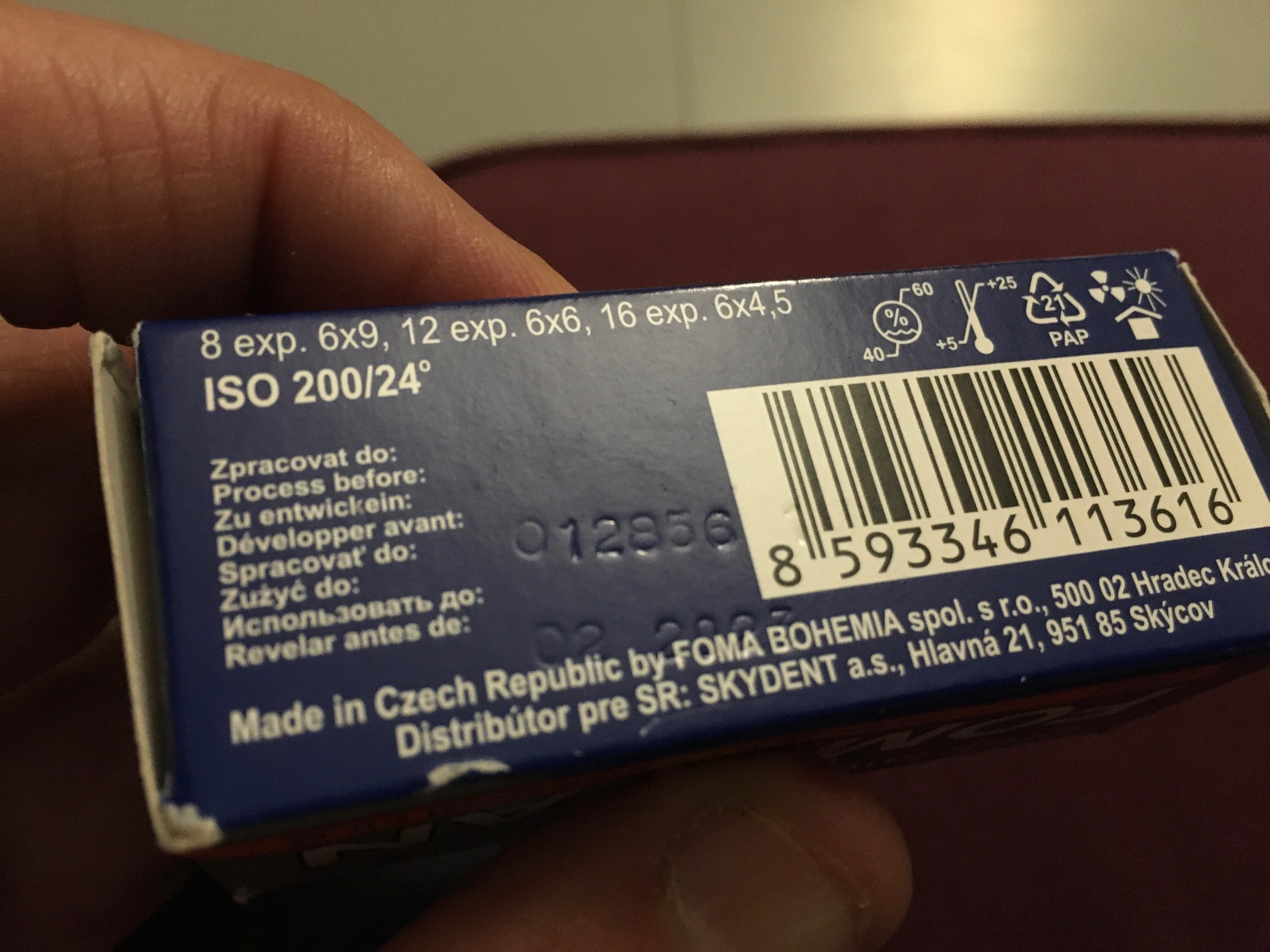

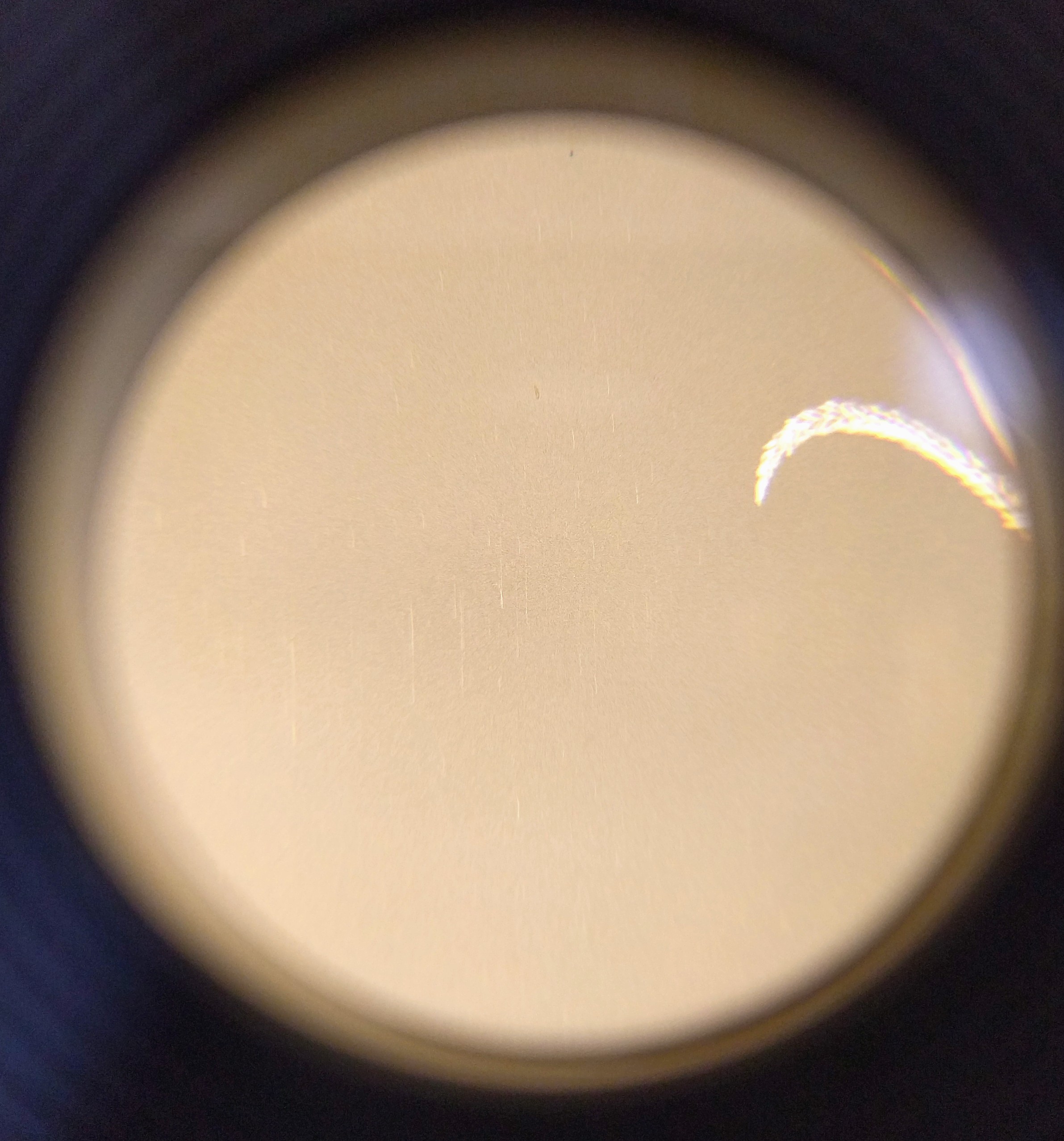

After some rolls without issues I had the same problem with #012856 batch. Replaced for free by Foma (good) but it's still a problem.

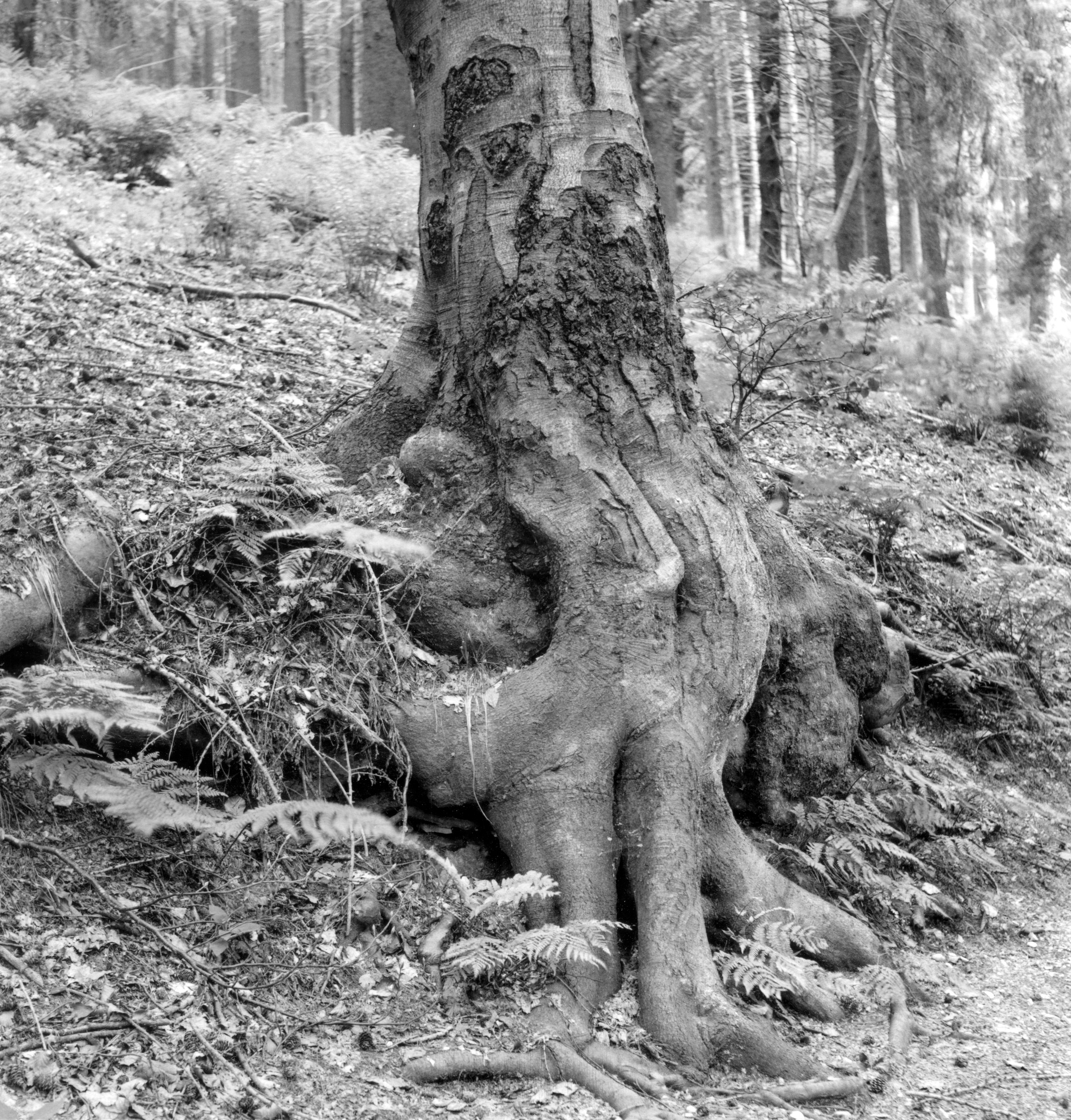

Yeah, it's unfortunately just not a feasible option in 120 format. I didn't have problems with it in 4x5 (but haven't used it much). I may give it a go in 135 one day.
It's a pity because I do consider Fomapan 200/120 a great film, with an extended greyscale in the shadows and a reasonable price.
