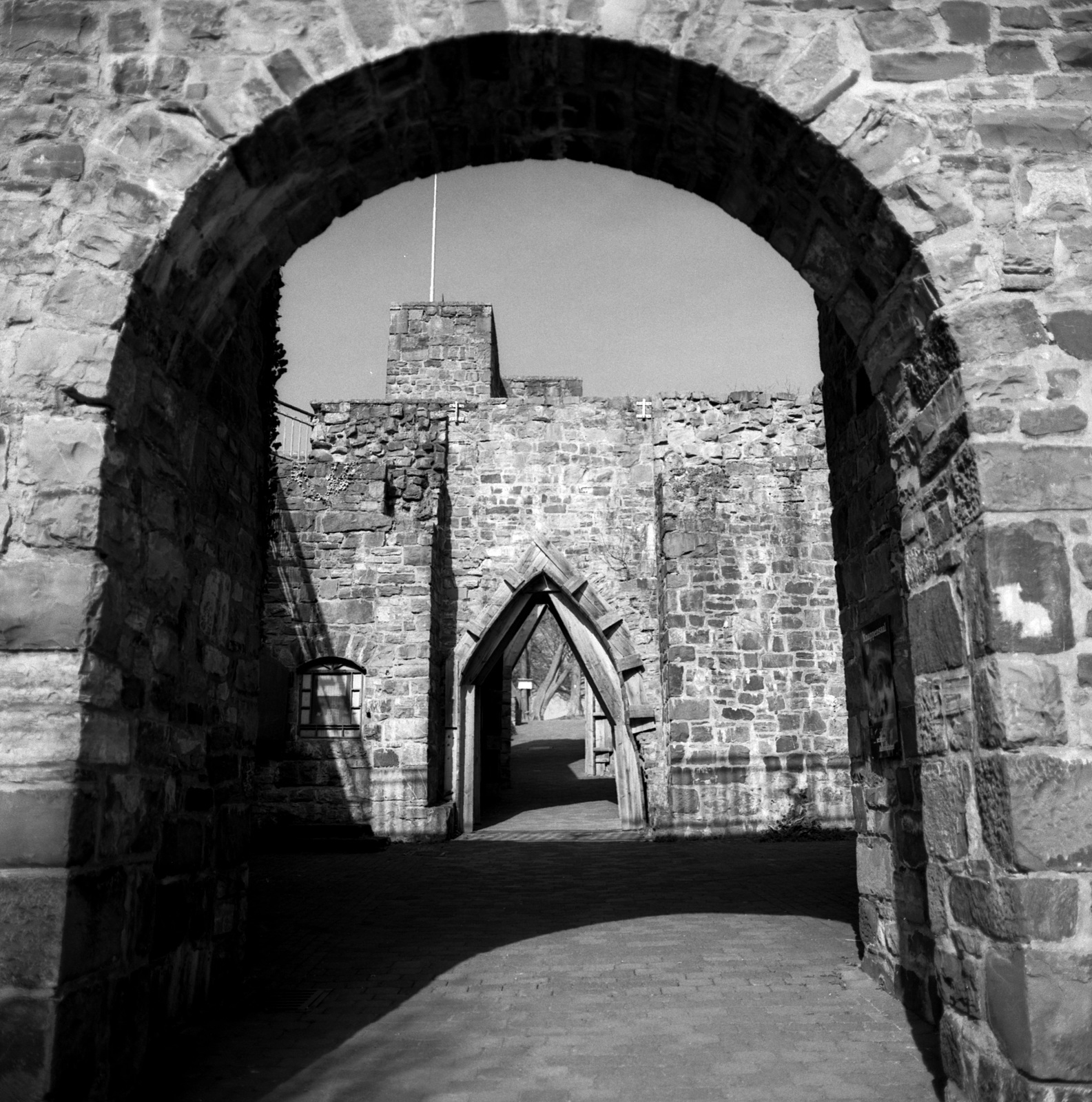

Zenza Bronica SQ-A
Zenzanon-S 3,5/50 mm
Fomapan 100, ISO 100 (Exp. 06/2025)
Adox XT-3, 1+2, 16 Min
Canoscan 8800F, Vuescan

May I ask why you’re intentionally overdeveloping the film? Is there any specific reason?
I develop films for a condenser enlarger, so fairly low contrast is my goal.
Adox XT-3 is similar to X-Tol?
Yes, XT-3 is a Xtol clone. I have a Durst M605 with color head which needs more contrast. However, the negatives scanned very well, too. They do not look overdeveloped at all.
Anyway, the developing times from the Foma datasheets resulted in too thin negatives due to my experience.
