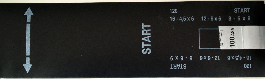

I actually just picked up some Fomapan, so I thought I would load it into my C330s to see. I agree - it is very confusing not having arrows, but it seems to me that you aligned things properly. I guess we will both find out...

The answer would/should be "yes" After you close the back and wind-on you'll prossibly feel the extra bit of resistance as the lump of film, sticky tape and backing paper slip under the edge of the pressure plate.

This is the backing paper of Foma 120 film that I have recently developed. There are arrows after the start.
