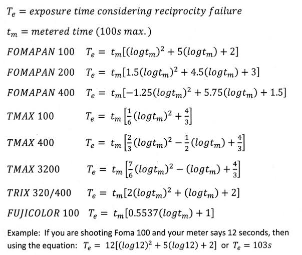

I use these formulae to make correction tables for Foma films, and they've been very accurate for for pinhole photographs. All credit goes to whoever worked these out. (i've never used these for the non-Foma films listed, so I can't vouch for their accuracy.)
