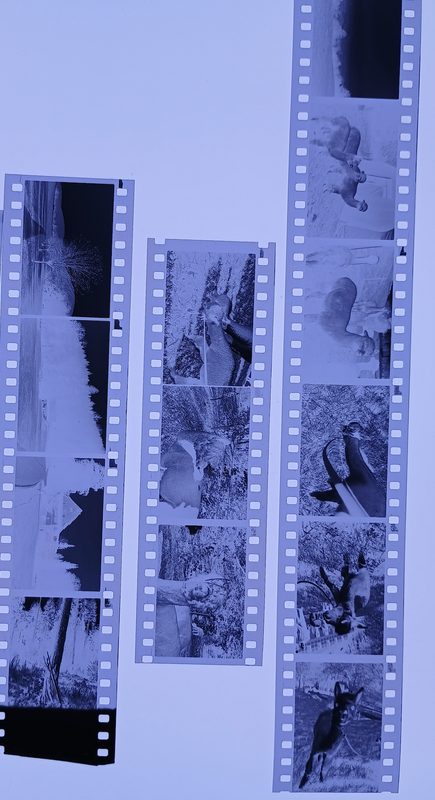

I attached some “mugshots” of my negs to my post.

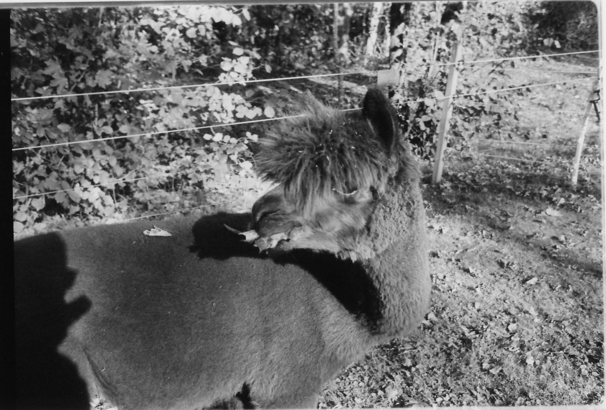

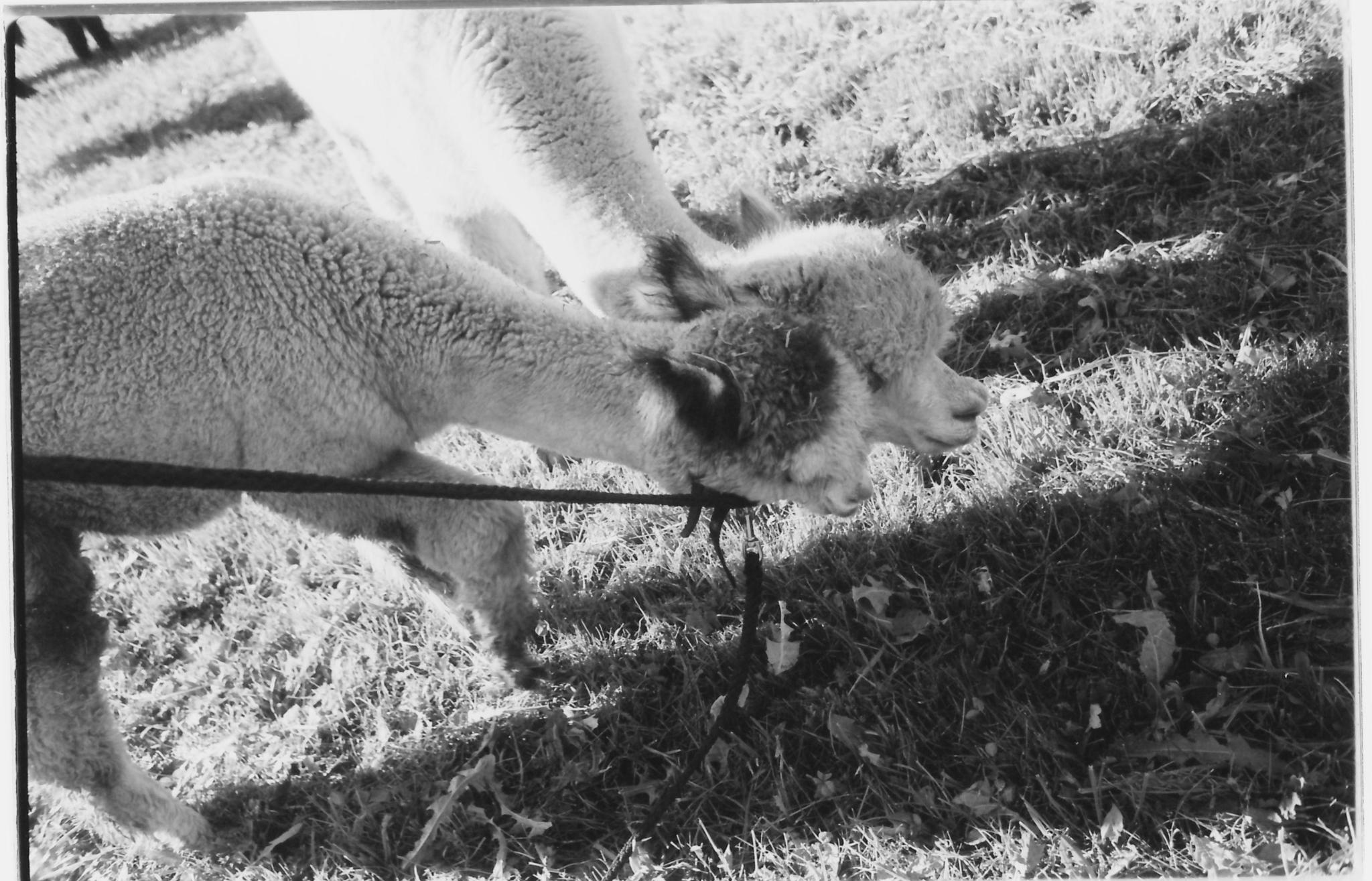

At the moment I do not have the time for wet printing – I scanned the negs with a “gifted” Canoscan 5600F (came without negative holders so I’m still in the process of improvising to get sharp scans out of it). Scans look good from my point of view.
Has anyone some experiences with Fomapan 100 in FX-55? Is my development time to excessive?

It's always hard to judge scans, but the film looks underexposed and overdeveloped to me. So yes, I think you developed too long, or maybe made a mixing error when preparing the developer.

To clarify: The image attached is not a scan - its a photo taken from my lighttable.
I included some scans. Sorry for the "unsharpness" - this will be fixed once i figured out the right scanning distance

At least on the scans, the highlights appear to be all blown out. Going by how the negatives look, they're really dense. You could probably eek some differentiation out of those highlights, but knowing what fomapan 100 does at high densities, you'll end up with a flat, muddy, grainy mess.
I'd really recommend increasing exposure by a stop (expose at 50 or so) and cutting back development quite significantly. This film is capable of producing quite fine results, but when it's underexposed and overdeveloped, it tends to get very harsh, and not in a good way.

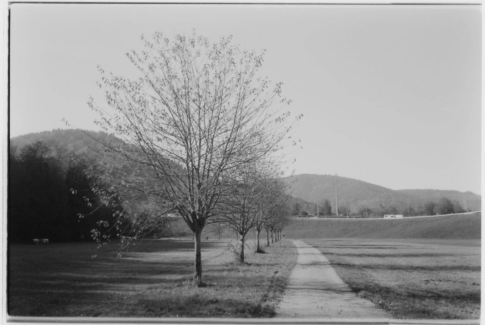

Thank you all for your knowledge and your support – it helped me a lot.
I eliminated the faulty camera out of the equation and took my AV-1 with a fresh battery for a test-drive.
I reduced the development time to 11 minutes in FX-55 at 20°C (took the middle road).
I’m quite happy with the negatives at ISO 100 – the scanning part does need some improvements.
Edit: I stepped up ISO 25 - 50 - 100

Those negatives are significantly overdeveloped if the purpose is scanning. Some of them appear to be underexposed, too, which is also going to result in poor scans.
Exposure and development issues can't be fixed post-scanning if you are after excellent results.

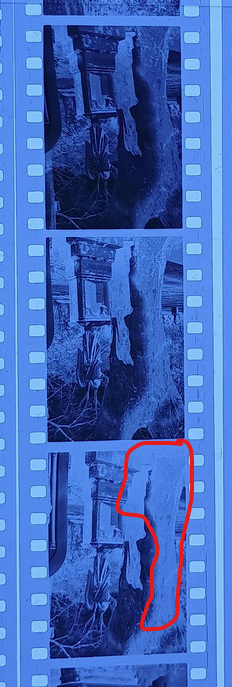

So you've now been able to determine that the time of 11 minutes is still far too long. Please see post #13 and try something like 8 minutes next time for EI=100.
Note also that your EI=100 negatives show significant underexposure of shadow areas. See e.g. here:
Note how there's very little detail in the tree trunk and no detail in the passage between the grave marker and the tree. In your EI=50 shot you have printable density in that area. Your other shots show a similar pattern. As pointed out earlier, 50 or so gives better results. You could further cut back the development time to ca. 6 minutes if you expose at 50. Your negatives will be softer and you'll have more possibilities for deciding where you want to take the final scanned image or enlarged print.
TL;DR: useful experiment that still shows underexposure + overdevelopment for EI=100.
