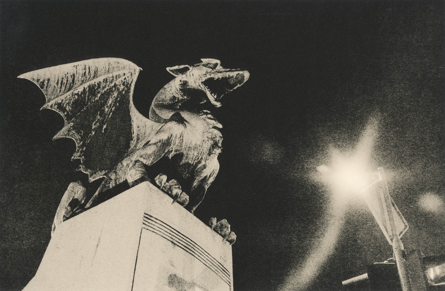

I only found out Variant 123 worked with lith about a year ago and since have done quite a bit with it. Last bought some three months ago and seems to work fine and as you describe, no 'crazy colors but a nice gritty look.' Never got anything worth keeping on other Variant surfaces. So, batches in the UK seem fine though always a big problem trying to get the same lith look on papers from different years. Attached is a print done a few months ago on 123. Is this the look you are talking about?

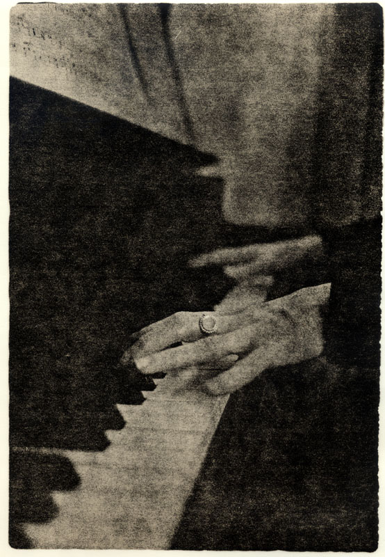

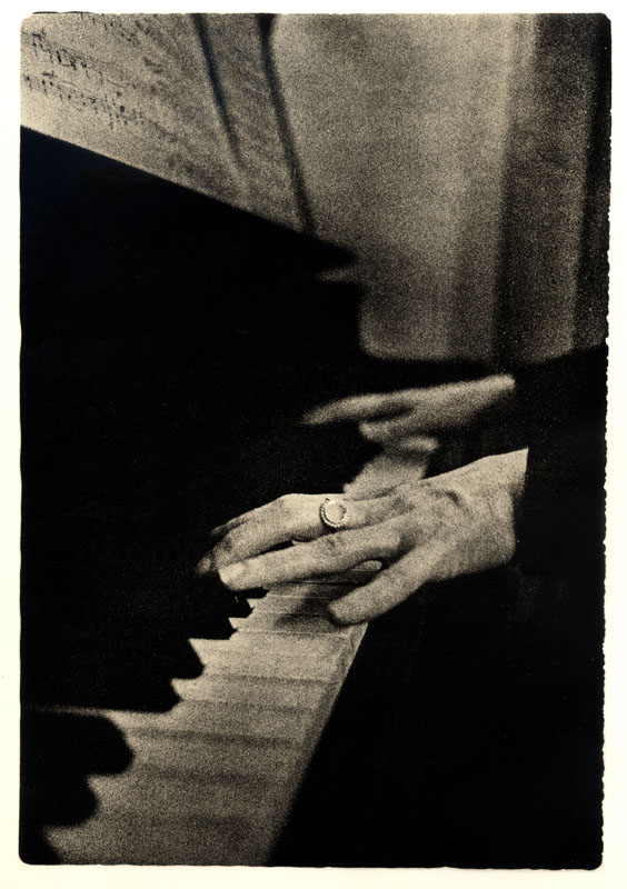

Scans, old emulsion and then new:

My first thought when I look at that paper and the difference between the two is that for example it almost looks like you dodged a lot in the center with one, and did not with the other, the exposures are just way different and the blocks are obviously not fully burned in, but I don't understand with printing so I don't know if you do it similarly to traditional darkroom printing or not. But my first thought is just that you didn't do the dodging that you did for the first image, and so you didn't expose the image long enough in the blacks to make them go fully dark, it also looks like you didn't possibly spend enough time developing the image sometimes when you don't develop long enough the blacks don't fully come in?
Again I am completely novice, just sharing some thoughts based on my first initial impression. And I have used paper and I found it amazing for regular darkroom printing. The surface texture is very unique, so I can see it being useful for other alternative printing methods.

Well, lith printing is very different from regular printing. Both of these were dodged with the same mask though.
You generally snatch a lith print from the developer when the highlights are where you want them. You never develop lith to completion, as it's two to five stops over exposed. I definitely know how to process a print to completion in liquidol or dektol, it's not something that applies here though. I've never used developing time to adjust print density with standard processes, though maybe some have... I use a timer and base developing time on paper specs and tests. Maybe in 2-bath developing time can be an issue, but that wouldn't suit this neg anyway. So not sure what you're seeing here, though dodging for the lith prints was very helpful and I had 2 different soft masks in play. Thus the spray of white grain between the two hands where it should be a deeper black (but that should spot out if I can sit still long enough!) - this being a 35mm neg, I didn't mess with a registered mask for selective dodging.
Both prints have roughly similar highlights (I'm looking at the fingers), but the newer paper, the black didn't come up until the fingers were shot. And there's a real messiness to the overall rendering. Scratching my head, but I think there are foma papers considered better for lith - the only papers I had that would lith were purchased specifically for bromoil. But then again, my older stock - considering what a tough neg this is - made prints I really liked, all things considered.

I think Mike C is correct. To my eyes, it the second one looks like it has lower contrast meaning that you need less exposure (old paper was a little slower, perhaps?) Also, it looks like you left the first one in the developer a bit longer looking at the blacks. Honestly, I think you simply nailed the first one hitting the exposure and development perfectly....it isn't always easy to repeat with lith.
Nope, I got 3 or 4 similar prints with the older emulsion batch. It was actually pretty repeatable (for lith) though I didn't track snatch times, and I replenished with maybe another 75A/75B (to 2 liters) in the midst of those.
With the newer emulsion, I went with my exposure notes from the good prints (I keep a white board by the enlarger and can track the progress of a print session by letter-coding test prints and noting times, filters, dodge maps, etc - I can track the "evolution" of a print very easily), tried different exposures, etc.
