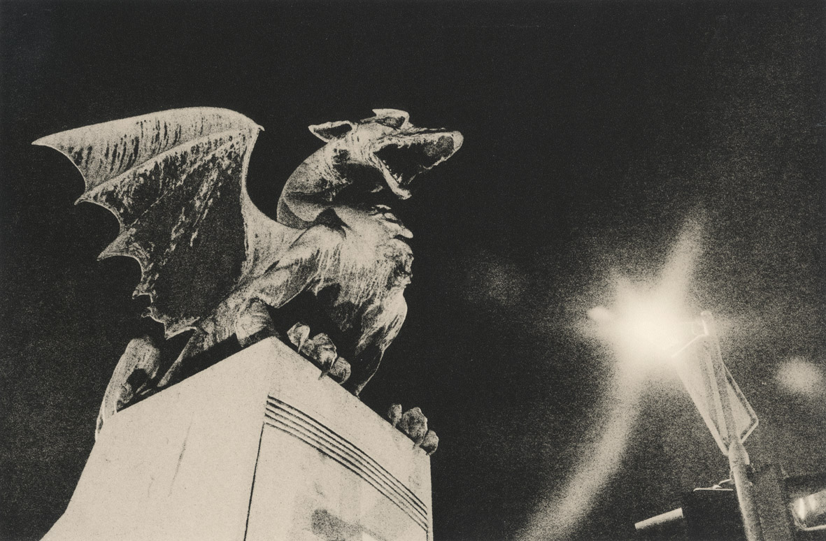

Really bad news as is one of the best current papers around for lith, (in my opinion), and the other Variant surfaces don't work in the same way. Was just teaching a workshop earlier this week using it. Am rather fed up now.
Here's a 123 lith for you Miha!

Hi Mike, thanks. I see you did mange to visit Ljubljana after all. I hope you enjoyed your stay here.
