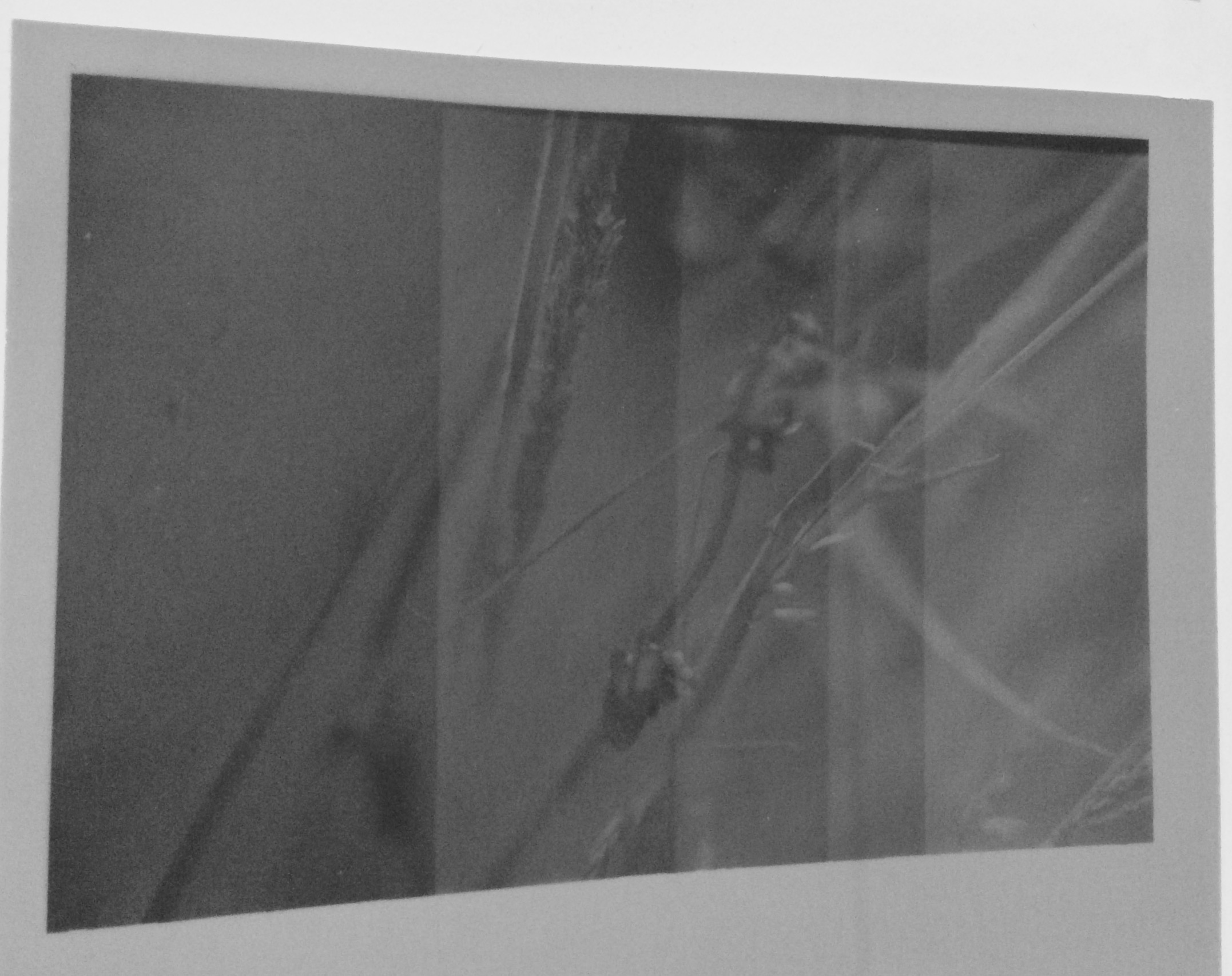

Hi all, just opened a package of fomabrom 112 Variant. And every test print looks like the paper was flashed! It did create a nice solarisation fx, but that wasn't what I was going for :wink: I double checked the TDS and it's safe for red light, it went straight from the safe bag. So I'm stumped. First time using this, but before I email the seller just wanted to know if it could be something other then defect. Developer/ Fix was ilfasol and rapid fix. Stop was plain water.
Thanks for any help,
Susan

Have you tested a piece in complete darkness? I don't know how old your paper is, but my habit of buying old papers means a piece gets tested for fog right off the bat followed by a coin test to see how long it can stay in my spaceflight without fogging.

It's in date (2018) but I think a go in complete darkness may be worth a try.

We just had another thread where at least part of the unexpected fogging problem turned out to be safelight related. There is a very quick and easy safelight test described in post #25 of that thread that requires no processing, along with a simplified (no pre-flash) coin test in post #16 that does require processing.

Thanks Ken! The CD/DVD test gets kudo points for being weird and wonderful :smile:. But I'll try the coint test or print w/ and w/o safelight. I'm already inclined to believe it is the safelight.

The test to check if your paper is fogged is as follows: In total darkness tear a sheet in half (or cut two strips, it doesn't really matter). Develop one of the pieces, stop and fix as normal. The other piece goes directly into the fix without being developed. After both pieces are fully fixed (everything up to this point in total darkness, of course), turn on the room light and compare them. If the developed piece is not as white as the fixed only piece, then there is fogging. This could be due to age, poor storage conditions, etc. If that is the case, then return the paper to the seller along with your test strips as evidence if needed.
To test your safelight, follow the procedure outlined on p. 5 in the Kodak publication K-4 here: http://www.kodak.com/global/en/consumer/products/pdf/k4.pdf .

I've been printing on 112 a fair bit recently and it is very easy to fog. I wound up printing in near darkness. Probably the safelights need replacing, but MGIV in the same room works with no problems with all safelights on, tested out to eight minutes.

Thanks guys! These are all great responses. And the surface quality of this paper (even fogged) will push me towards figuring it out, especially with all your help.

Hi, I am using Fomabrom 112, never had such a problem, and I use red light and amber light in my darkroom. Probably yours has taken light, control your paper safe.

Fomabrom Variant's emulsion is pretty sensitive to safelights, as is their liquid emulsion. Compared to Ilford's papers, it is quite a bit more orthochromatic - it's in about the same spectral sensitisation range as Ilford Ortho+ film, though obviously quite a bit slower in speed. Ilford's data sheet shows that Multigrade Classic is sensitised to about 550nm, but they recommend a 580nm cutoff safelight. Fomabrom Variant seems to be sensitised to about 575nm, so you'd want a safelight more in the 600nm range - aka a Kodak 1A or Ilford 906.
