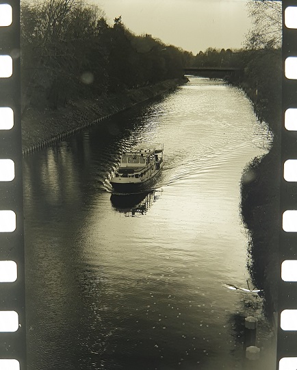

I got my first results using the kit with Fomapan 100 R. It looks really nice.
Unfortunately, i was not aware of how soft/brittle the emulsion becomes through the process and i scratched it in the end. Should have handled it with much more care. Never had such an issue while developing Fuji's E6 films. I guess the explanation is that these emulsions are much more hardened?

Does the Foma kit use permanganate bleach? If yes then it could be the cause for softening and scratches. Permanganate bleach requires care with temperature and agitation.
On a different note, do the slides have the tint in reality that the pic you shared has?
The "scan" i made with my phone greatly exagerates the tint.
I would say that the darker frames have an olive tint to them. The brighter ones look more grey.
Jul 28, 2016
2,941
India
Thanks for the clarification. I was wondering if the tint was due to insufficient clearing after the bleach but if it's density wise stain then it's probably a characteristic of the film. I hope
you don't find the olive tint unpleasant.
Coming back to scratches, you might want to make sure that there's not a significant change in temperature throughout the reversal process and your agitation is very gentle during the bleaching stage. Also avoid wiping the film with either wet fingers or squeezy.
