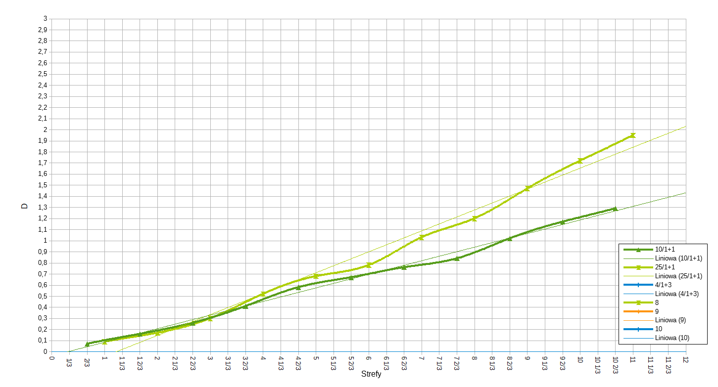

I have finished Foma Retropan test. The film was developed in Ilford ID0-11 developer, dilution 1+1 in Jobo CPA-2, rotation 4. In my practice this is a standard rotation for developing films, not too strong but not giving any streaks or signs of uneven development. The film was tested for my Zone system, so results may be different for other photographers.
These are results:
Dev time Sensitivity
N-1 10 200
N+0 17 200
N+1 23 250
The characteristic curve from tests:
The x axis - zones, y-axis - optical density.
I didn't do any practical photograhic tests, so I can not write anything about grain, sharpness, etc.

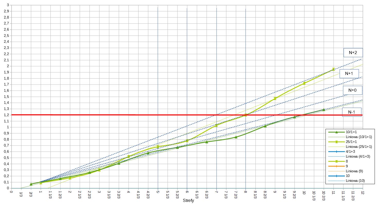

Very interesting! I've done some tests too, but with HC-110. I used an X-Rite model 334 to expose the film, and an RH Designs Analyser Pro to measure the negatives (placing the film directly onto the sensor). I'm attaching my Libreoffice/Openoffice spread sheet showing the complete results of the testing. The spread sheet is the one Ralph Lambrecht created for the utterly excellent "Way Beyond Monochrome" books, with a few small bug fixes by me.
TL;DR: With HC-110, use dilution E (1+47) for condenser enlargers, and dilution B (1+31) for diffusion enlargers, and expose and develop as follows:
N-2: 4 minutes, 125 ASA
N-1: 5.5 minutes, 160 ASA
N: 8 minutes, 200 ASA
N+1: 12 minutes, 200 ASA
N+2: 19 minutes, 250 ASA
The use of dilution B for diffusion enlargers is not shown by the spread sheet. Separate testing showed me that changing from dilution E to B caused a contrast change of about one paper grade; equivalent to the difference between typical condenser and diffusion enlargers.
  • FilmTestRetroPAN.ods
