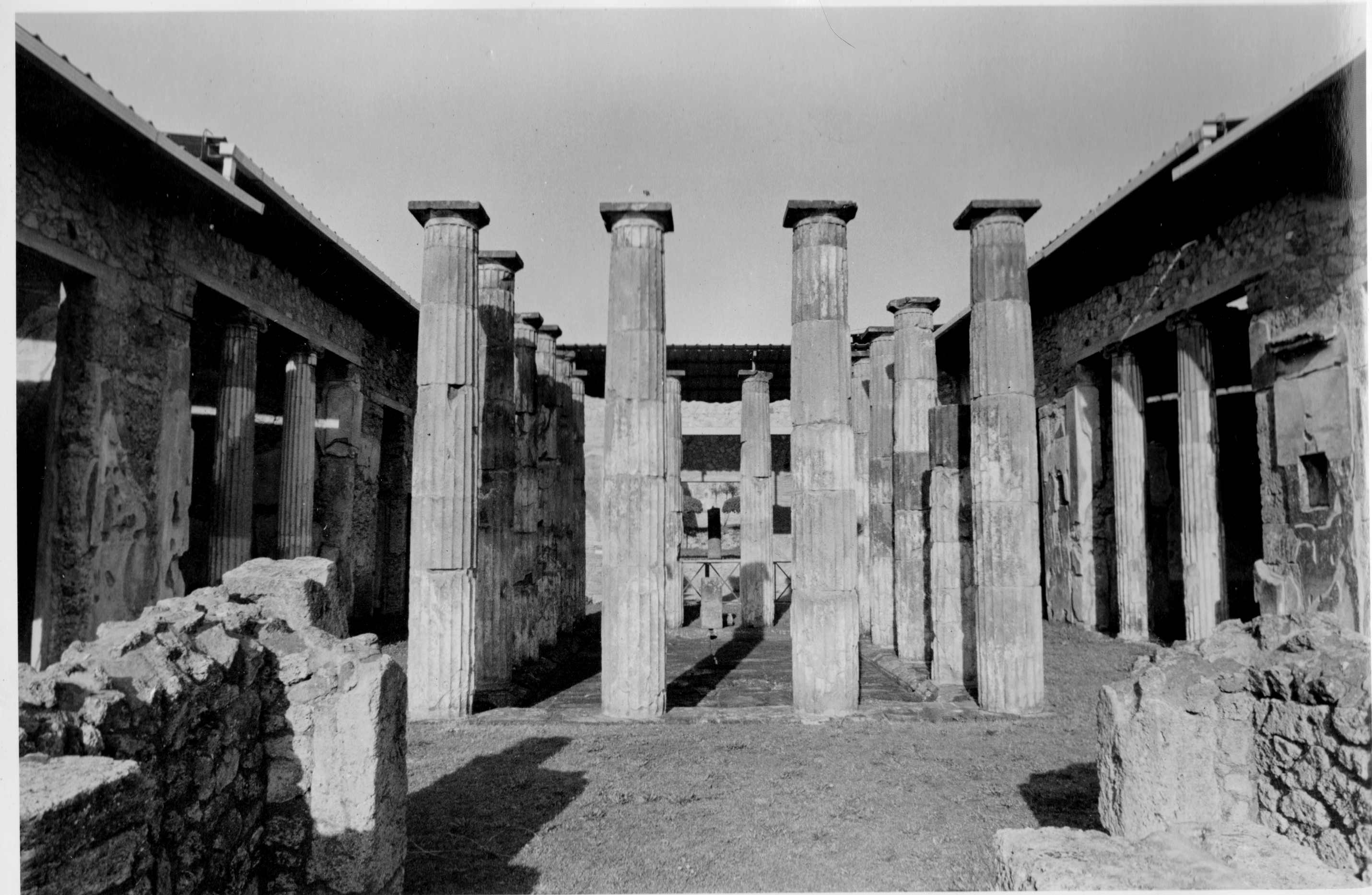

I have a packet, a few test prints, seems to be about grade 2, tones are ok, not wild about it. This a test print, the paper needs to be flattened, there is some glare from the edges while being scanned. And not toned.

Nice shot. It doesn't look too bad at the edges where it's sharp. There's a pack of Fomaspeed Varient 311 here, whatever that is. Information on that one was pretty scarce too. My plan is to make some 11x14's from it this week and compare it to the Ilford paper I've been using. Will post a few examples of those when they're done.

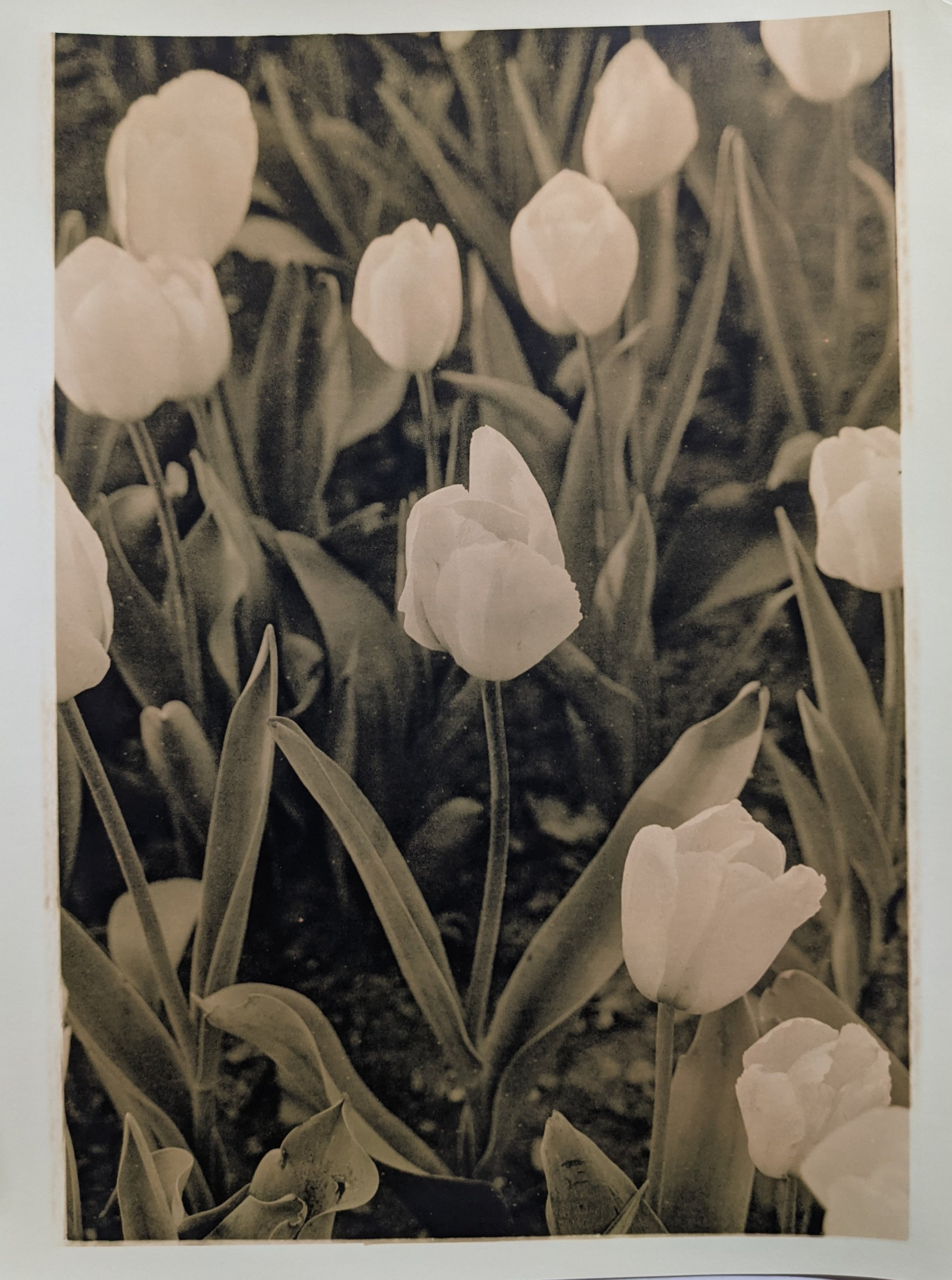

I saw your message the other day and meant to respond to include a Lith print I did with Retrobrom.
I order a couple of packs recently. I have only made a couple test Lith prints during a session (and straight using ID-78 warm tone mixed developer).
I was pleased with the straight prints, though as of now prefer Fomatone of the two for that.
In Lith developer it appears to be a little more finicky than Fomatone, but looks to have some potential. The colors (in Moersch SE5 @ 1:25.) lean more towards the warm browns and olive hues. Here's an example of one I did, still a work in progress so bear that in mind.
