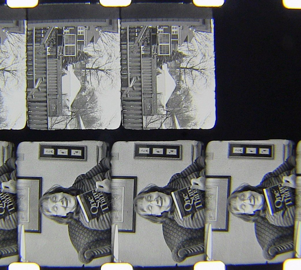

I will do a test of 3 feet long of Regular 8mm one half outside one half inside under T lights only. No daylight bulbs allowed. Then the 3 foot strip will be cut in half to 1 1/2 feet . On Jobo 110 reels one will be developed 10 min and the other developed 25 min. Then I'll see what is what. Thanks for the replies, but I do not understand DMax at all. Never studied that. Nor can I use graphs, but I may be getting close to being able to plot one from all the tests I've done. Another test looked great at 60 minuets and 800 ASA about
The test is done and there are pictures on both parts. 10 minuets development at 68F looks dark indoors, darker than it should and outside it may be correct because it was very overcast. but still looks dark. The part that was developed 25 minuets at 78F looks much lighter, indoors it looks correct, as the room was, outside it looks light, maybe lighter than it was? I cannot tell about the leader because it is so small, regular 8mm, until I slit it and put them side by side.

Contrast is lower in darker images and I try to lighten them by developing longer. Indoors, a yellow or off white wall looks gray and dull compared to real life when developed 10 minuets, however the 25 minuets one looks correct. The darks are judged by looking at a light bulb through the leader, which is black. I load and unload in the dark to get black leader and eliminate flashing the ends. At 80 degrees F and 21 minuets the leader became too light and thin for me. Ones like that are Selenium toned to darken them back down. Just a little because the lights also become darker, just not as fast. So, I lower the temperature and then extend the time. That lightens the wall and darkens the leader.
What I wanted to find out was how this film, Foma R-100, behaves, developed as taught and my way, shot under identical conditions.
This morning I wrote a page about the sunny 16 rule applied to what I discovered. It applies if I use 24 fps and 1/100 at f16 on a not too bright sunny day with almost cloudy bright shadows, but still hard. Not as bright as it gets. I think the film is adjusted to include bright sun on sand and show. The image is 25 min dev not 10
