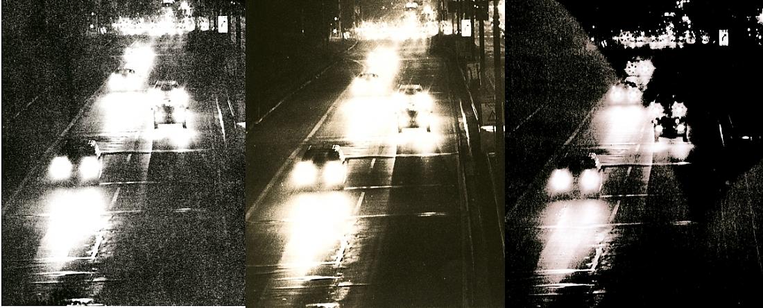

Hi all, maybe someone will be interested, just for information. I made three lith prints in MACO LP of the same 35mm negative (Kodak Tri-X) on three Foma papers. From left to right - Fomabrom (Fixed grade - normal), Fomatone MG classics, Foma Variant III. I like the result with Variant paper, the special violet hue is interesting. I don't like this paper for classical BW printing too much, but liths well. Dilution was 1+1+18.
I obtained on Variant some uneven development, mid part was complete black, overdeveloped, still don't know why.

That Fomabrom doesn't look like it lithed; reminds me of attemps to lith Oriental VC, the newer stuff. Thanks for the tip on the Variant. The MG Classic liths so well that I never thought to try any of their other papers.

I forgot to mention, it is cropped enlargement (1/4 approx) of print. I posted whole Fomatone print in gallery.
I think fomabrom liths, there is infectious development, but there is not any change in color, the print is just very gritty.

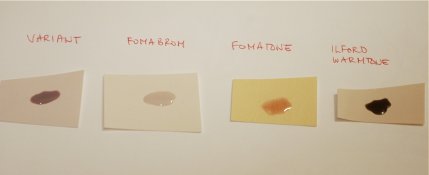

Dida, try this: place one drop of Maco solution B on a little strip of Fomabrom. With the lights on. See if there is a color change within the minute. Color change indicates there are developers incorporated, and the paper won't lith. Try it on a little swatch of the other two papers to compare. I pick up a lot of old papers from here and there, and it's a quick test to see what has potential and what doesn't.

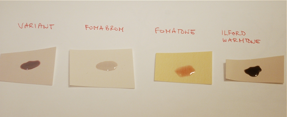

Well, I tried as you suggested, small drop of part B on light. It is late evening, so it is tungsten light. I made digital photo of result after approx. 5 minutes. There was no more change in color, only in smell around :smile:. So fomabrom doesn't interact .... I don't understand yet what is principle, but I can see results.
All papers FB: foma, foma, foma, ilford.
