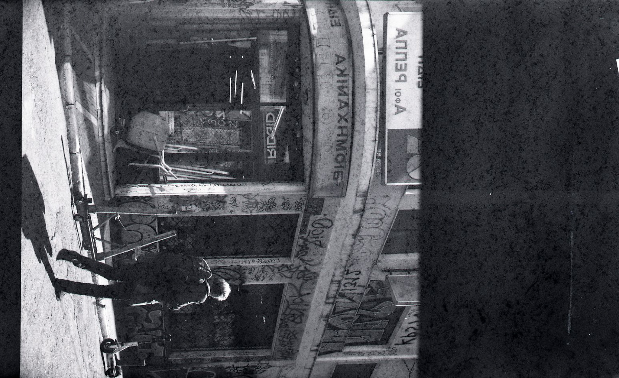

I had a problem with two 1200 rollfilms
they came out with fog but like if 30 years old?? box says good till 2025.
any one had to clean something like this ???

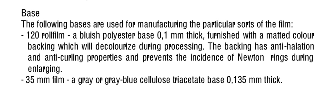

The base is dark for anti-halation purposes.
This from the Foma spec sheet

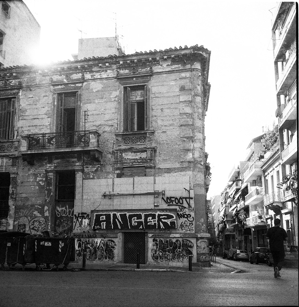

FomaPan 400asa-up to 1600asa
DEV. Selectol soft 1:7 mixed with Multigrade [Ilford] 1:4
in a compact tank 750ml 2 120 rolls on one reel.
temp 32-degres for 10.5 min with agitation + a sitting bath 9min [water]
here the two rolls came out the same
#271 is a scan as is
#264 was the roll just before
in a compact tank 750ml 120 rolls on one reel.
temp 27-degres for 8.5 min with agitation + a sitting bath 9min [water]
it came out perfect [well almost]
must add if the film was transferred in the summer time from warehouse to store in summer here in Athens by means of some motorcycle, and was exposed to the sun - that means a heat index of 90-degrees that could f%^& up the film !!

Looks very similar to a backing paper impression I had from 120 Fomapan 400 that I pushed to 1600 6 months ago.
Worse than being transferred by motorcycle, if it sat in a hot car/truck in Athens in the summer it could very well have intensified this effect. I remember leaving my film for a couple hours in a car in Greece under the direct sunlight last summer while it was 114F (45C) that day, and it was okay with no discernible difference, but it was mostly 100 speed, and mostly 35mm, and in an insulated bag - all things that would have improved its chances. But if it had stayed hours or days longer, who knows. The car was easily 130-140F when we opened it up.
By the way, I've never developed B&W film at 32C before. Highest I've gone is 27C, coincidentally, that was also Fomapan 400 pushed to 1600, and that came out great. But that was 35mm.
You can tell this isn't base fog because of that line in the center, which is present on the paper. Substances in the paper are getting transferred onto the film.
Backing paper offset issue. The transport conditions described are probably not such a good idea.
Btw, when asked for a picture of the negatives, it's generally preferred to provide just that. So not an inverted scan, but an actual photo of the negative as you see them with the naked eye. When judging things like fog etc., it's important to be able to see what it looks like for real without the intervention of (too much) digital processing. Having said that, in this particular case, the problem is quite clear.

@albireo Most manufacturers of 120 rollfilm use a clear base. But Foma uses a blue base for 120.
Many people confuse anti-halation gray or blue base with fog, not realizing it is not fog. Discussions on Photrio can go a long time before anyone realizes the film is fine.

Oh and the picture on the left in post #12 with the clear tail shows that there is a significant image quality defect. That tail is mottled and mottling is a defect caused by interaction with the backing paper.
I wouldn’t call it fog. I’d call it severe mottling.

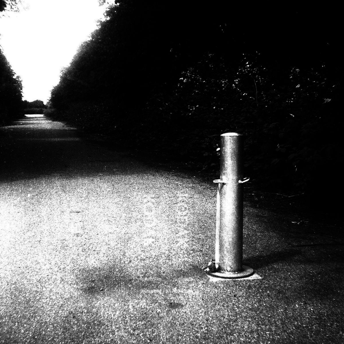

Historically there were always some problems that arose with backing paper equipped films like 120 because of the interaction of film base, film emulsion, printing ink and the wrapping paper itself. Relative incidence is higher now, due to a number of different factors, but the problem itself isn't a particularly new one.
From 2019 and one of the batches of Kodak TMax 400 affected by wrapper offset - adjusted so the ghost image is visible:
