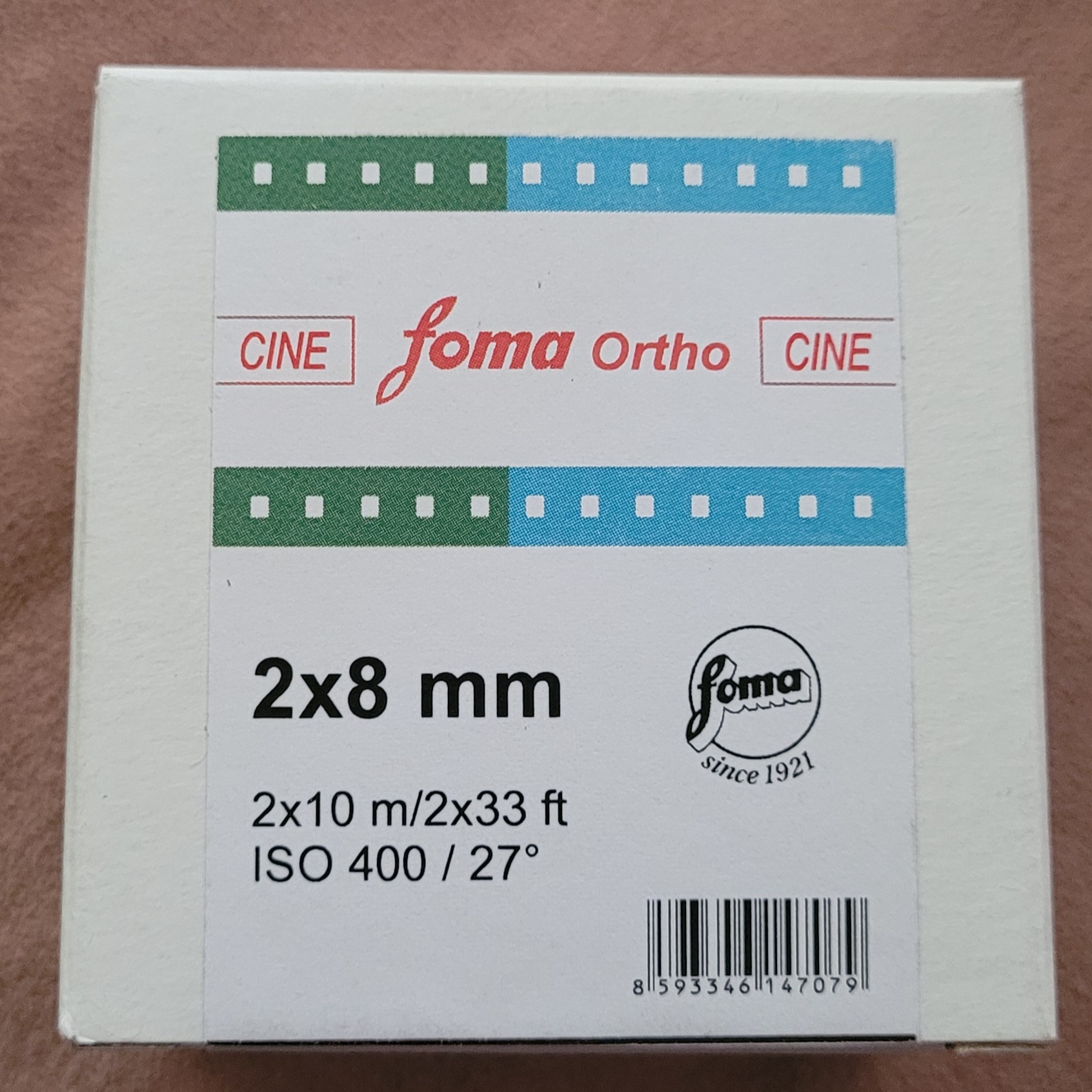

It's arrived. I'm planning on shooting two rolls towards the end of August. I'll report back when I've developed some.

I shot the first roll, in a variety of situations including bright sunlight, inside a dim church and fireworks at night. The film handled all really well with the church shots being especially successful. I'll put a selection of shots on Youtube soon so people can get an idea.
I decided on a Sankyo 8CM which only automatically meters up to 250ASA. The sunny shots will have been over exposed despite shooting those at 24fps. But it all came out well. The grain is surprisingly unobtrusive for such a fast cine film in 8mm. I've tried shooting Tri-X and Fomapan R100 in the same church and while I got results, the contrast range in the shots I did last week was far superior.
The ortho aspect really lends itself to shots like landscapes. I made some long shots of beaches in the evening and some on the beach on a sunny afternoon which look great. Perhaps the best is a single shot of a gravestone in a very leafy churchyard.
you can use this as a high speed cine film without worrying much about lack of red sensitivity. Though it does rear it's head, I shot a little from a moving car at night and you can barely see the tail lights of the car in front while the tailgate is lit by streetlights. But it renders white and brown skin tones nicely. No problems loading it or developing it. I used D76 in a Lomo tank. There was a little fogging as I changed the spool over on the beach under a parasol, not ideal conditions and I expected it.
I've shot a quarter of the 2nd roll, mostly in another church as it happens. I'm probably going to finish off that roll at the jazz club which will be interesting....the high speed nature of the film should really help (I've had great experiences with Tri-X and what I think is XX there) but the backlight is predominantly red so it won't show up much.
But for now, if you can get hold of it, I thoroughly recommend this. If's not expensive. It's easy to process at home or at the lab. If you scan rather than project it's no more hassle than a reversal film, and is easier if you dev and scan yourself as I do. I just use one of those cheap domestic scanners and some old video editing software to invert the image and tidy up the framing and contrast a little.
EDIT: I did have real difficulty opening the film cans. I've never had this with Fomapan R100. But I ended up having to turn the container upside down, and bash the rim of the top with a small hammer to get both cans open. I was certainly never going to simply twist them open like I do the R100 cans. Maybe they've changed the design of the can a little as the spool inside seems the same.
