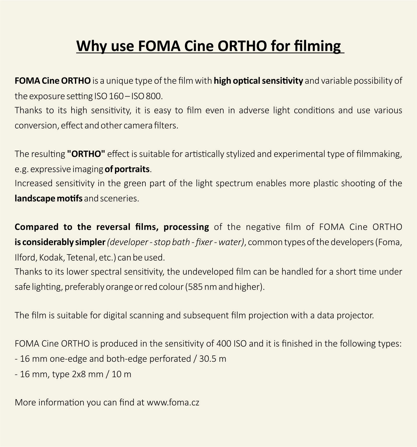

I am trying to obtain some 8mm Foma cine Ortho in the UK....which isn't easy as the two biggest importers of Foma materials aren't intending to carry it as a regular product at this time. However, Process Supplies in London may be willing to order a small amount for me next time the place an order with Foma. I only want to try, say, four rolls of std 8mm.
But in addition to the potentially interesting ortho nature of the film, it's negative which means it's much easier and cheaper to process than the Fomapan R100 that they've been making for many years....the problem here is that very few labs now offer B&W reversal processing and demand is low so processing costs have quadrupled in the last 10 years and doubled in the last four years. It's now around £44 to get one 15m roll of std 8mm Fomapan processed. And it's tricky stuff to home process even with a Lomo tank. Any lab can do the Ortho film in regular B&W chemicals in less than half the time, and anyone with a Lomo or other suitable cine tank can process it in about 30 minutes.
There's also the interesting claim that it can be exposed at anything from 160 to 1200ISO which makes it potentially very versatile....at the slower end it's just about usable in sunlight in most cine cameras, whereas at the top end it's real low light stuff. I've never shot 8mm film faster than 400ISO and that's suitable for indoors under ordinary home lamps.
