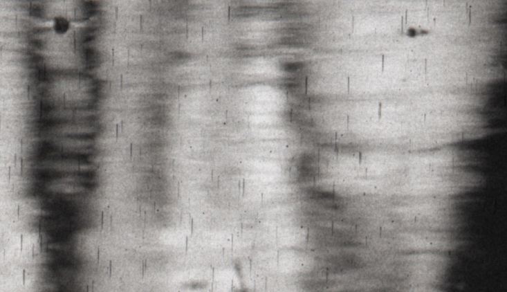

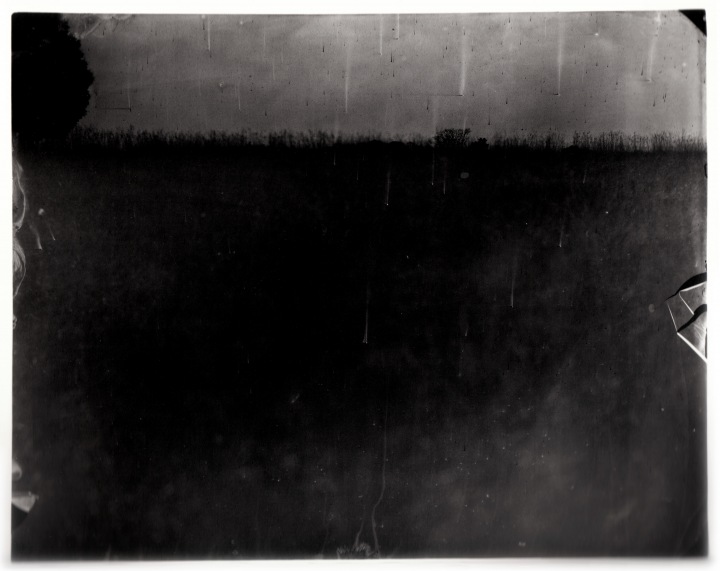

Good to know I'm not insane. 2 crops from 120 fomapan 200 in a A12 back:
First looks like cracks, this only happened at the end of the film, scratches on the second were only at the beginning of the film.
They look like scanner issues but they aren't, they are on the negative.

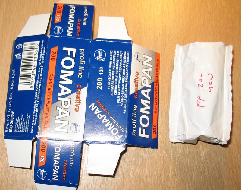

The new-and-supposedly-improved Foma 200-120 arrived in the mail today. Credit to Robert and his Fotohuis RoVo for catering to Foma's and the customer's needs. Not an entirely thankful position to be in.
The new film is dated 1/2015, batch number 010656 4. Robert has written on the white wrapper "Foma 200 new". Nothing on the original packaging to indicate that something has changed, as far as I can tell. We'll have to go by the emulsion numbers.

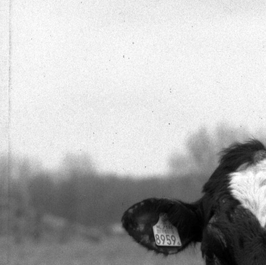

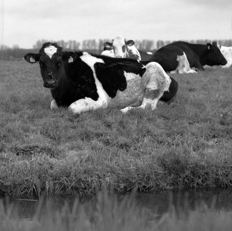

Alas, the new (i.e. replacement) Foma 200-120 doesn't seem to work for me.
I shot two films @EI 120 in the Hasselblad, and developed them in Rodinal 1+50 for 9'. Although the frames look fine at small sizes, closer inpection reveals the following:
1. a shot noise like pattern of tiny black dots (i.e. clear spots on the negative),
2. dark lines (i.e. semi transparent on the negative) running along both sides of the frames, along the entire length of the film,
3. the occasional scratch (short straight lines, parallel to the length of the film).
An example of 1 and 2 (visible on all frames):
The entire frame looks sort of alright:
but a closer look of cow 8959.6 reveals 1 and 2:

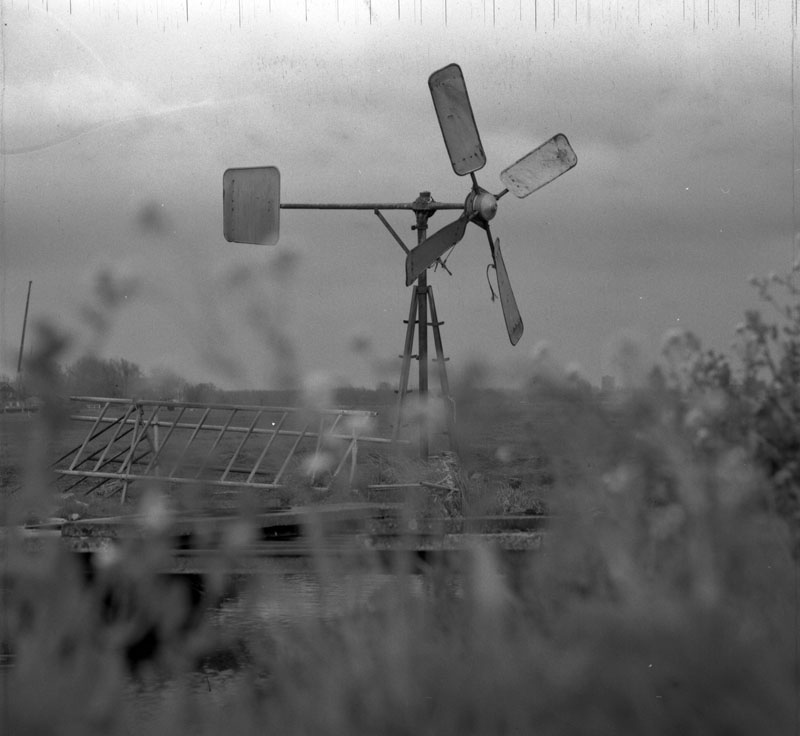

Another frame shows scratching very similar to what could be seen in Foma 100-120:
Not all frames are scratched to this extent; the above shot is worst.
There may be workarounds for some or all of these issues: use demineralized/distilled water for the developer, don't pre-soak the film, don't use this film in Hasselblads and the likes (tight loading systems), etc etc. I will not attempt any of this.

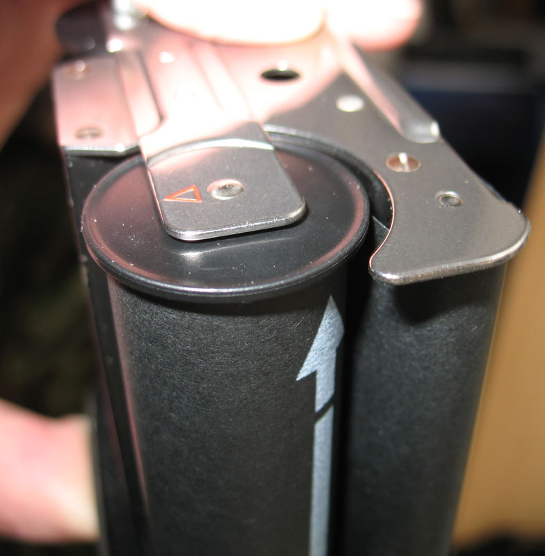

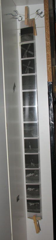

- The film is very short. Loading until the arrows on the insert and the film are aligned will make you lose part of the last frame. Workaround is to load the film until just before the arrows align, like this:
Then all frames will just (but only just) fit the film. It's a tight fit:
Foma had better call this 11-frame film, or, preferably, make the film a bit longer; just a few centimeters should do.
