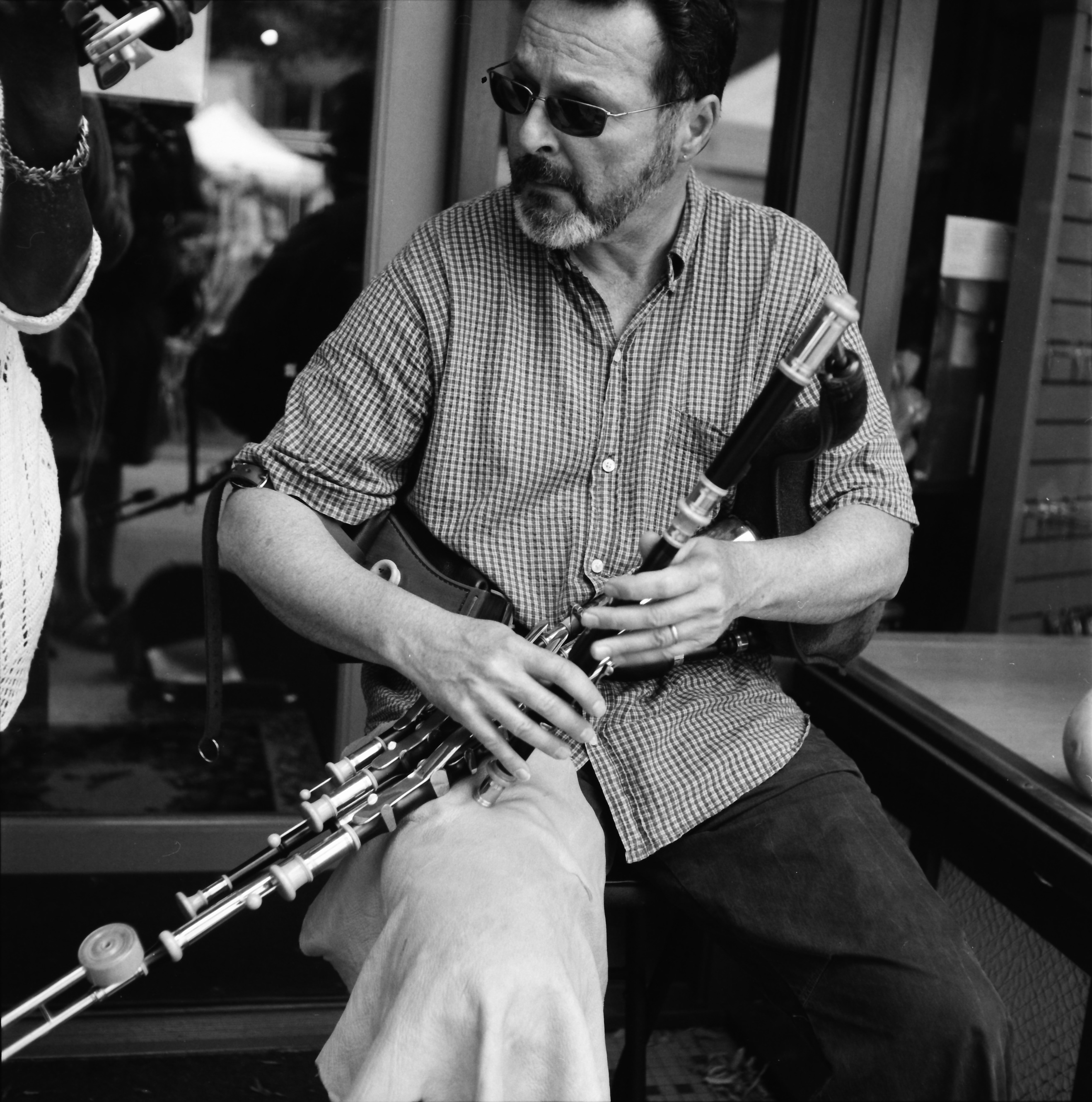

OK, bought a brick of this because it claims to have wide latitude -- 100 to 800 -- and great tones and so on and so forth.
Anyone ever advertise film which, they said, "really sucks?" I didn't think so.
Anyway, it's not half bad, although I wonder about that ability to handle two stops under. I didn't intentionally underexpose, but the negatives, anyway, seemed a titch thin exposing at 200 with my usual allowances for kentucky windage, prayer and "feel" for the exposure.
But the scans look good. A couple of samples hereunto attached, shot with a Rolleicord.
Anyone else?

I developed this in D-76, 1:1 for 8.5 as per the massive dev chart at freestyle. That's how I develop everything.
And as I said, these are not half bad.

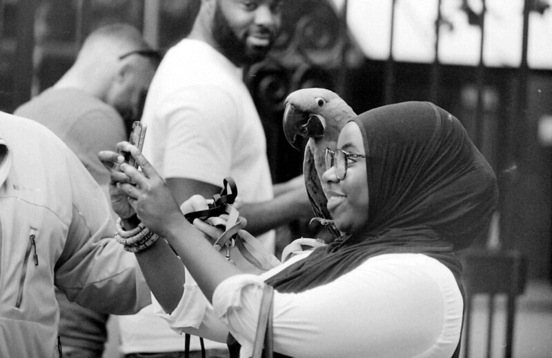

I agree with that, although I find F400 quite good for people in the street:
Selfie with parrot by Ricardo Miranda, on Flickr
Foma introduced last month a new film with lower contrast and less red sensitivity as far as I can see: Retropan 320 Soft.

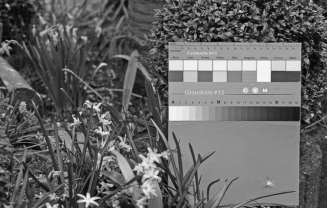

That MCM 100 is doing very well is no surprice. I tested the film pretty deep in Windisch W665, instead of para- Phenylene Diamine (MCM) this receipt is using ortho- Phenylene Diamine. Expose the film on E.I. 80-100.
The ortho version is less staining crap and also less toxid then the para version of this chemical stuff.
FP200 E.I. 100 in W665 1+0 9:45 minutes at 20C. On the grey card exactly 0,72logD.
