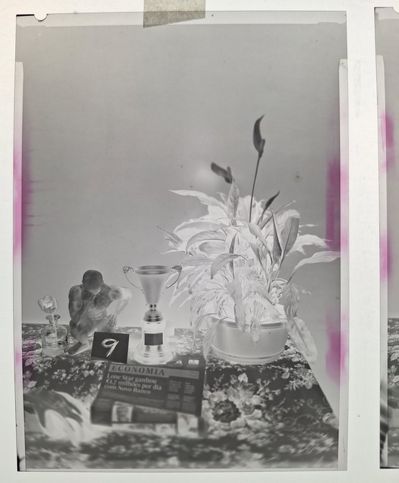

Can someone confirm that Fomapan 100 sheet films have any sort of chemicals on the film side opposite to the emulsion side ??
I got some pink discoloration on the border of my 13 x 18 negatives , in areas where the back if the film sheet may be stuck against the reel grooves.
Developer R09

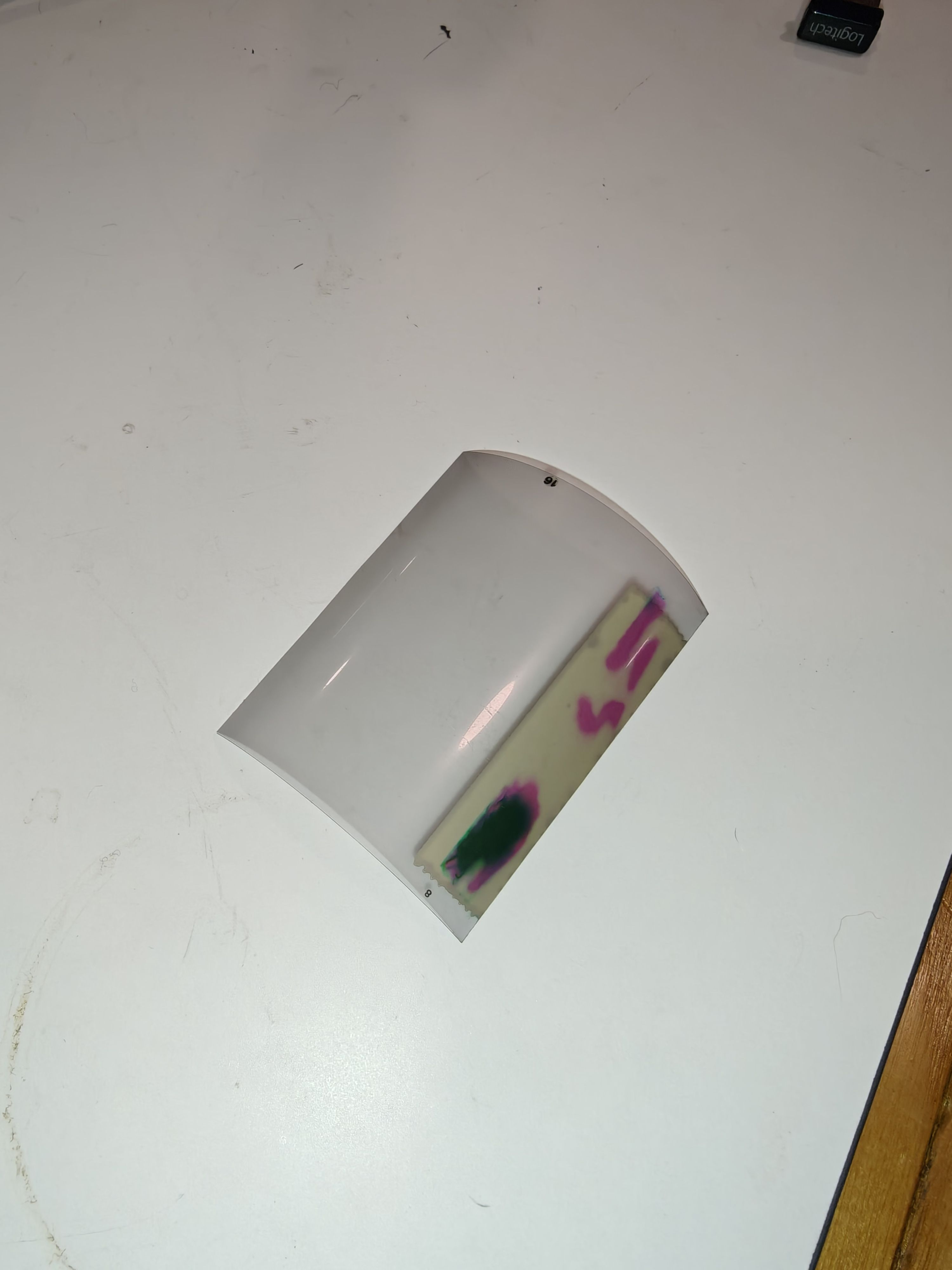

Found a scrap. It's doesn't seem like the same type of dye I get in other films because it appears to go away before I get to the rinse step, vs something like tmax where the water rinses pink for ages.
Worth noting that this roll of foma expired in early 25 so it's not an especially new batch.
It's interesting though since your sample shows very nicely the green anti-halo dye on the backside as well as the (I think new) magenta dye on the front/emulsion side!
