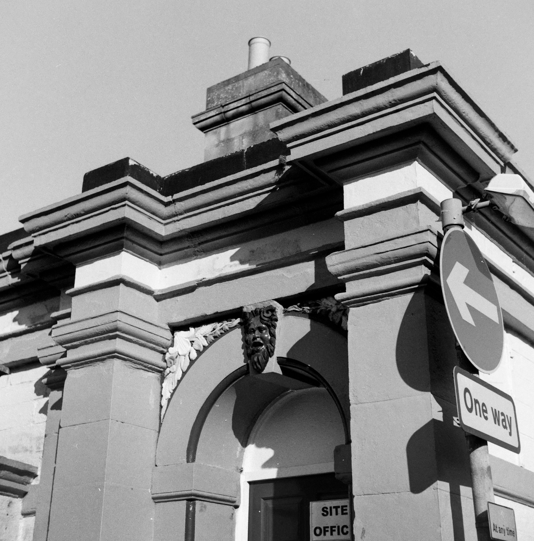

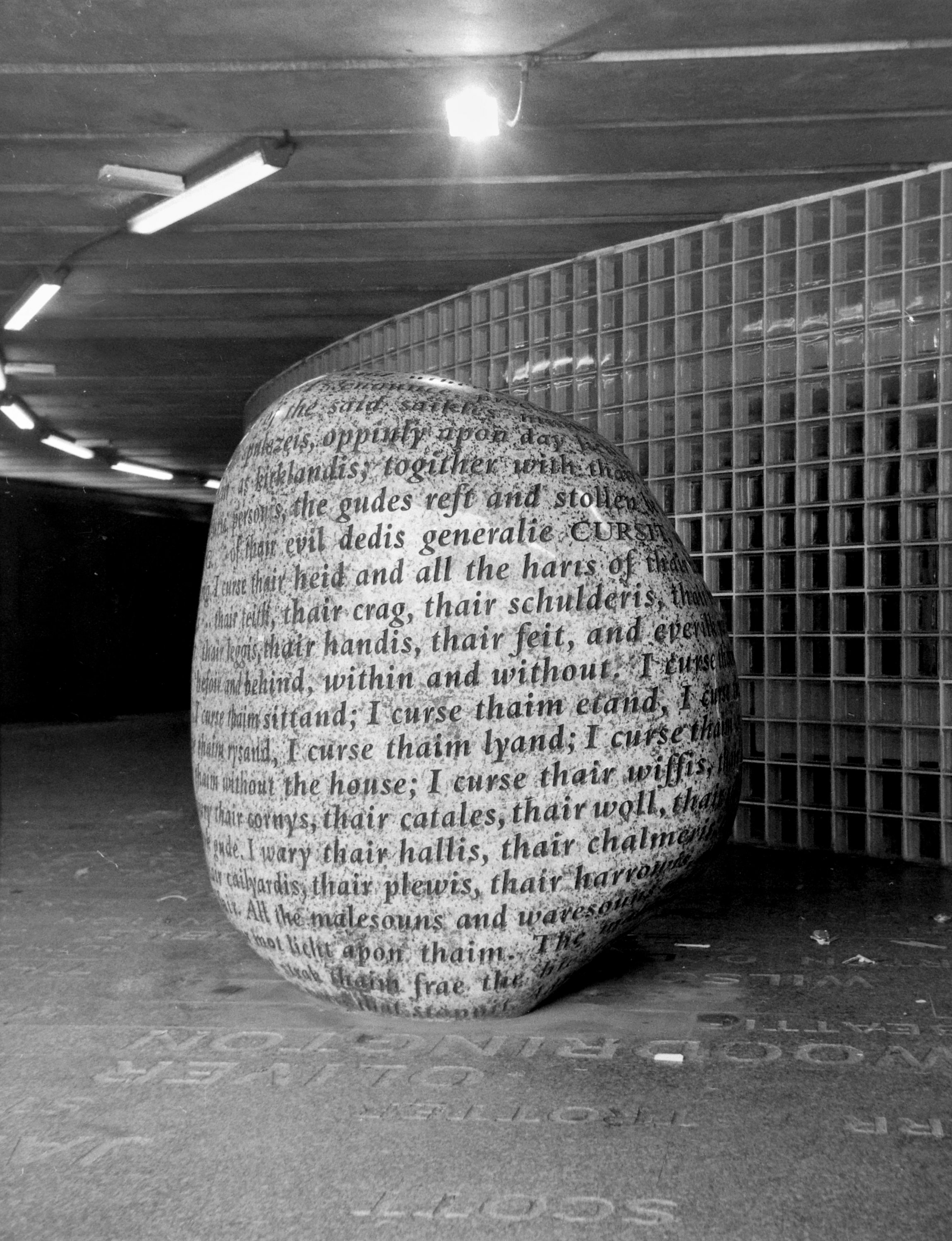

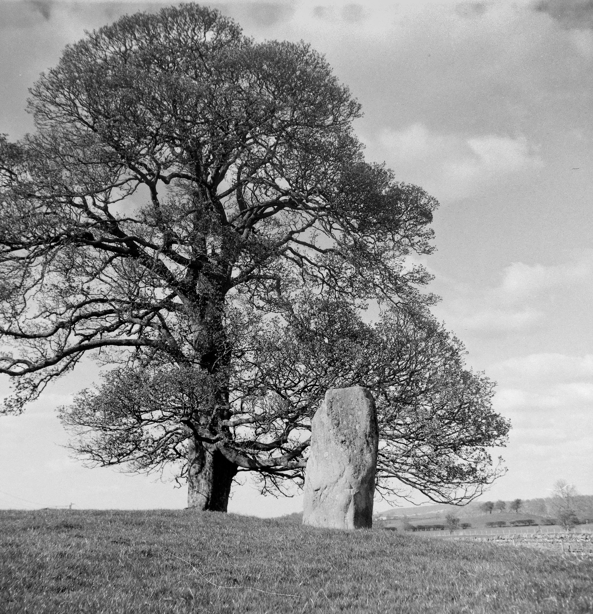

I think Rodinal works fine on Foma 400. Well, it does in medium format, anyway. I can't comment on 35mm as I've never shot Foma 400 35mm. Here are three I took on Fomapan 400 Action and developed them in Adox Rodinal (about two-and-a-half years old) at 1+25. Just scans, I'm afraid, as I don't have a darkroom yet either.
