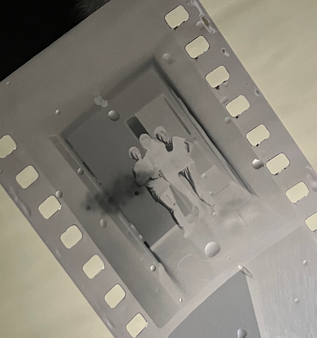

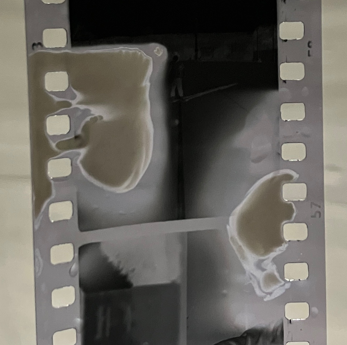

I just developed my first foma 100 film and was shocked about white spots on the film and on every frame at the same spot was also an overexposed area, camera is a fed-2 shutter curtain looks good is this film bad or/and curtain of the camera? Thx for help🙏

Just found a leak on the curtain :-(

Picture #1 shows a spot where the film was stuck to itself due to it being incorrectly loaded onto the developing reel.
Picture #2 shows a light leak; your problem with the curtain would explain it quite well.
