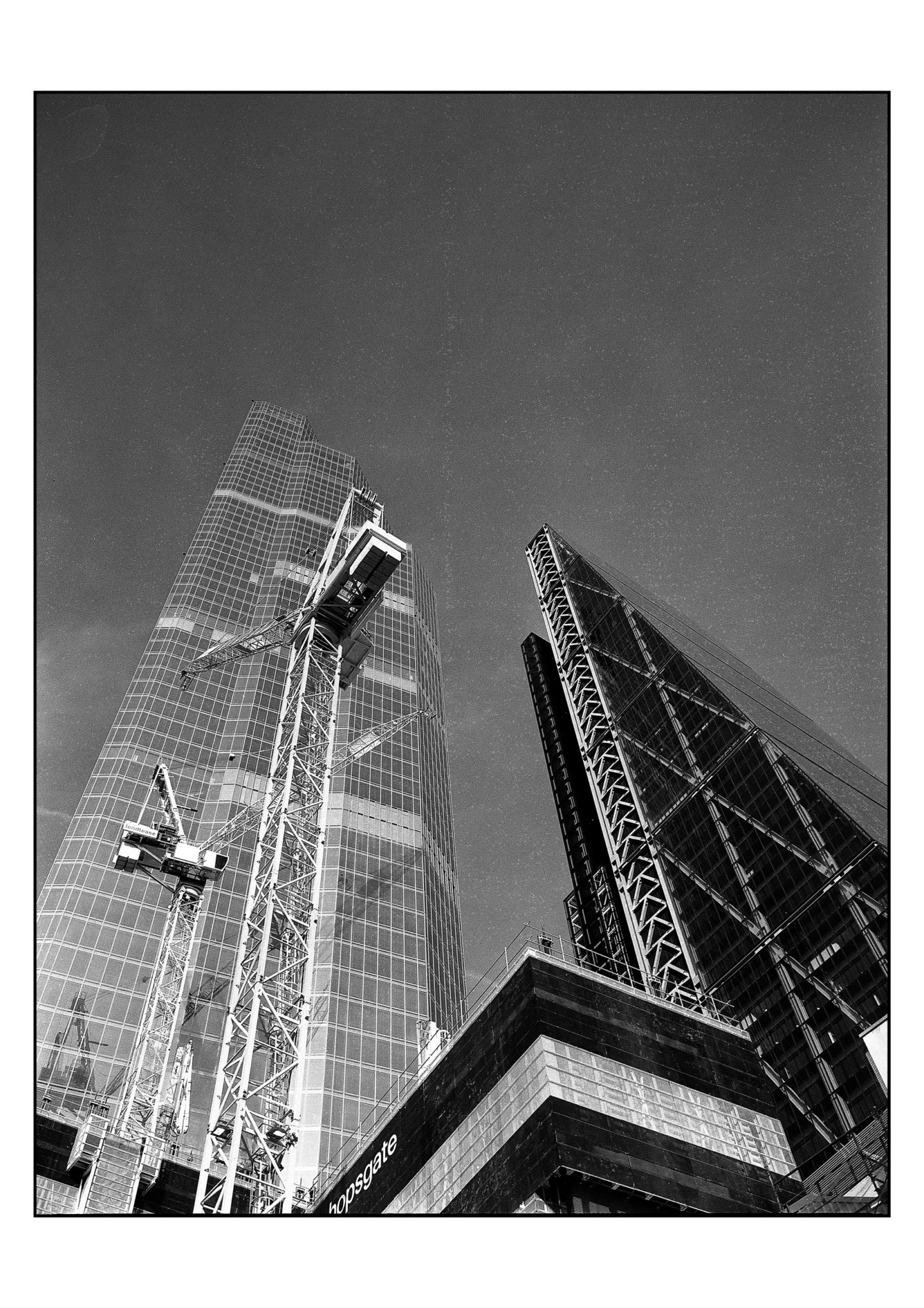

I came here to find answers to an issue of odd white dots on a 120 Rollei RPX100 roll I developed Monday - image attached. The roll was ordered from Silverprint just a week or so ago.
I havent seen the original thread where this is covered to identify whether this could be the same issue - does anyone have a link to it? I understand the production of Rollei RPX is a bit elusive and most likely done by one of the big European manufacturers.

Thank you kind sir! Do you have any links on this though? A quick google of Rollei RPX call back yielded nothing so they clearly havent put anything out on the matter. I'd be interested in seeing what the described white dots look like and whether it is the same effect I had on the attached.. The whole roll had the same effect. I developed a roll of Delta 400 in the same process the following day and had no such clumps..
I do not know anything about Rollei films, I have been dealing with these dots on Fomapan 100 and Arista EDU Ultra 100. It's the same emulsion.
The Rollei RPX films are coated by Harman (IlfordPhoto).
Thank you, is this certain? I was planning on emailing the retailer as I bought ten of these rolls and would hate to see the same happen in others.
An alternative explanation is the difference in wash temperature which admittedly I did not take very seriously - dev, stop & fix at 20c, wash under running water which was probably around 15-16c.
Yes, from the source.
Strongly differently bath temperatures may lead to "reticulation", a artefact very different from what you presented.
Again, thank you - so the temperature is unlikely to be the culprit. I have emailed Silverprint where I bought the rolls to ask for their insight.
In the meantime, if anyone seeing this recognises the issue and knows the cause, I would hugely appreciate if you could share.

I came here to find answers to an issue of odd white dots on a 120 Rollei RPX100 roll I developed Monday - image attached. The roll was ordered from Silverprint just a week or so ago. View attachment 257861 View attachment 257861
So RPX100 is manufactured by Foma?
I knew it was manufactured by Harman...

That's probably not reticulation. I've had far greater differences in chemicals and not had that happen. When you get reticulation it tends to be all over the film. There's a suspicious line of vertical dots between the two buildings on your photo, and then there's what looks like an overall dot pattern in the sky. If it were me I'd make sure the inside of my camera and tank were spotless, scrub the reels, shoot another roll, and filter everything through coffee filters just in case.
