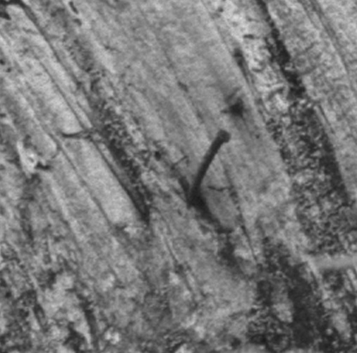

Attached is a tiny crop (1:1 at 2400 ppi, just over 5 mm square) from a test negative made with my Ideal and 13.5 cm f/4.5 Tessar -- this was shot at EI 160 from about five feet distance, and I hadn't even noticed the nail in the stump; development was in Diafine. HC-110 give slightly finer grain and a little more contrast; dilute Rodinal should give better contrast and about the same grain.
