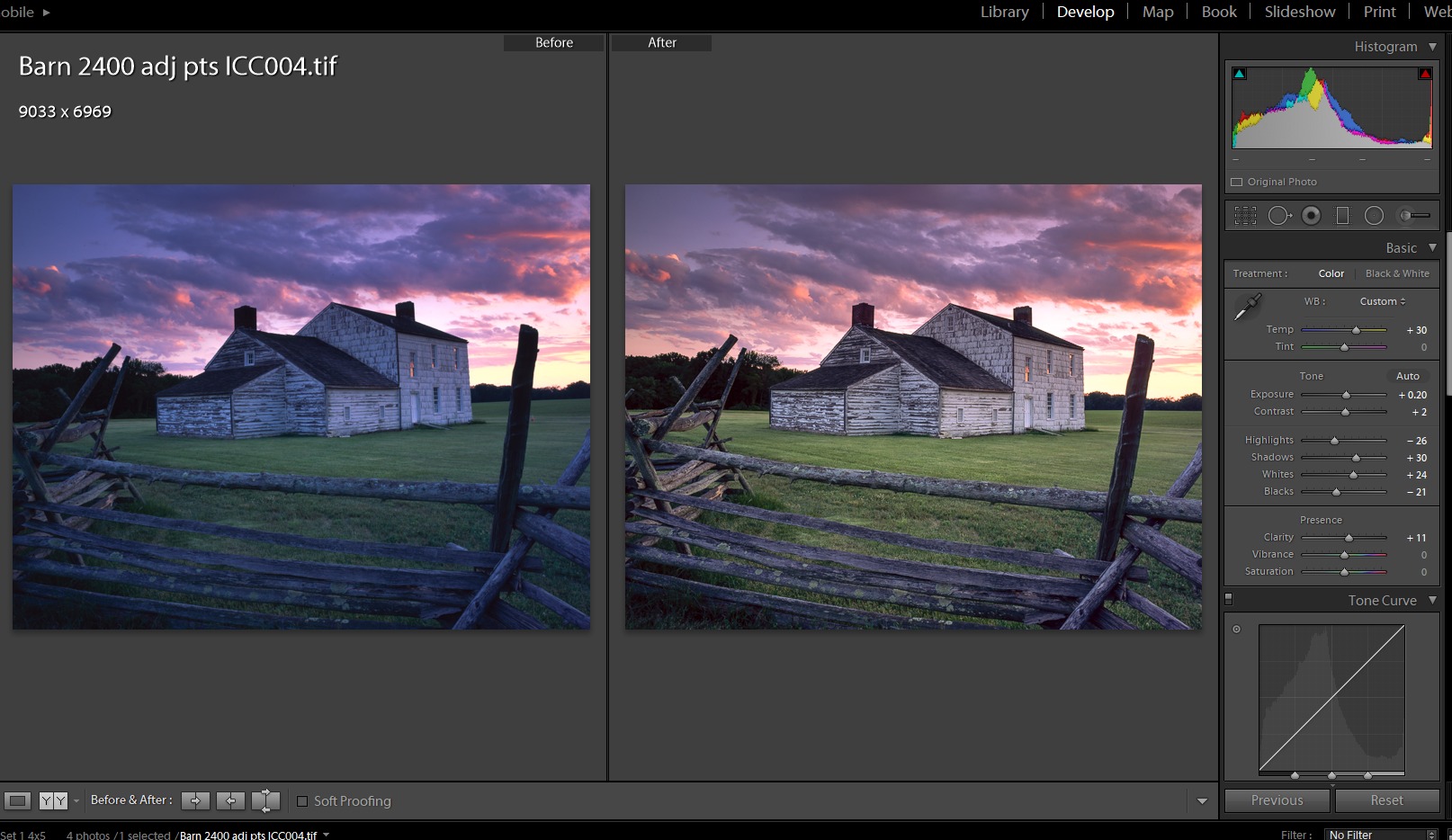

I think it was underexposed a little counting for the magenta cast even in other parts of the picture. Here's the before and after.
