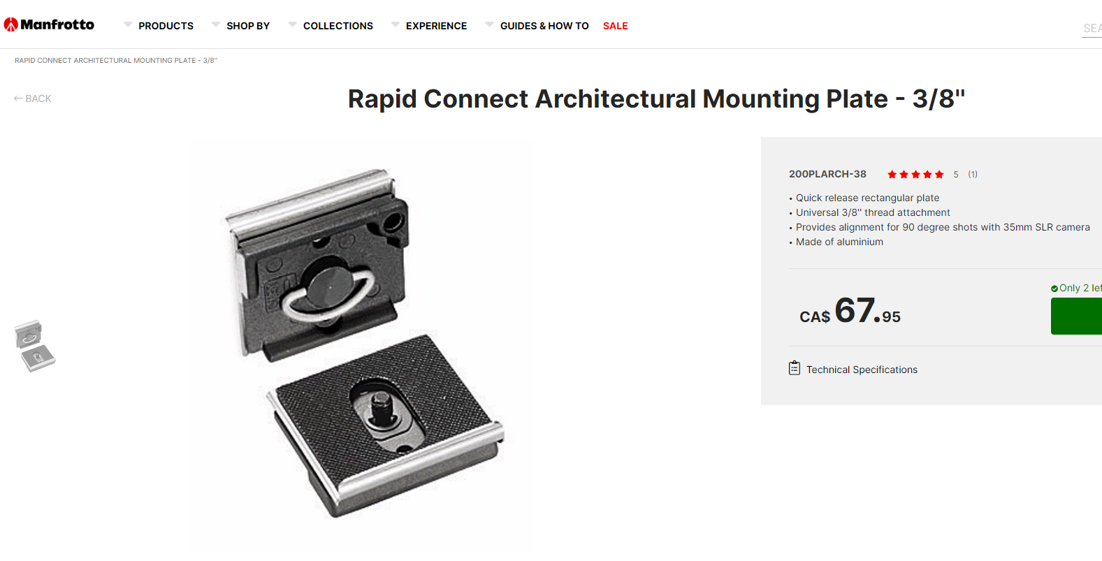

See if one of the "architectural" plates can be used on the camera - here is a Manfrotto version:
