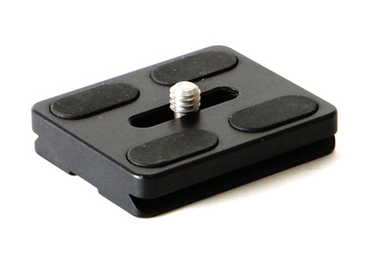

georg16nik
Aug 3, 2010
1,101
I use plates that look like these 2

PentaxBronica
Mar 13, 2011
365
Those plates look exactly like mine.
TBH the age of the tripod doesn't matter much, it's how well-built it is. I wouldn't put my Bronica on a cheap travel tripod as it'd probably bend the legs, but the RedSnapper shows no signs of strain.
250swb
Apr 22, 2012
1,534
Peak District
Tripod plates are a great idea for a quick release, but they don't actually spread the surface area much more than a normal tripod head does. On a Moskva you put a plate on and the camera still sits high on its own little pimple, and given that it is of a certain manufacturing quality not necessarilly a very secure pimple. You need to spread the clamping patch over as large an area as possible.
