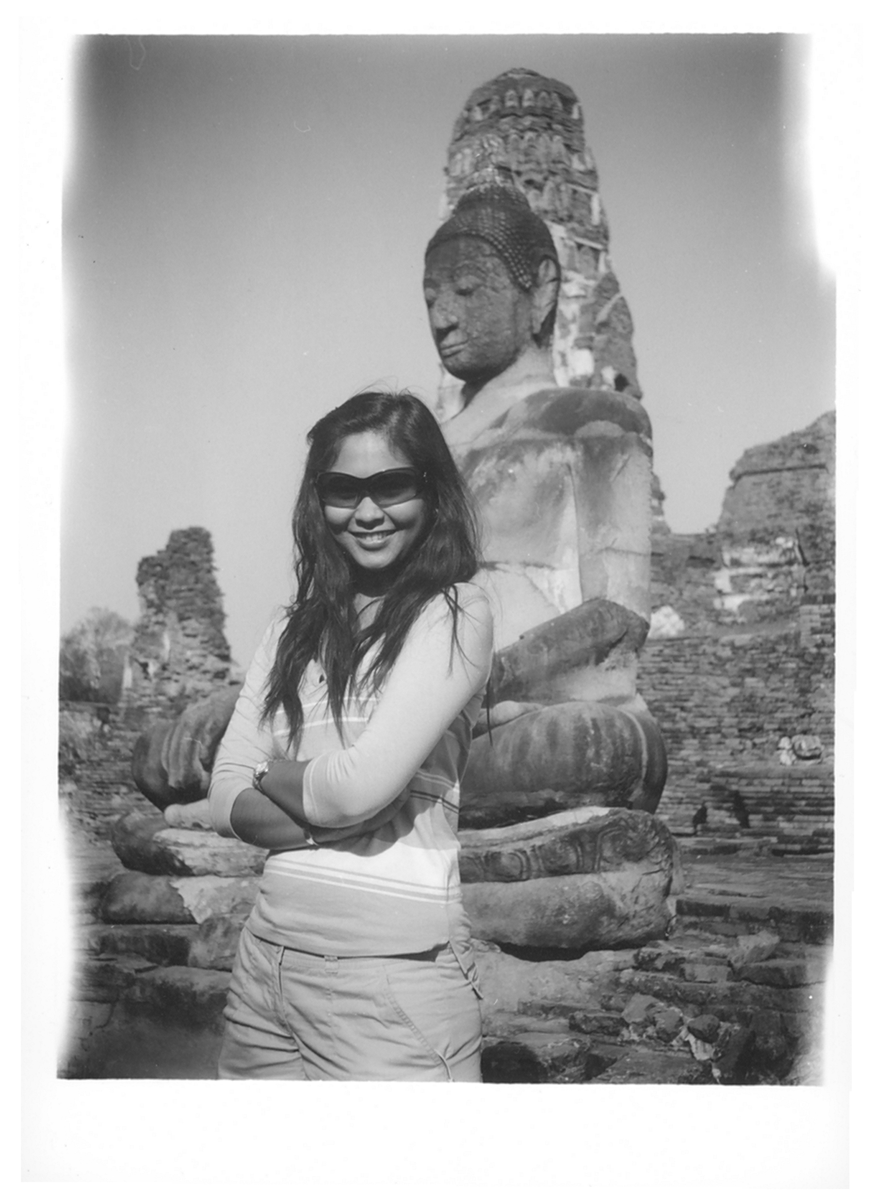

Love my Kodak 620 Junior folder; can't believe the contrast in the lens and when it's focussed correctly (still getting my head around ft.), the sharpness astounds me!!
No meter, just the sunny 16 rule and respooling 120 onto 620 spools.
Only hassle I have is that I only have 2 spools, the 3rd has some major wear and it slips very badly when winding on; need to find some "new" ones - the "trim down a 120 spool" option doesn't work for me unfortunately. Don't ask how I know . . . . . :wink:
The attached image was one of the first images I shot with it - my (awful) experience with a trimmed 120 roll is rather evident, this is one of only 2 images that survived. :whistling:
