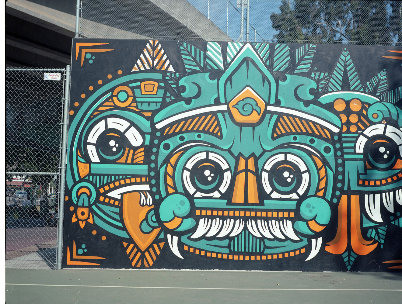

While out shooting some public murals a couple years ago (of course, everything was a couple years ago!), I found this one that almost exactly fitted the viewfinder of my pre-war Zeiss 6x4.5 Super Ikonta 531. This happened to be about the first excursion with this camera and I was curios to learn just how the photograph would compare to what was in the view finder.
The camera was on a tripod with the head rotated 90 degrees to the right. I aligned the right side of the mural with the "top" of the popup framing viewfinder and placed the tripod so the other sides all fit as perfectly as I could.

I guess that answered that question...

Thank you for mentioning eye position. I forgot to relate that in this case (and my normal practice now) I placed my eye so that the rear rectangle aligned with the lines on the albada glass and with the mural edges.
