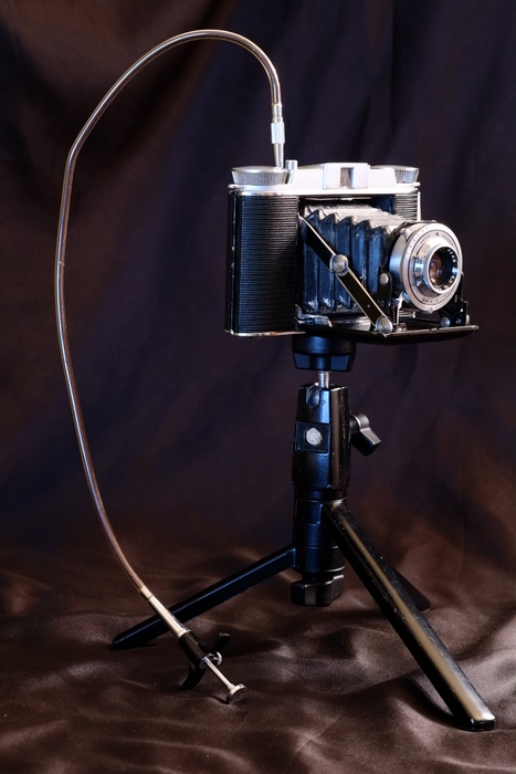

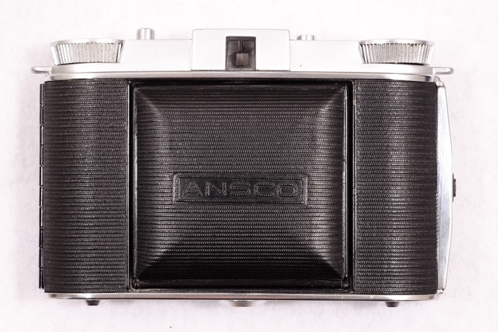

Over the Easter/Passover holiday, my 92-year old aunt gave me her camera. I am now trying to understand and operate it. Based on my research and examination, here is what I think I know:
Ansco Standard Speedex 90mm f/4.5 120 roll film medium format film camera (folder)
2 1/4 X 2 1/4 inch images
Production years 1946 - 1950

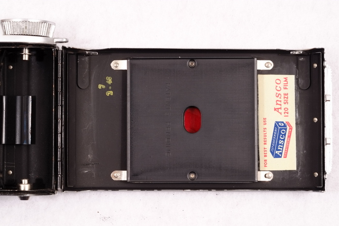

This camera built on 2/7/1948 or 7/2/1948 (based on what is printed on the inside of the camera back)
Manufactured in Binghamton, New York, USA
$36.50 price when new
$25 - $50 current price range for one in good to excellent condition
Shutter speeds 1/2 sec to 1/250 sec

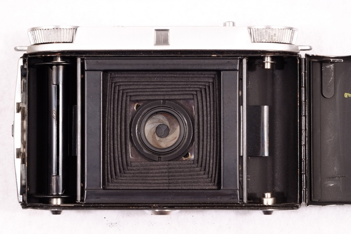

1/2 & 1/5 second shutter speeds not working
B & T shutter speeds not working
f/4.5 uncoated lens
f/4.5 to f/22 f/stop range
No flash sync
Optical viewfinder
Zone focus
Confirmation, correction, or additional information would be greatly appreciated.

What is it you need to know?
Rick A
Mar 31, 2009
9,949
Laurel Highlands
8x10 Format
The slow speeds are always the first to succumb to the dreaded hardening of the grease.
pbromaghin
Sep 30, 2010
3,810
Castle Rock, CO

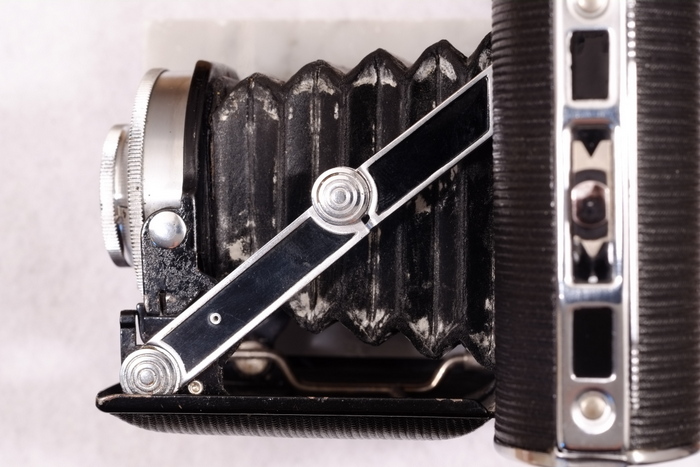

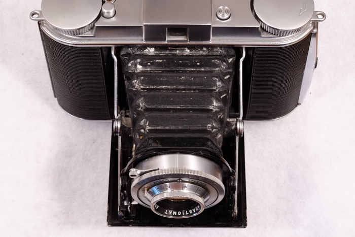

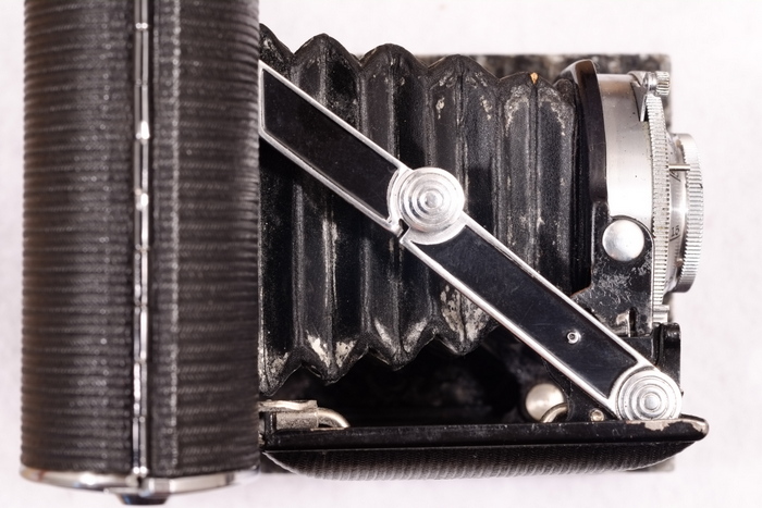

Nice camera. It looks like it was hardly used. The bellows may have some leaks, but the rest of it looks very solid. As an heirloom, it should be worth a CLA, which might run $75-125 depending on how much it needs. For that cost you will have a camera that works as well as it did when new and will fold up to fit in your pocket. I have a CLA'd Zeiss that I carry around most of the time. It should be a good shooter, a rough equivalent to 80MP. The anastigmat lens will be very sharp around f/8-f/11 and maybe vignette a little when wide open. These cameras have their limits, but they work very well within them and the limits are fun to find.
vdonovan
Jan 8, 2008
607
San Francisco
Traditional
Sometimes the focus ring is frozen on these, because of the lubricant originally used. Try turning that outermost ring around the lens, the one marked in feet. If it doesn't turn, you'll need a CLA (or fix it yourself, there are resources on how to do it). If it does turn, you're in luck!
bdial
Jan 2, 2005
7,470
North East U.S.
It looks to be well above average in condition, with the possible exception of the bellows, which should be fairly easy to patch up if needed.
Well worth trying out/using

Buy a new bellows for it. SandehaLynch.com
When the website opens up click on left bottom link. I have refurbished the Agfa variant of this. I love these cameras.
