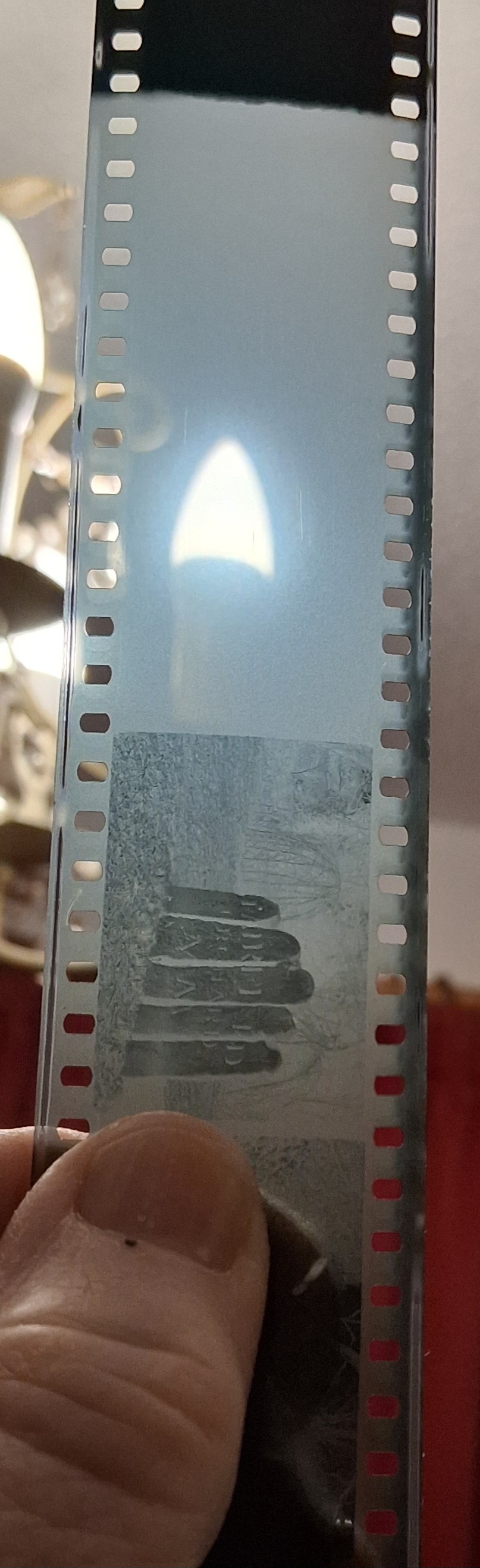

I bought some unidentifiable film in a loader. Tbh it is pretty nasty. You get two or three nice frames then three or four that look like they are covered in ash, then back to nice. I suspect it has been stored with a heat source playing on one side. There are no edge markings so I just experimented until I got a good Dev. I have been treating it as fogged, developing it in HC110 with a splash of Fog-Off BZT, but I am not sure now if it is fogged or if it just has a dark base. I am shooting it at iso25 so that the exposure shows through the darkness. Any ideas a)if it is fogged or dark, and b) what film it could be? It possibly has it's origins in movie film and sells in bulk rolls. It develops quickly and gives nice contrast...Rollei retro 80s? Anyway I have attached an image of the negative and also the processed image

Could be a short end of Kodak 5234 dupe negative stock; the base color matches. But then again, just about ever manufacturer who made Motion Picture dupe negative stock put it on a blue tinted base to minimize halation
5234 is panchromatic. That might be a clue...

I am shooting it at iso25. I shot the first roll at 200 and the exposures were thin when compared to the film leader, similar at 100, so I presume it is a slow film to start off with, maybe a 50iso, or a 100 that is massively desensitizes. 100 seems most likely to me as 50iso films in bulk rolls (Adox & Pan F) would have edge markings. I think it will remain a mystery. Tbh, if it produces images like that on a fairly regular basis it can keep it's secrets

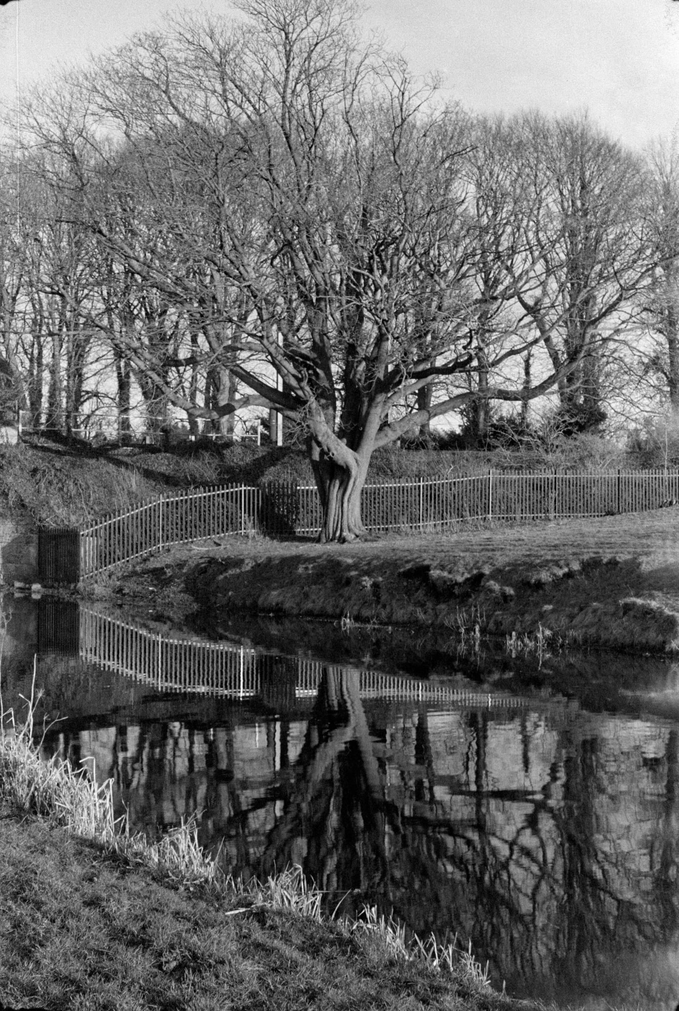

I tried over developing a strip straight off the roll, but no joy. As for it improving, I think you're right. The first few rolls were ok but nothing like the attached reflection shot. I got 80ft of this stuff for £20. I thought it would be good for camera testing rather than using fresh film. By the looks of it I got a bargain. This film btw was shot on a 1957 Samoca 35LE. It cost me £7 and works a treat. Many a good tune etc.
