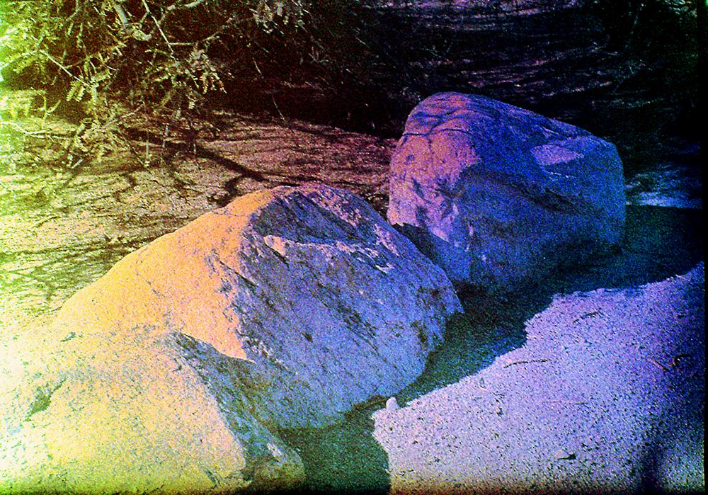

A bit of a left field post. A lot of us look to experiment and save money by buying film in bulk. I recently bought a 250ft roll of 70mm VNF (video news film) transparency and I am slitting it down to 120 and retaping on reused backing paper. I processed a roll in Rodinal 1:100 for 90mins semi-stand for FD, then a vinegar/water stop bath & a rinse then gave the reel a couple of strobe pops in lieu of a chemical reversal. The I used home brewed ECN-II chems for the color leg of the journey.
My initial results were a bit of a color spectral shift I'm attributing to uneven light distribution when I popped the flash into the tank with the rolled up film. The issue I'm having is that unrolling the film and giving it even exposure seems to be too much as I get very dense dark blue slides that are damn near bullet-proof.
Is there a "magic bean" of the right intensity & duration of exposure that I'm missing for the "poor mans" reversal?

Here in america the "anti-gubmint" folks still cling to the incandescent bulbs. Some see the pricing of CFL's and LEDs as exhorbitant without factoring in the energy savings on the power bill long term. The standard incandescents are still widely sold. The strobe I used was my big Sunpak 544 bracket mounted flash with a GN of 140 as I recall it's rating. The sample posted was from 2-3 blasts from the top of the tank on one side. Rudeofus might be onto something in using a dinky hot-shoe flash with less output.. Unreeling the film and giving it muliple pops with the Sunpack yielded the bullet-proof blues as with this sample here.

There are some very odd streaks at the bottom of your test image. Is this a processing artefact or just from poor conversion to digital?
Process artifact. I use 70mm perforated film slit down 1 edge to 120. I used rodinal 1:100 semi-stand and I suspect this is bromide drag from the sprockets on one side. Looks like it needs more frequent agitation. I did not get this using similar 70mm Portra160 in home made C41 chems. On this shot I do see a bit of uneven asphalt color -this film expired in '92

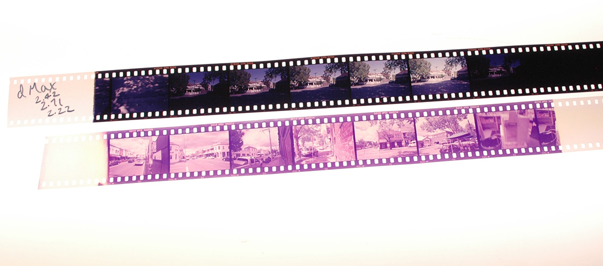

2nd attempt--dektol 1:5 7mins at 102f for the FD, 2 pops with a lesser canon speedlite flash then my ECN-II juice. some magenta mottle on the one edge but a somewhat believeable transparency--a bit on the thin side but at least it's not quite from Mars like my first attempt--just need to adjust my chem times (I can only improve from here LOL)

When you test your reversal bath or light technique, always make sure you compare your results against a proper light exposure. I've thrown out many reversal bath recipes after comparing their Dmax against a real and proper light reexposure ...
There is absolutely no point in adjusting CD chemistry until your reexposure technique matches the results of the original procedure.

I see what you're saying--verify the outcome of the re-exposure reversal so I know it's not a fluke before jumping to making more changes then end up being "lost in space" from inconsistent results changing too much stuff at once
