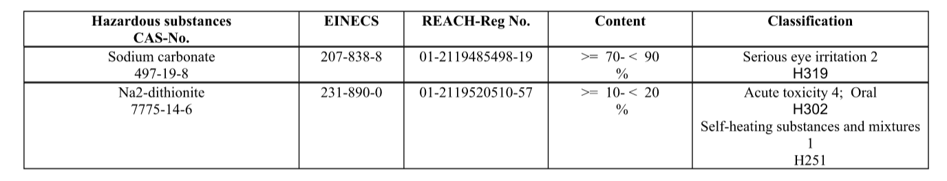

What are the ingredients of this dye remover other than dithionite? And did you add carbonate to it?
I had been unable to find an MSDS for it and so I wrote to them this weekend asking for it. I got this this morning. It turns out that it has sodium carbonate already in it. Here are the only items on the MSDS:
That's less dithionite than I would have expected. Iron Out contains 15-40%.

Very interesting that you found a product with carbonate and dithionite. Raising the pH is what I'd recommend to reduce the brown cast and increase overall speed. Note that dithionite will naturally decay to metabisulfite even as a powder in a process that's near impossible to prevent. (there's some patents to keep dithionite stable at freezing temperatures for "up to 1 week", but that's it). Luckily dithionite in excess doesn't have any ill effects though, but carbonate in a second developer might (excessive swelling). Also the dithionite being stored along with carbonate and not metabisulfite might make it's keeping properties as a solution worse, meaning you might only have 5% or less in this product.
There's been very little research I could find about second developers using dithionite, likely due to these troublesome keeping properties. Regardless, I've done some research. Dithionite will primarily behave as a fogging agent at acidic pH and will behave as both a fogging and developing agent at neutral to alkali pH. I imagine if you increase the pH to a workable level (say balanced between 9 and 11 using baking soda and carbonate), you could introduce a superadditive developer, such as phenidone. The ultimate solution of course is to use a 2 bath second developer. First the dithionite solution at neutral pH which will fog the film faster than develop it. And then using a paper developer to get a neutral tone once it is fogged. I believe that the brown tone from dithionite may be due to surface-only development, which indicates another agent used in conjunction could do the chemical style development which would eliminate this effect, or maybe even just a very small amount of silver solvent such as thiocyanate or thiosulfate to allow dithionite to penetrate the grains
This is really good info. The product is a powder rather than a liquid, probably for the reasons you describe. It's meant to be used in one batch, which means there is every possibility that the dithionite is not evenly mixed with the carbonate. It's not powder, though, and it doesn't look like the sodium carbonate crystals that I have. It's sort of uneven, very small chunks. Possibly both carbonate and dithionite crystallized together? I don't even know if that's possible. I used a really small amount for the test on a small cut of film, maybe not enough to get the pH up high enough. I'll use some pH paper to figure out what the pH is next time.
