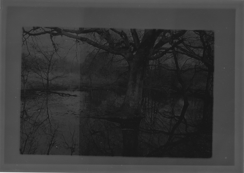

I was given a couple of boxes of Agfa multicontrast RC paper that it turns out is badly fogged.
I tried a test strip first, and it looked like this:

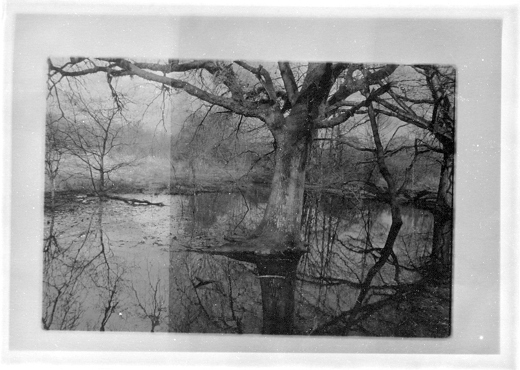

For the heck of it, I decided to see whether I could pull anything useful out of the scan of that first test strip.
This is what I ended up with:

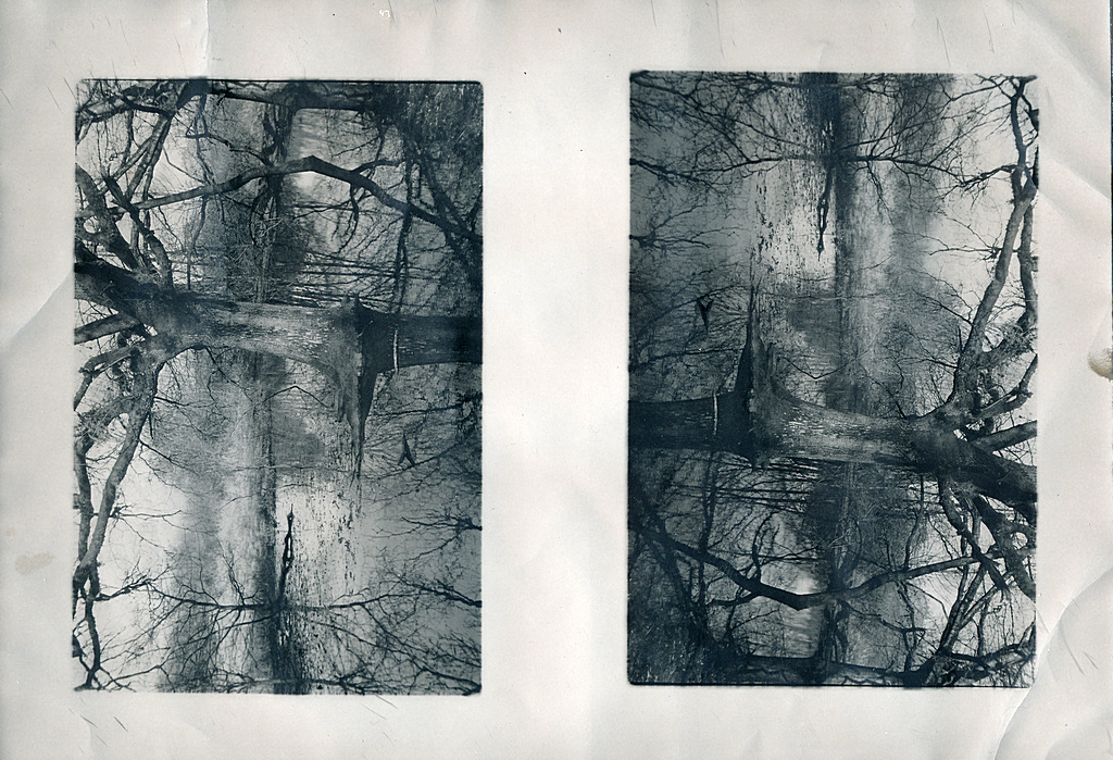

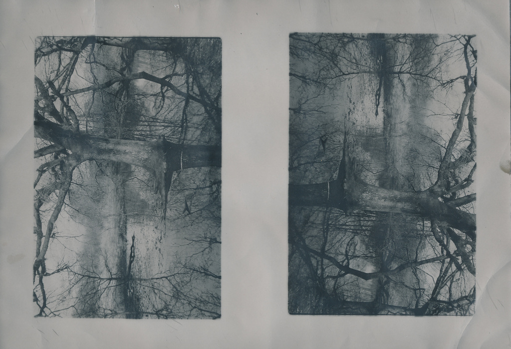

Here is some similar results obtained from some heavily fogged, single weight fibre based Forte paper.
Original scan of the print:
Digitally tweaked version of the print scan:
Apologies for the creases and the dust. The creases are there because I didn't put the requisite care into handling the FB prints, and the dust is there because it is a scan with contrast enhanced!
