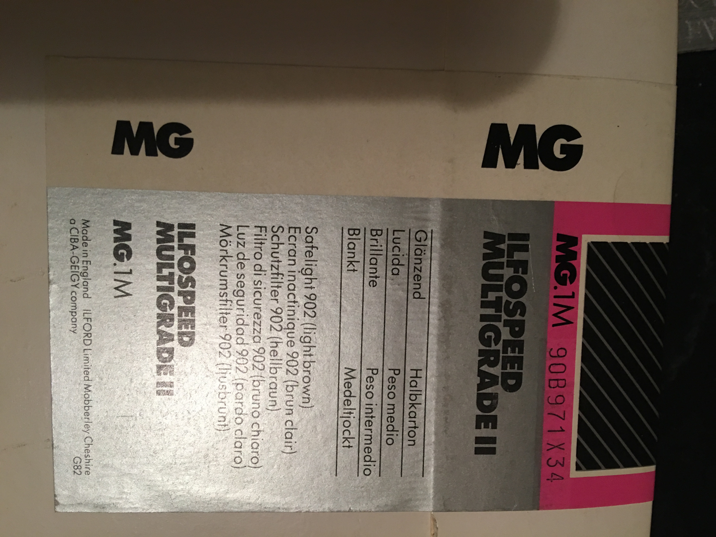

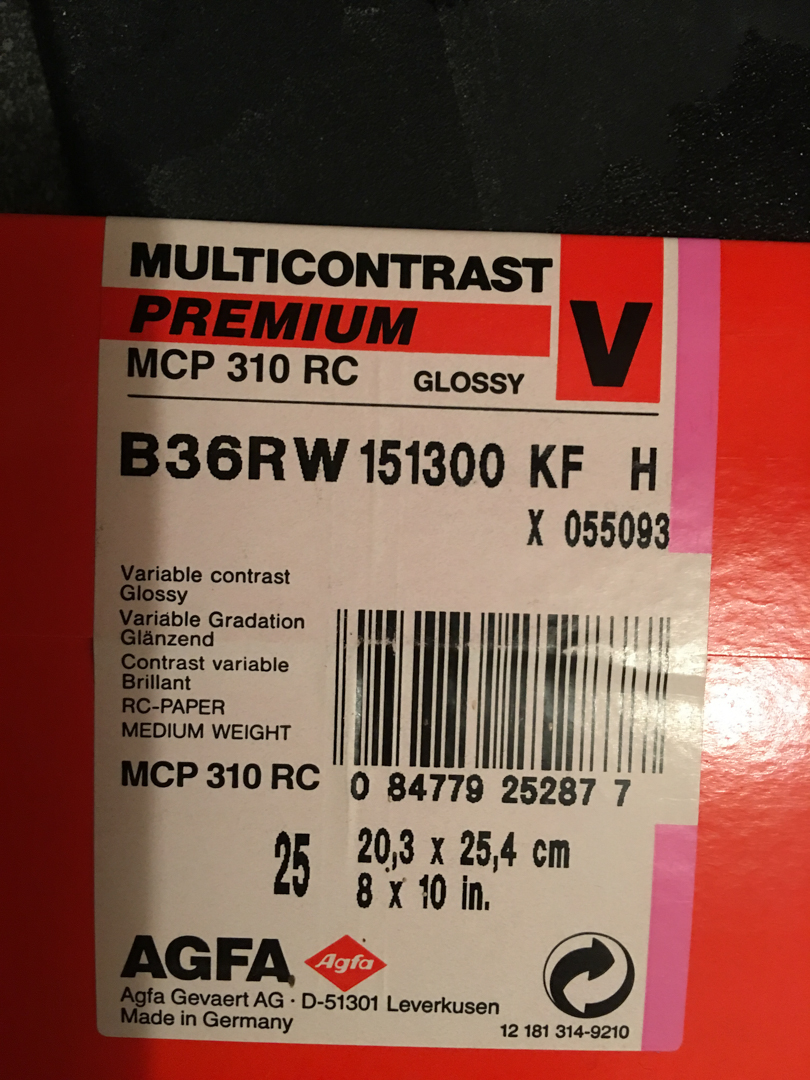

What type of paper is it? Can you post a photo of the back/wrap around label, with all the technical stuff on it?
If it is old enough, it could even be developer incorporated paper designed for activation processing. If so, it has been trying to develop itself since it was manufactured.
There you go.

There you go.
That Ilford paper is Multigrade II, which was replaced by Multigrade III in 1990. So it is at least 30 years old.

Thanks Kirth. The pictures explain it all. It is Agfa paper not Adox and even if it is the last run of paper before Agfa closed then it is, I think, at least 14-15 years old. Matt has covered it all on the Ilford paper:D
I understand why you may not want to say who the supplier is but I suspect he has obtained from somewhere a stock of quite old Agfa paper and really ancient Ilford MGII though where it has been sitting for over 30 years is anybody's guess. Unless he has more recent paper to replace it with then unfortunately there is every reason to believe that all the Ilford MGII will be completely "shot" and unless the Agfa paper he sent originally was from a much earlier run than just before Agfa closed and he has stuff that is from the last run of Agfa paper then it may be difficult or impossible to restore any contrast in it

As it is clearly seen, that is not ADOX paper, but former Agfa paper. Agfa did their last coating runs of BW paper in 2005. But your box is definitely even older, because the last boxes produced in 2005 had a different labelling. Your box has an older label and therefore must be older than 15 years. The age and maybe in addition even problematic storage conditions have resulted in a quality loss.
And as MattKing correctly said, Multigrade II is from the 80ies. So even older than the Agfa MCP, which was introduced in the mid 90ies.
