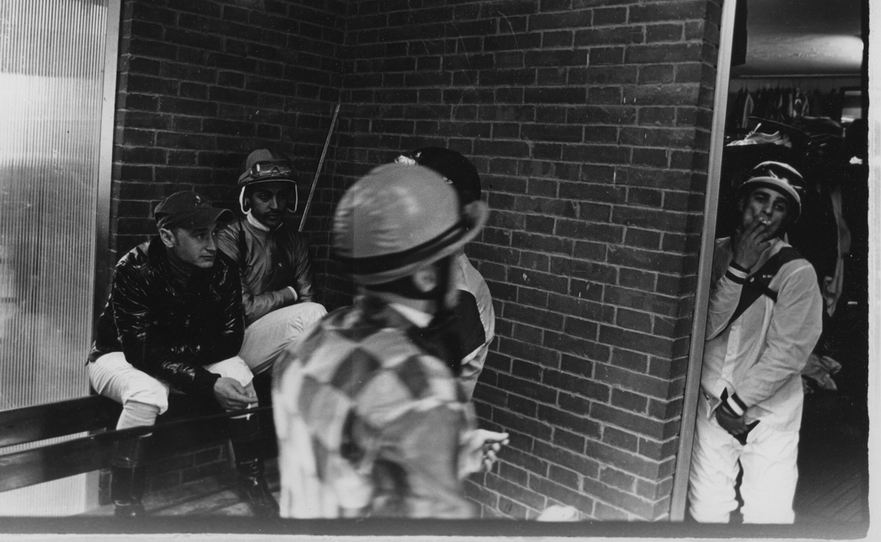

I guess I will scan an example for you all 'cause it's not that easy to describe the issue by words...the side affected is, how I can say, much more faded and pale than the rest of the print. ...it seems like had less developer agent than the right part but the developer is certainly good and I developed by tray using a bigger amount than usual (just to be sure)...
more later with an example scan.
thanx for now guys
Here is the mistery issue image! cropped but the up and left borders are ok.... your ideas are welcome...
Did you develop a blank sheet in the dark yet?
Fogged paper is darker than unfogged paper - not lighter.
Your problem is elsewhere.
I'd check the light path in the enlarger.
Sounds stupid I know but you have checked that the neg is OK and the print isn't simply replicating the fault on the neg. if there is any chance that the neg may be at fault then try another neg which you know to print well and see what happens.
pentaxuser
thomas: not yet unfortunately...my darkroom is not at home.
pentaxuser: unfortunately the neg is ok, great density and very good grain even if it's 800 asa tri-x and no fog obviously.
I must add that lastly I made a lot of E6 and ilfochrome printing...what about fumes breaking the paper layers? I guess I must use this paper just for testing printing exposures and buy some new... :sad:
Based on how the prints look, and assuming that the negatives are OK, it's either your paper or the enlarger. It would make sense to try a different box of fresh paper. If you still get the same problem, you know where the problem lies.
The "light" areas are a bit strange, It is almost like the ppaer has become desensitised. Be interesting to cut a strip from the side where you have the effect and give it an exposure with no negative - followed by normal developing. If the area is still Light, then you can perhaps salvage some value by just cutting off the damaged edges and using the rest of the sheet.

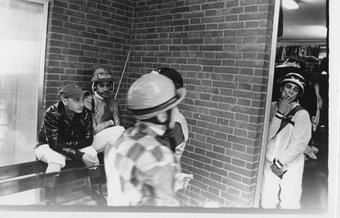

I made the unexposed paper test and the sheet came out completely WHITE!! So, IT'S NOT FOGGED...I didn't make the BTZ addition 'cause it's useless I guess. I checked glass in the carrier, clean! I checked the dichroic head and nothing wrong apparently.... :sad:
I tried another pack of paper (2 years old kentmere vc, do not look at the darker shadows 'cause I didn't tune the exposure for a different paper) this time and the effect is much less evident; considering I'm printing ONLY ILFOCHROME in the last 2 years there must be something about bleach and ilfochrome chemicals, otherwise it's REALLY A MISTERY :sad:

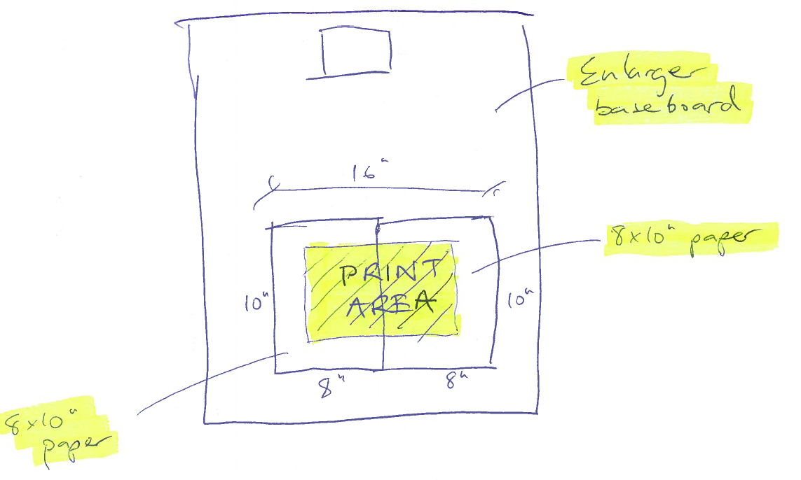

Thanks for making the print to give us a view of your problem. It seems that you have some issues that can be hard to diagnose.
My recommendation:
1. Focus your enlarger on the enlarger base board. Do not use an easel.
2. Take TWO pieces of paper and place them side by side. (If you use 8x10" paper, you get 16x10" from both).
3. Print on BOTH pieces of paper during the same exposure, so that the enlarger exposure is exposing both pieces of paper at the same time.
4. Develop both pieces of paper at the same time.
If the problem you are seeing is still in the same place, at the bottom of the picture, you know the paper is fine, and it's likely a film developing problem or an enlarger setup issue.
If the same 'edges' of the two pieces of paper are still unevenly developed, it is definitely the paper. See attachment.

Oh my god Thomas, what the hell brilliant and same time simple idea !! thanx so much :smile: I will try for sure and let you know!!
I had some paper come out like that, turns out it was a bad emulsion on about 4 8x10 sheets in a row, but the rest of the paper was good. It looks like the bottom part isn't burning in, so I would guess bad emulsion or uneven light source. It's best just to tackle it one step at a time and test everything until you find the source. Best to start with the paper though and test it.
