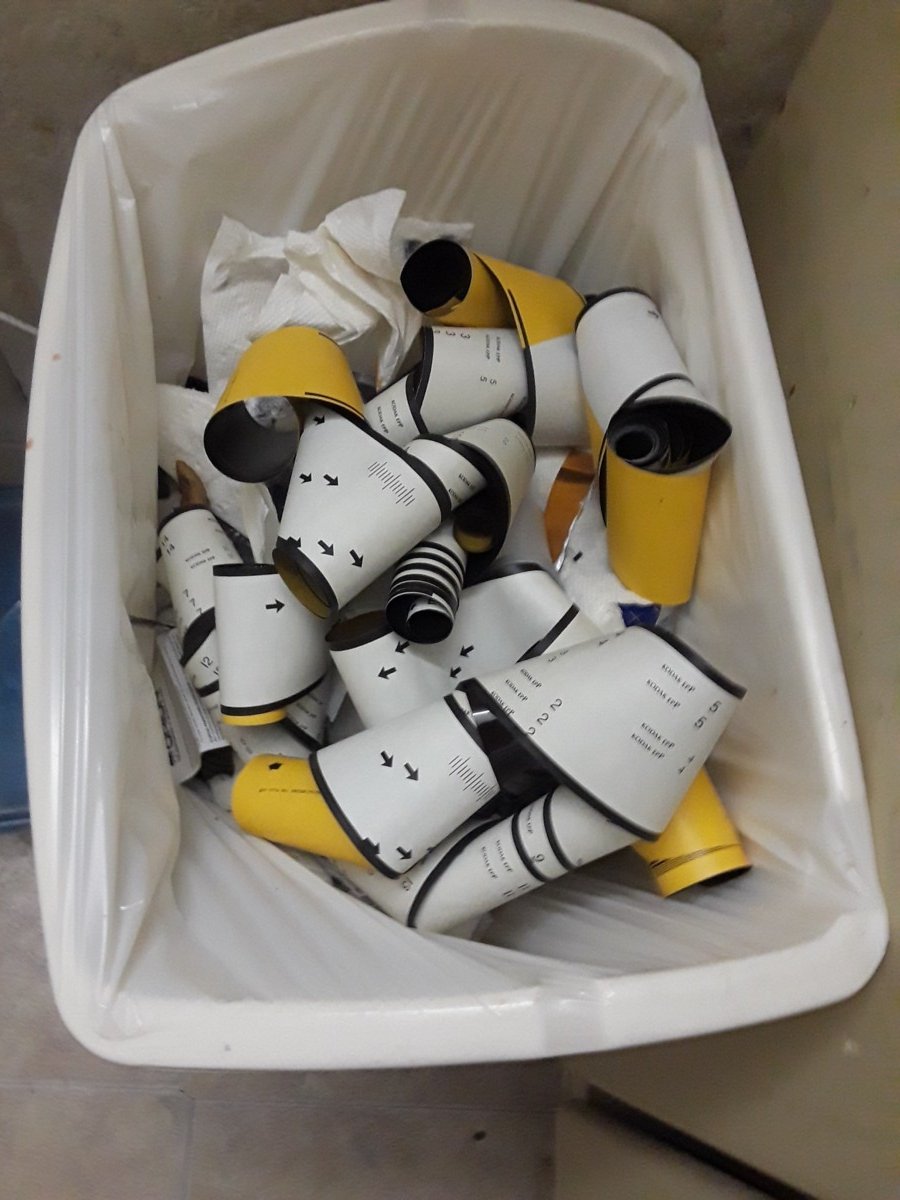

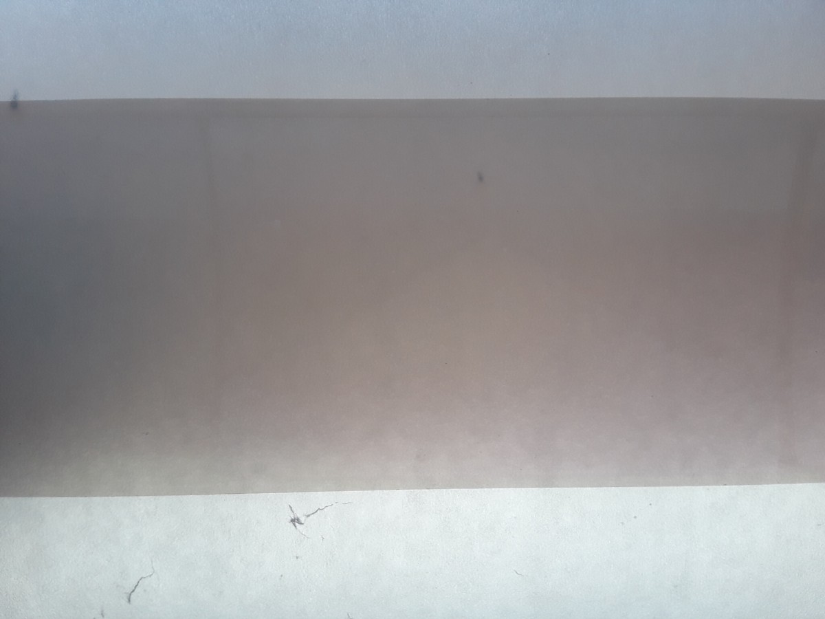

I had bought ten rolls of "cold stored" Ektachrome 120 a while back from a major supplier. Since I can't find the receipt to verify it, I won't name names.
I took one of the rolls to the Comanche National Grasslands. The snakes, scorpions, heat, and especially the bugs were all tempered by the thought of those big, beautiful 6x9 images from the Bessa. This was the first roll I developed, and to say it was a disappointment is an understatement.
The film must have been hit with massive X-rays. The whole roll is fogged. There is just a faint ghost of the image and the framelines. So now I have nine (quite expensive) rolls that may or may not be any good. My thoughts are to respool it for 620, and in the process snip a half inch or so off the end as a test strip. Is there any way to determine if the film is good without doing a complete development of each strip?
BTW, the next roll of Provia came out fine.

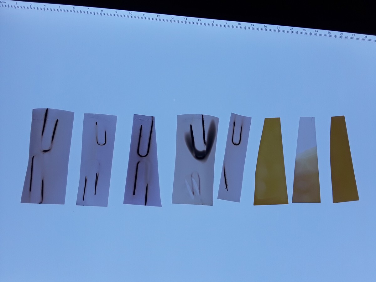

Since the original post engender so much interest, I figured folks were anxiously awaiting an update. In case anyone was wondering, batches of film do get exposed to massive X-ray doses on occasion; 10 out of 10 rolls were ruined.
For the first ones I put a loop of thread around the light baffle and hung a paper clip from that. By the last three strips I had lost enthusiasm and just tossed them all in to the tank. They didn't get fully developed, but enough to show they were ruined.

It would be most unusual for any chromogenic film to have all of the dye couplers not only degrade completely, but to all do it at the same rate. There is an active thread here now for Velvia expired 18 year and it looks pretty much like new film.
This issue was certainly not caused by age. In addition to the Bessa I had my OM-4T loaded with Ektachrome that is at least ten years old. This film came out fine. Some frames were under exposed by about 1/2 stop, but I suspect that had more to do with the midsummer sun on the high plains desert than anything to do with the film.
I also tested samples of the 120 to verify that it was fogging and not some other issue related to the dye couplers. These samples were run thru just the color developer and the blix. The dyes all developed and rendered the yellow/brown, nearly opaque look as expected.
It would be interesting to know if anyone has ever seen this sort of complete degradation caused by any combination of age and storage conditions. But the one thing that will certainly do it is a massive blast of x-rays.
