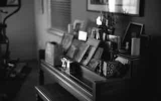

Inclosed is a picture of our piano. I focused on the small box with looks like tree illustration on it. As you can see, this image is completely out of focus. Shot 125 F2.8. It act as if it focuses backwards.

I had to adjust every one of my rangefinders after purchase. Even if it appears infinity is on it may not be. I don't own a Leica but I would assume they have vertical and horizontal adjustments. I use a tripod to make sure there is no movement when I check. Infinity should be checked at a very far distance, not a block. I'm using tree tops about 1/3rd of a mile away to be sure. I'm sure there is some mathematical formula to derive the minimum infinity distance from base length but it was just easier to look as far away as possible than to try to calculate. It made a difference from using a point that was 60 or 70 meters away, at least on my Canon 7. Not sure about the base length on the Leicas. Then check some closer distances 10 meters, 3 meters 1 meter and adjust as necessary. Make sure you are measuring from the film plane.
To QC your infinity; set up your camera with lens mounted and the back off so that you can lock the shutter open and see through the lens and camera out the back. Place scotch tape or a piece of film at the film plane so that it is exactly where the exposed film would be during a shot. Place a mark on the tape or film at the center of the frame with a marker, an x will do. Make sure your Leica lens aperture is wide open and is set to infinity. Now with another large aperture long lens on an SLR set it at infinity with aperture wide open. Using the SLR viewfinder look through the front of the Leica lens to see the x you marked at the film plane. With everything set up correctly, the x should be sharp. If it is not either your setup is wrong or there is a problem with the lens / mount. If there is a problem you would have to identify why and correct it. I can adjust lenses on my Argus's to correct infinity offset issues. Not sure about m-mounts. I do have an Argus lens that was re-assembled wrong at some point in it's life and will not check out at infinity. Trying to figure out what was wrong was how I learned to do all this....

f16 probably masked the error in focus. If focus if little of - you will not see it on f16, only wide open and on close focus subject, where shallow depth of field if more visible.
Good thing is that body looks to be ok, when it is focusing good with 90mm lens.
