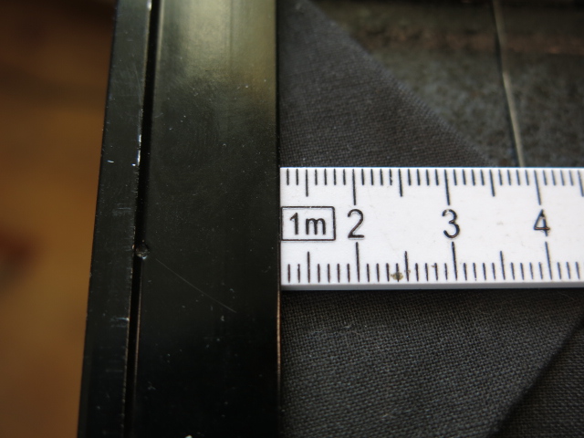

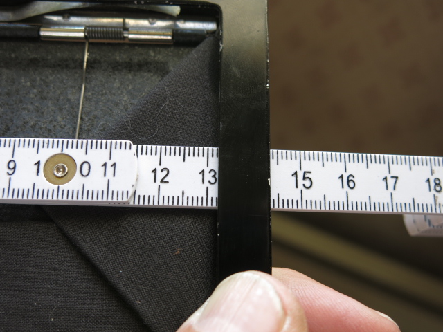

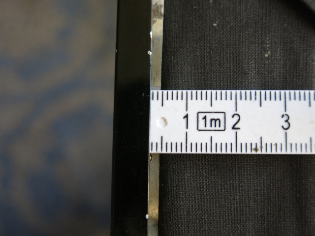

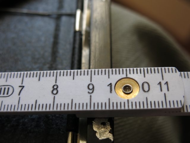

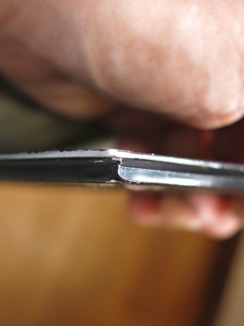

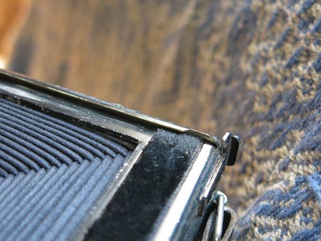

I have a screen holder for Avus 9x12 with a broken glass. To order a new ground glass, I put some details here that may be of general interest.
The holder and the slot:

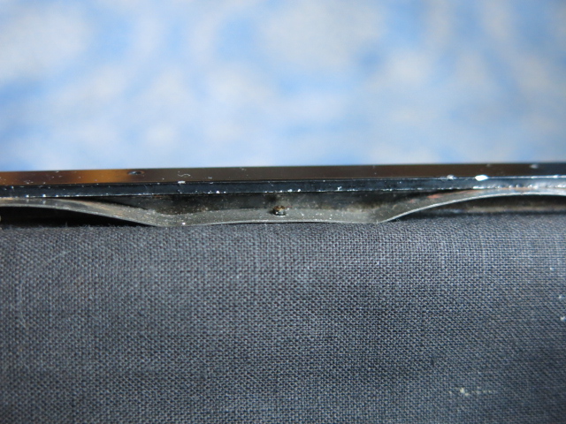

Spring pressing the ground glass in the frame. The pin in the middle clears the frame with 2mm:
Max possible width of the ground glass is 92mm:

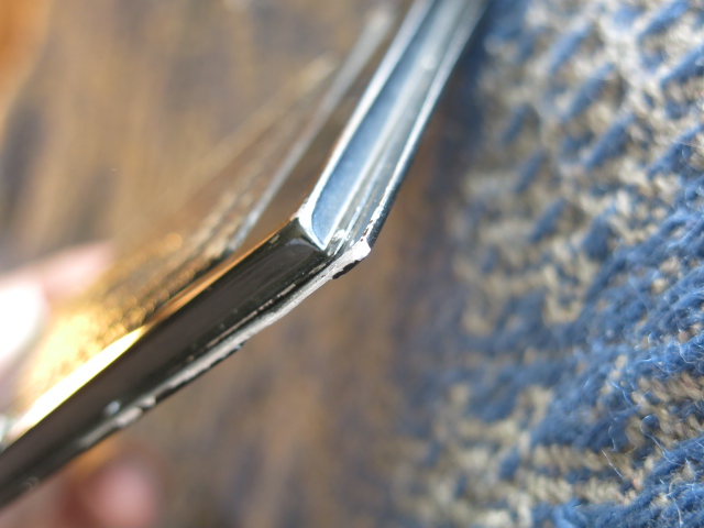

Top of the holder and bottom, where the slot is:
Slot is 1.5mm:

(The reason I was able to put the ruler into the slot at the bottom of the holder, is that some previous owner had broken one edge up. Probably to replace a broken glass plate. He can not have seen the slot at the bottom of the holder.)
