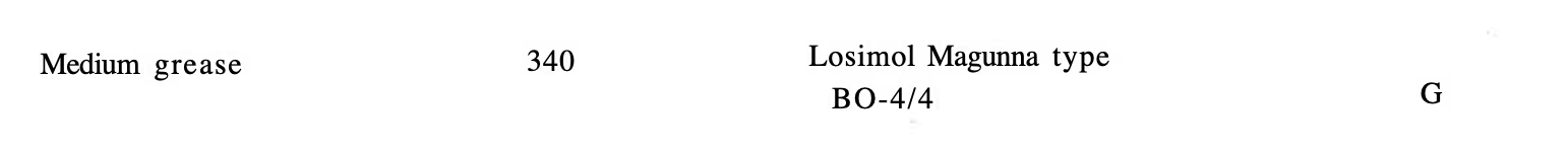

The lens needs to be serviced; the helicoid needs to be re-lubricated. Always the risk that there are other issues too. The amount of torque on the focus ring is not something random. For example the following is recommended in the M2 service manual:
