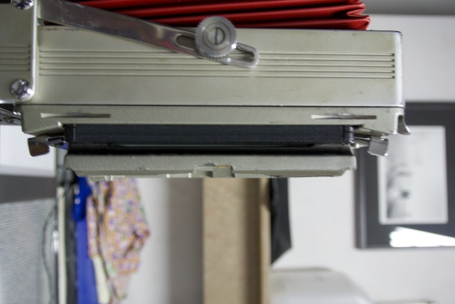

Some images
I use Fidelity Elite film holders

Oeps, there is apparently 1.5mm difference between the film plane
and the ground glass !

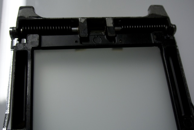

To other graflex graphic view owners, is there something between the ground glass
and the metal to which it is pressed ?
I do not understand this difference
Ian Grant
Aug 2, 2004
23,273
West Midland
Probably a fresnel screen. Many (but not all) later Graflex cameras came with one fitted.
If the focus frame was made to have one on the inside removal puts the focus out of register.
Ian

I did some measurement wirh a calliper and got a difference from 1,5mm.
I found a simple way to get the groundglass rearward by this distance, did some
new tests and focus is now ok
David A. Goldfarb
Sep 7, 2002
19,974
Honolulu, HI
1.5mm is about what a fresnel is typically, so that sounds right to me as well. You can just shim it until you find the right fresnel.
