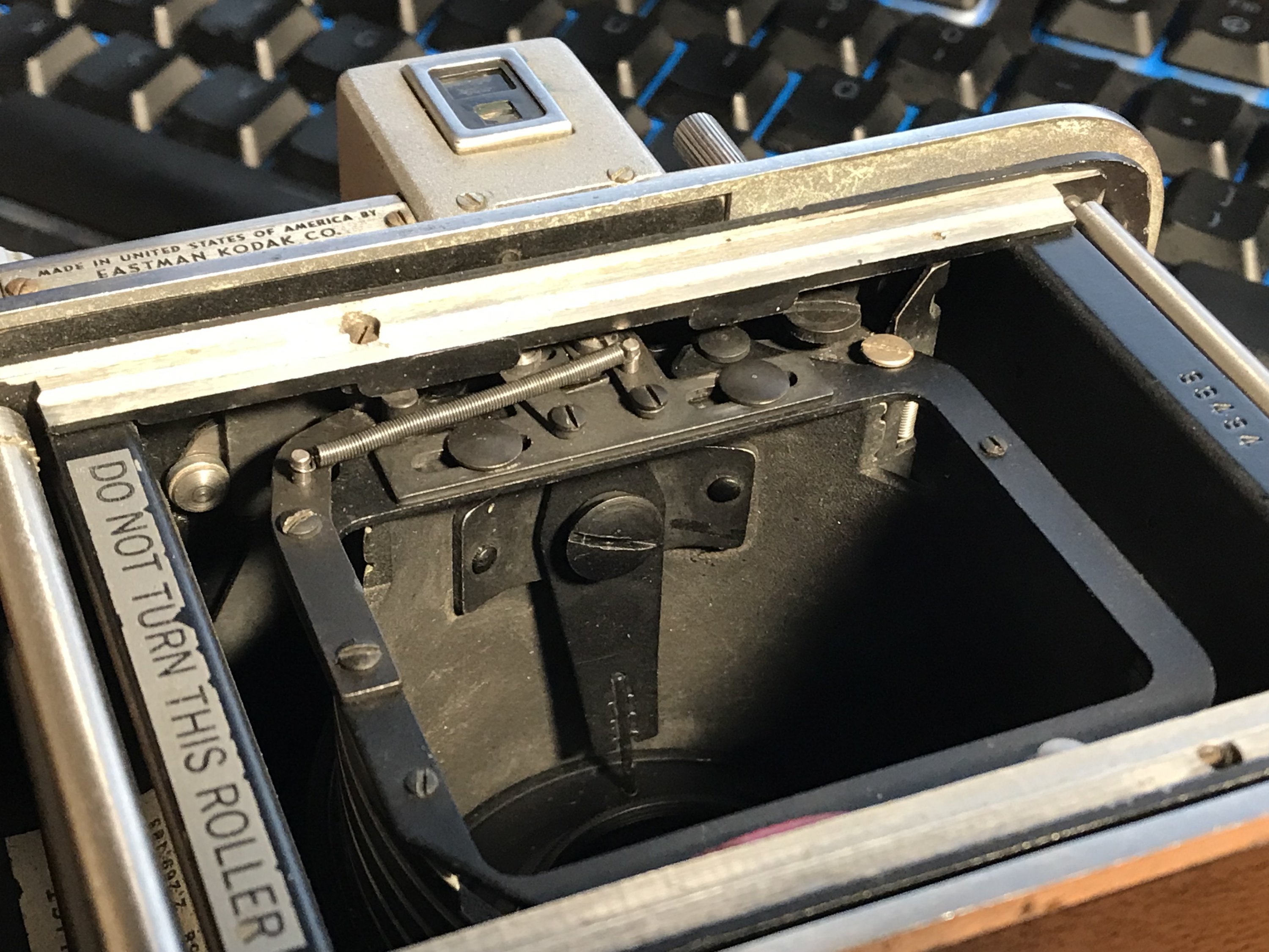

If you can post a photo of the interior top, do so- show the top of the lens tube, the two metals tabs at the top center, and light it so that we can see the parts above those tabs. I wonder if the main plate is jammed onto one of the tabs making the lens tube unmovable.

Dan, let me know if this picture shows the parts you were asking about!

At 11:00 o'clock above the spring there is a rod that the assly slides on. Put a little oil or lighter fluid and see if that frees it up any. You can also put some on the left and right side of the assly where you see the chrome focus screw meets the black metal.

OK, next to the 'DO' in do not turn sticker upper left side there, there's a silver disk inside the camera. And touching up against it to the right is a black metal part. This is what I was wondering- that black metal part could get jammed and stop the lens tube from moving. But sitting as it is, up against the silver disk, tells me that it is resting where it should. See if the black metal part will slide to the right. There should be a little travel. If not, that is probably the problem, but it is probably jammed up at the front right-center area, hard to get to from here.
See if the plate at the top of the lens tube will slide to the right- it has a spring attached to the middle. Also you can do some simple tests on the shutter. Try cocking it using the lever under the viewfinder- you'll see that long metal part that end in a rod and goes into the back of the shutter move to the left. Take a screwdriver and push that rod to the right- push at the back of the shutter. Medium force.

The black metal part slides, the shutter lever under the view finder engages with the plate at the top of the lens tube and feels like it wants to cock the shutter, but it's a little tight.

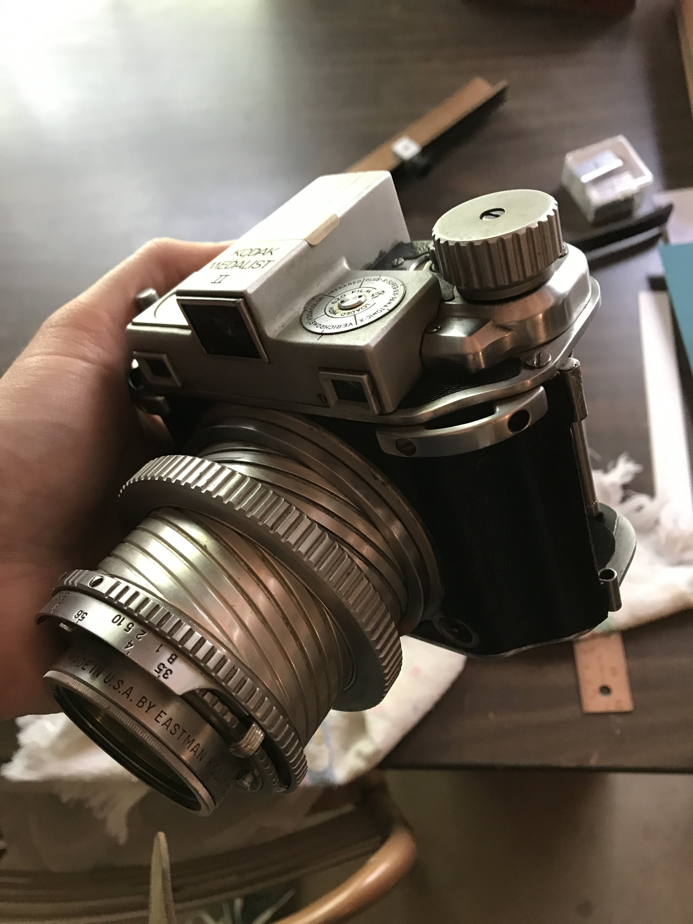

The answer seems to have been a spot of solvent and a strap wrench for mechanical advantage! So the lens extends now (and I cleaned all the gunk off), but it doesn’t seem to be coupled to the range-finder/distance gauge. But the shutter works, which is a plus!

Like I said earlier, this camera has to be worked in its sequence and a strap wrench is not in its sequence. I really doubt that the dirty focusing helicoids were stopping the tube from extending. These cameras were made for the military(Marines and sailors), which means they could take being plenty dirty and still work. I'd be willing to bet a six pack your camera was jammed somewhere in its sequence. Most likely the focusing rail inside the camera itself. Now you have no rangefinder and worst of all you have no focus disc for even scale focusing. If you are real lucking you only bent a part in the sequence and not completely destroyed it. This is one of the best cameras ever made and it's a shame to destroy it for lack of patients and lack of the proper repair manual. Actually it's not just a shame, but a sin. Please get the repair manual off eBay, it's well worth the waiting time and money. One thing this post did was make me get my three Medalist's out and play with them. Last night I respooled three rolls of 120 to 620 spools, two HP5+ and one of Delta 100. I leave for my cottage this afternoon and my favorite film camera is going with me. Good luck, JohnW

I rather well thought it was something "under the hood" rather than stuck helicals. Now the rangefinder doesn't work. i'm not surprised. What a shame to tear up a camera like that.

The rangefinder does work, it’s just a little gummy, I was looking through it in a dark basements and clearly not paying enough attention before trying to share my excitement in this thread!
