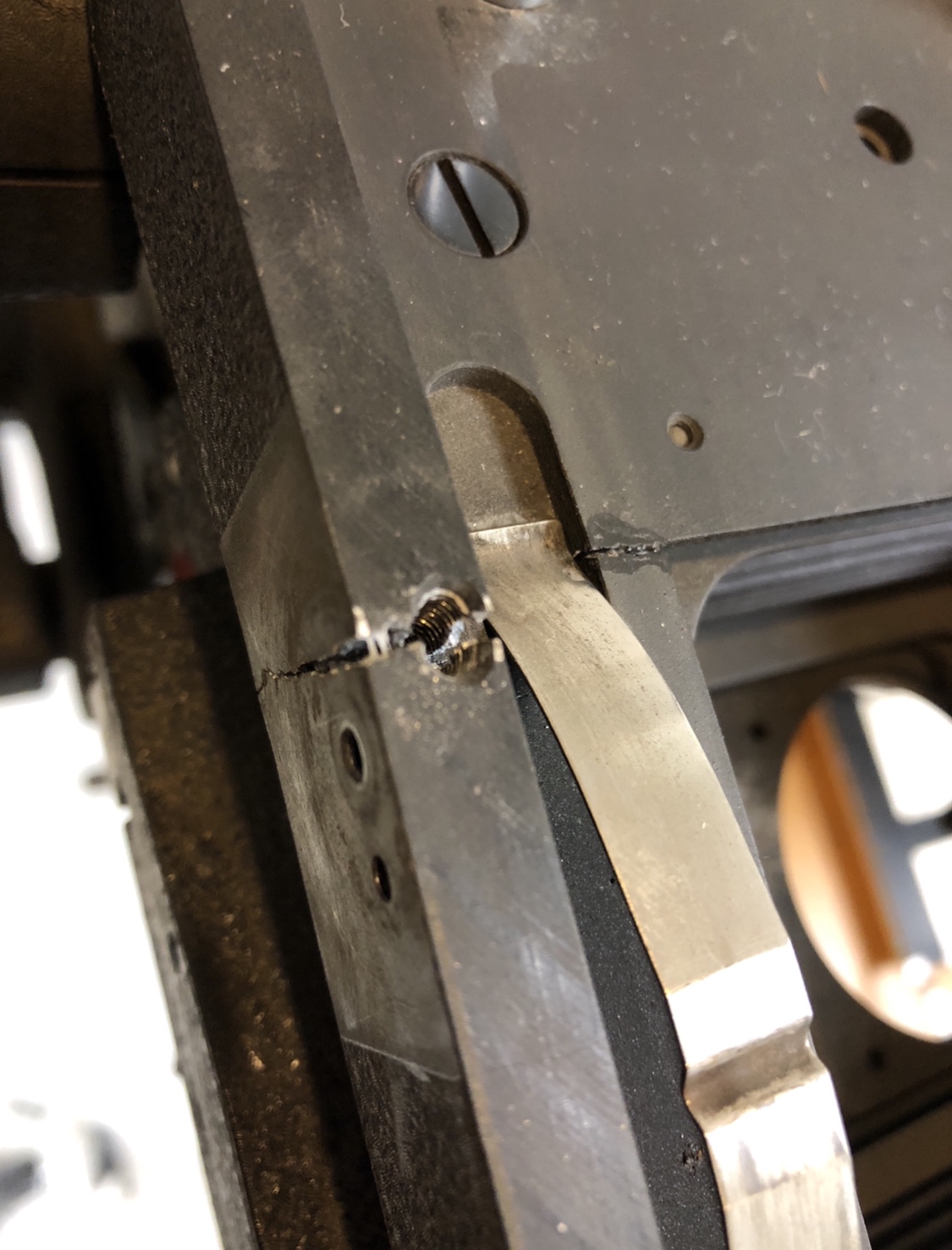

I got a IIc in the mail the other day, was going to fix it up. As I pulled the parallelogram out of the box I was immediately shocked, the negative stage is broken in half, it cracked by the 3rd screw from the front, the ones that hold the chrome piece to the negative stage which holds the negative carrier.
The crack isn’t even, it is very rough everywhere.

Please see photos of the crack below.

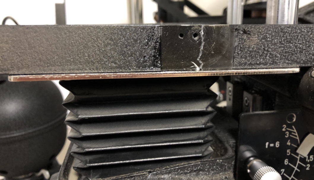

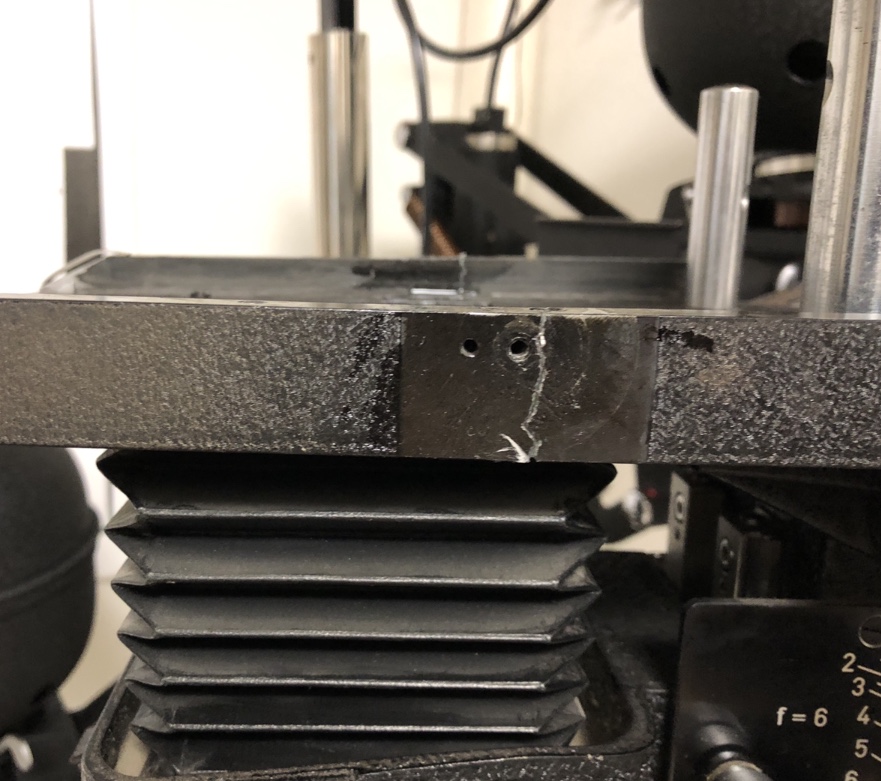

So I just couldn’t leave it the way it was and attempted a fix. Invested a hefty 15USD equivalent of Japanese yen and I think I am in good shape.

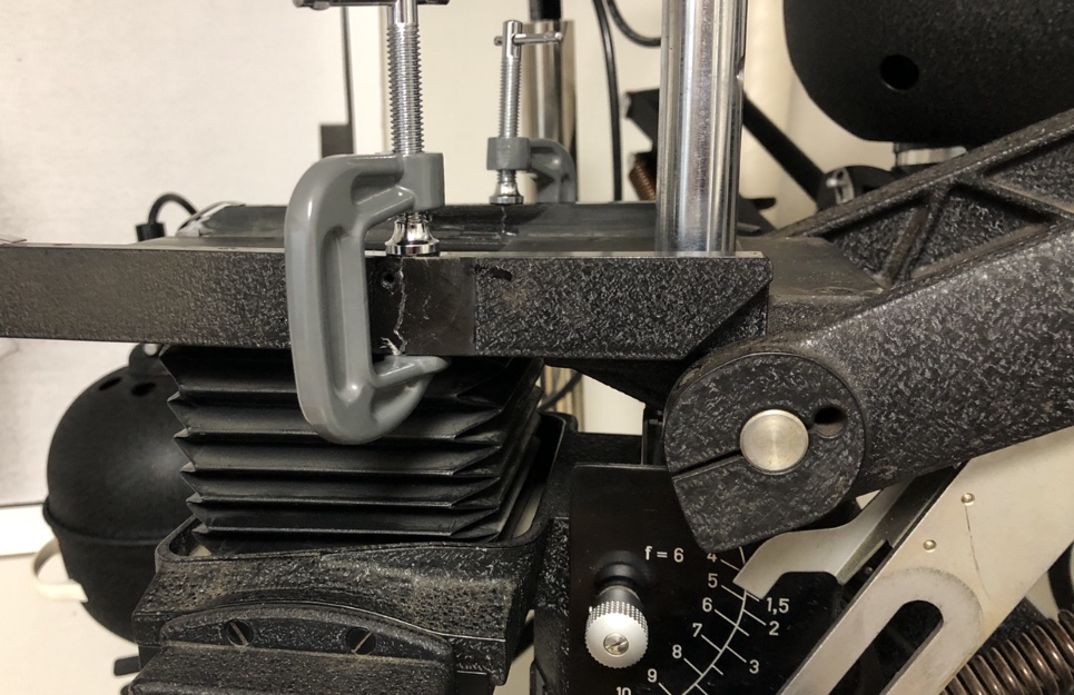

I bought two little Vice like clamps, 2 metal rails and a 2 component quick epoxy glue.
I bent the broken part down a little away from the rest just enough so I could get to the fracture and clear away the old residue. I then mixed the glue and smeared a very generous amount of it all around the cracks making sure it gets everywhere.
When done, I moved the front part back into position as best as I could eyeing it and fastened the two clamps so they would hold the entire stage in alignment. When done I used a bubble lever and saw there was a slight warp which I adjusted by force and then tightened the clamps back down again. When all was well I just left it for an hour and eventually removed the clamps. I was nearly completely sure the part will break off immediately but to my surprise it stayed in tact even after I exercised about 2-3 times the force that I would ever use when printing or adjusting the device etc. Not even the slightest hint of a movement.

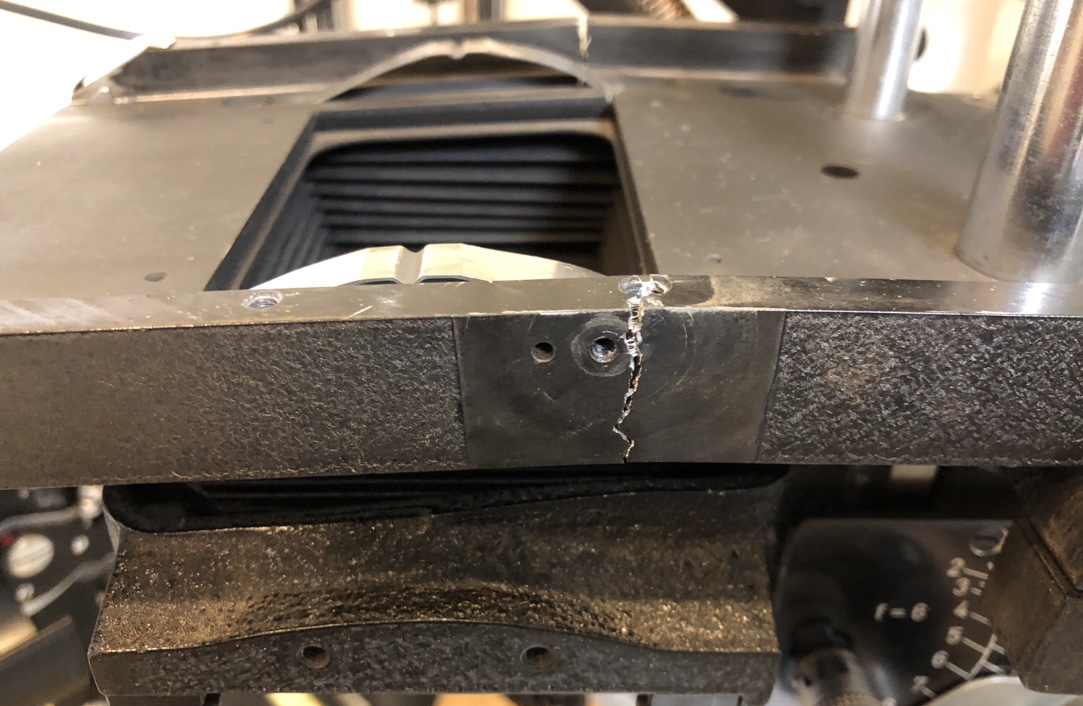

I then added the two metal rails to the bottom where the ears go and fastened them real tight.
It is good as it was as far as I can tell, which is good enough for me.
See some photos below. Since then I put all the parts back which I removed for the repair and the fracture isn’t showing even a little. The film stopper rotating arm hides it away nicely.
